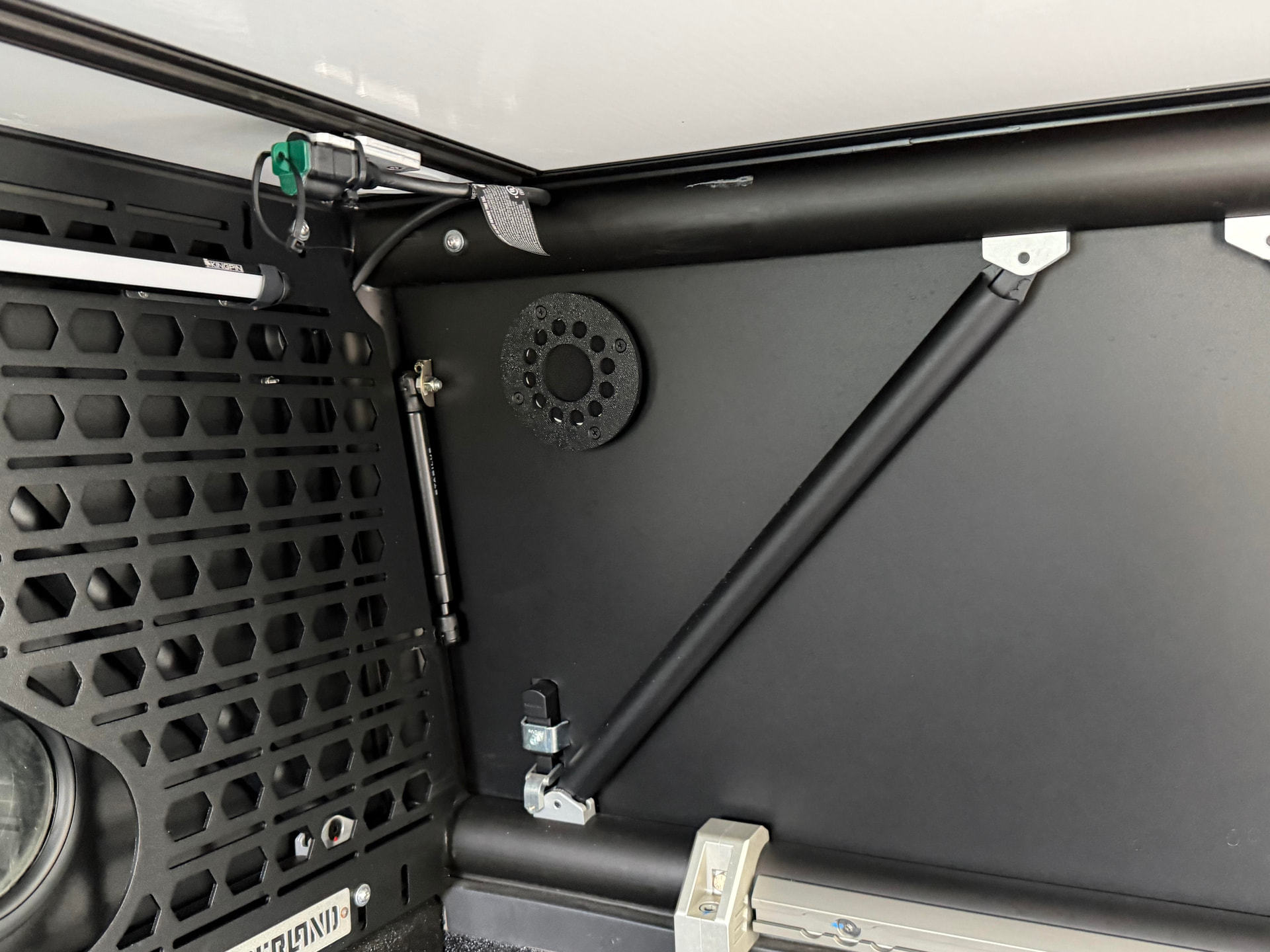

I finally finished my PPV project up and found some filter media that was the right thickness. Should be testing it out here in a couple of weeks. I think I may have said this in a previous post somewhere but this is a Bud Industries IPV-1116 air vent (currently $12 on Amazon) that’s been painted to match the GFC panel. I then drilled and tapped the plastic retention ring on it to accept this black ABS plastic filter cover that I had cut at sendcutsend.com . I’m hoping this thing at least knocks down some of the dust.
