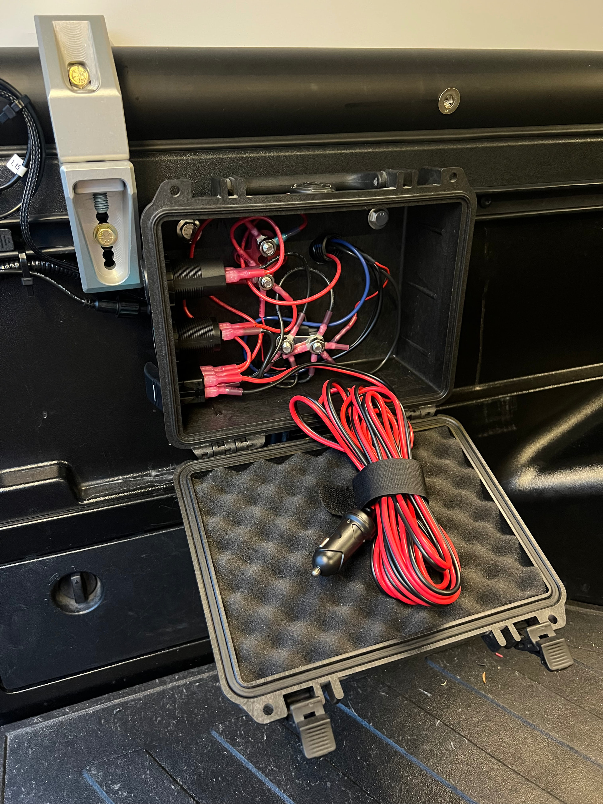

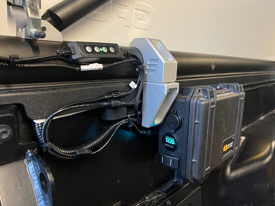

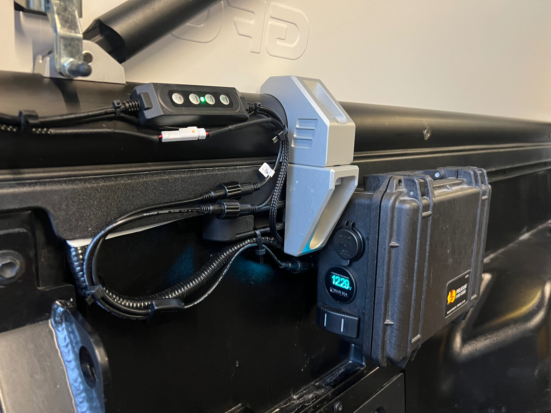

I used an old Pelican case as a junction box. I also had a Leer wiring harness so I routed that and the GFC wiring harness into the box to make connections. The dome light power wire from the Leer feeds a double pole double throw switch that lets me select between truck battery power or a 12v cigarette adapter going to a portable power station. I can’t leave well enough alone so I added a digital volt meter and some extra USB charging ports that are also selectable with the DPDT switch.

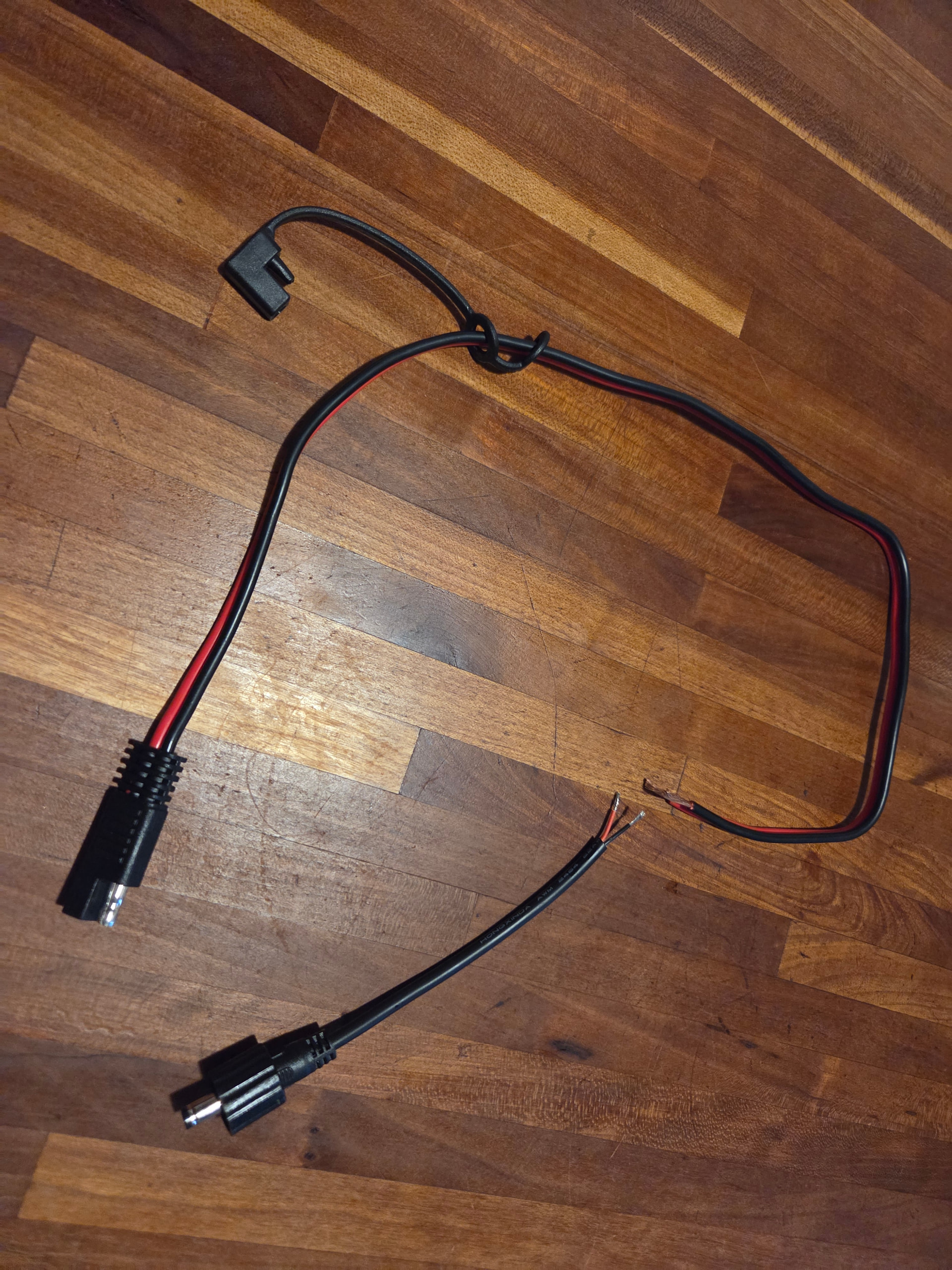

The wire gauge discrepancy between the 14 AWG connection from my Ranger to the 22 AWG on the GFC lights seems worrisome. The pic is my intended solution to have the lights available off the truck battery when not camping with the portable power pack.
Back story: I want to plug them into an existing power supply line on my truck. I’ve been using Wolf Haus Offroad power kit with no problems for my fridge. His kit had a pigtail for an additional connection that I’ve wired to an “SAE” connector. Volts at the connector at 14.5v when the truck is running - seems like a lot for the tiny wires on the lights.

Even small wires are generally rated for very high voltage. The determining factor for size is amperage relative to wire length. I think the highest draw I’ve seen on the brightest setting is about 30 watts. At 14v that’s around 2 amps. A relatively low draw, hence the small wires used.
