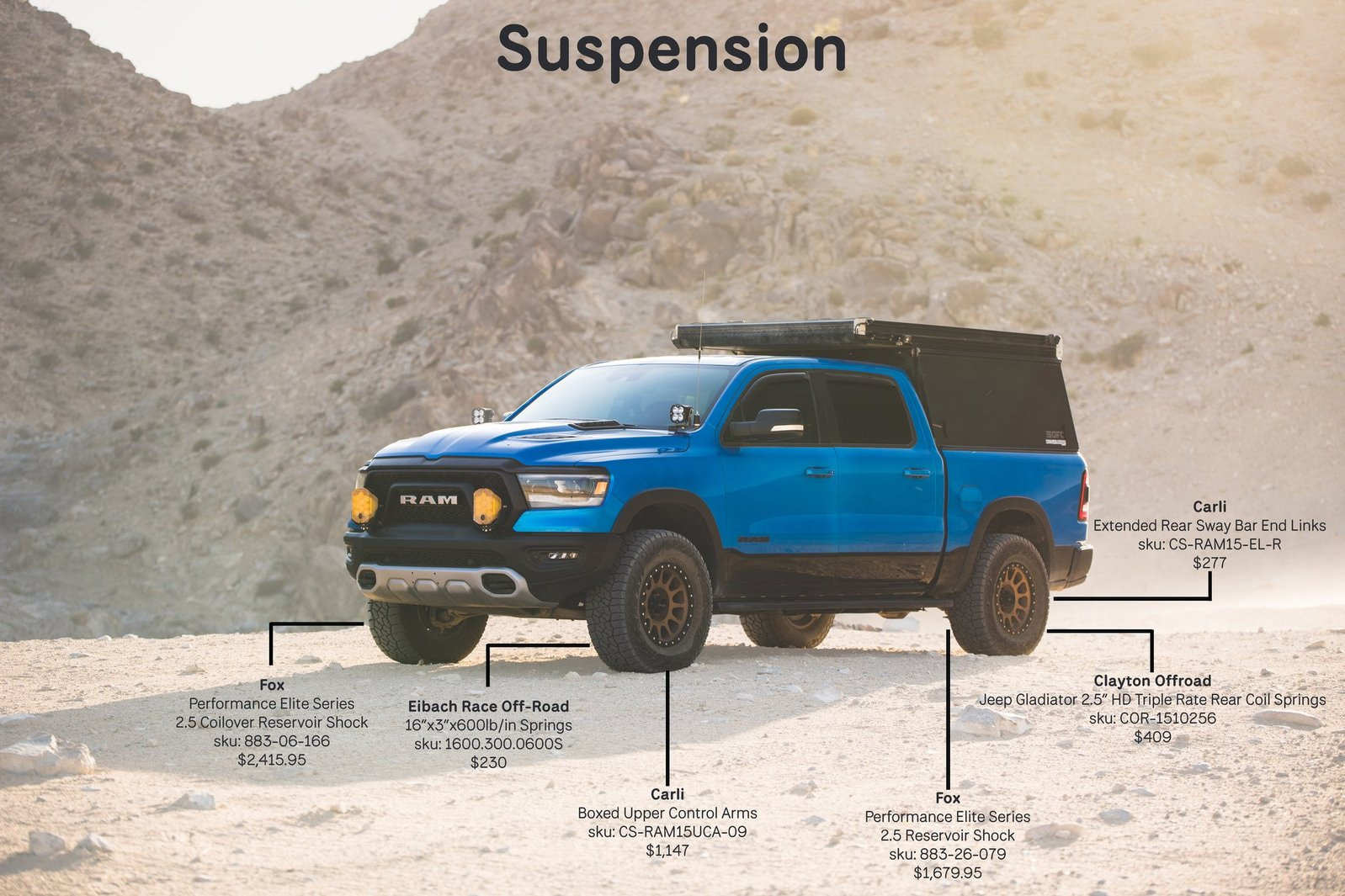

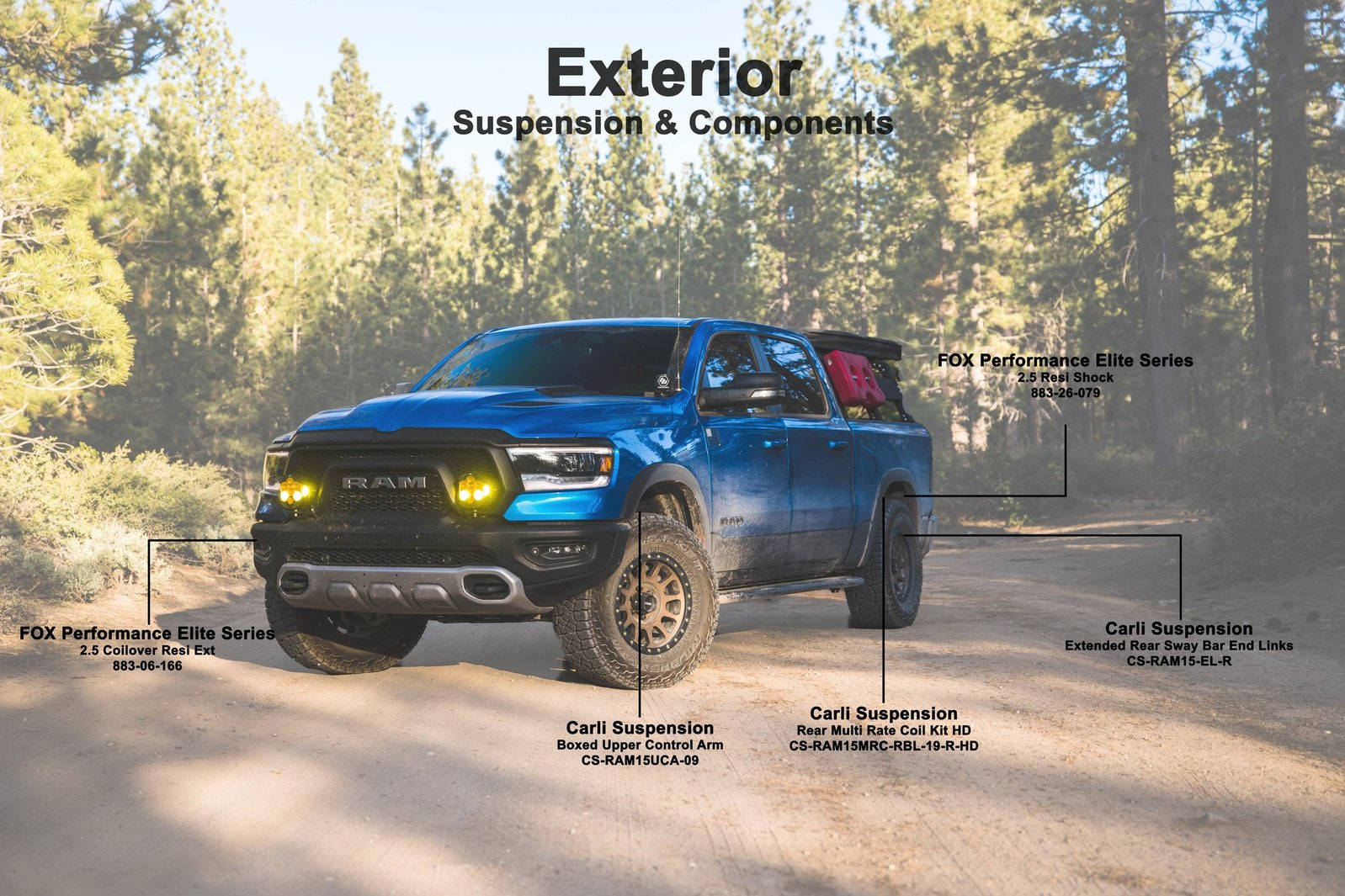

If you want to have both on and offroad mode, then go with Fox 2.5 DSC. Above is how mine was before I put more weight in the bed (yes, it’s the same with GFC on it) and ultimately sagged the spring after GFC and more constant weight with more tools, liquids, gears, etc.
This is what I run now. You’ll notice that I changed the front spring as well, that is because I didn’t want to mess with the preload in the front and elected to go with a heavier spring rate for better performance when I bottomed out easily on even tiny jumps - I should’ve revalved the shocks but I can’t have the truck down for weeks to get them revalved.

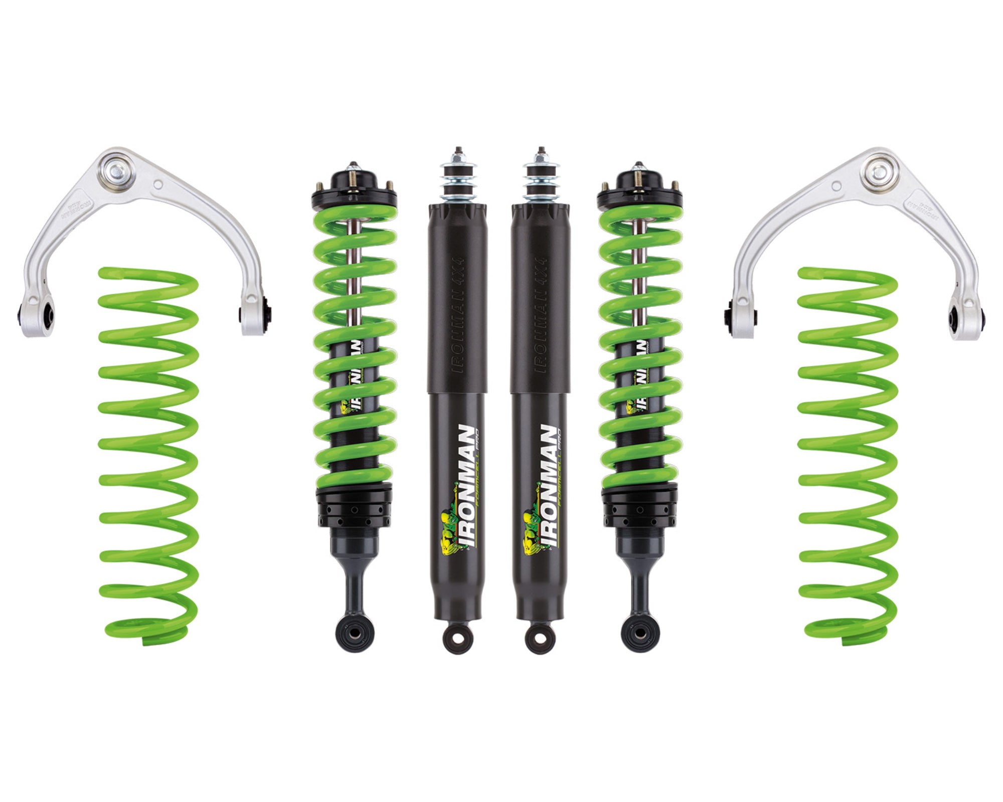

Alternatively, if you want something that works a bit better than the Bilsteins (holds more fluid), Ironman 4x4 is a great choice. Their kit comes with everything you’ll need.

to be exact, my springs sagged because… i was going highway speed when the road’s full of potholes and i had over 800lb on my rear axle, over 500lb (driver - me- included) in the cab (food, drinks, gears, armors, slider, etc). This happened when I was in Alaska and Tuktoyaktuk on a 15k miles road trip, surely I was asking a lot more for the truck and suspension with extra weight and made no adjustment to my “full send on dirt road” driving style.
send me a PM if you’re in SoCal.
i can show you what else I’ve done to make it expedition ready. like 50 days to Alaska and Tuktoyaktuk expedition ready.
