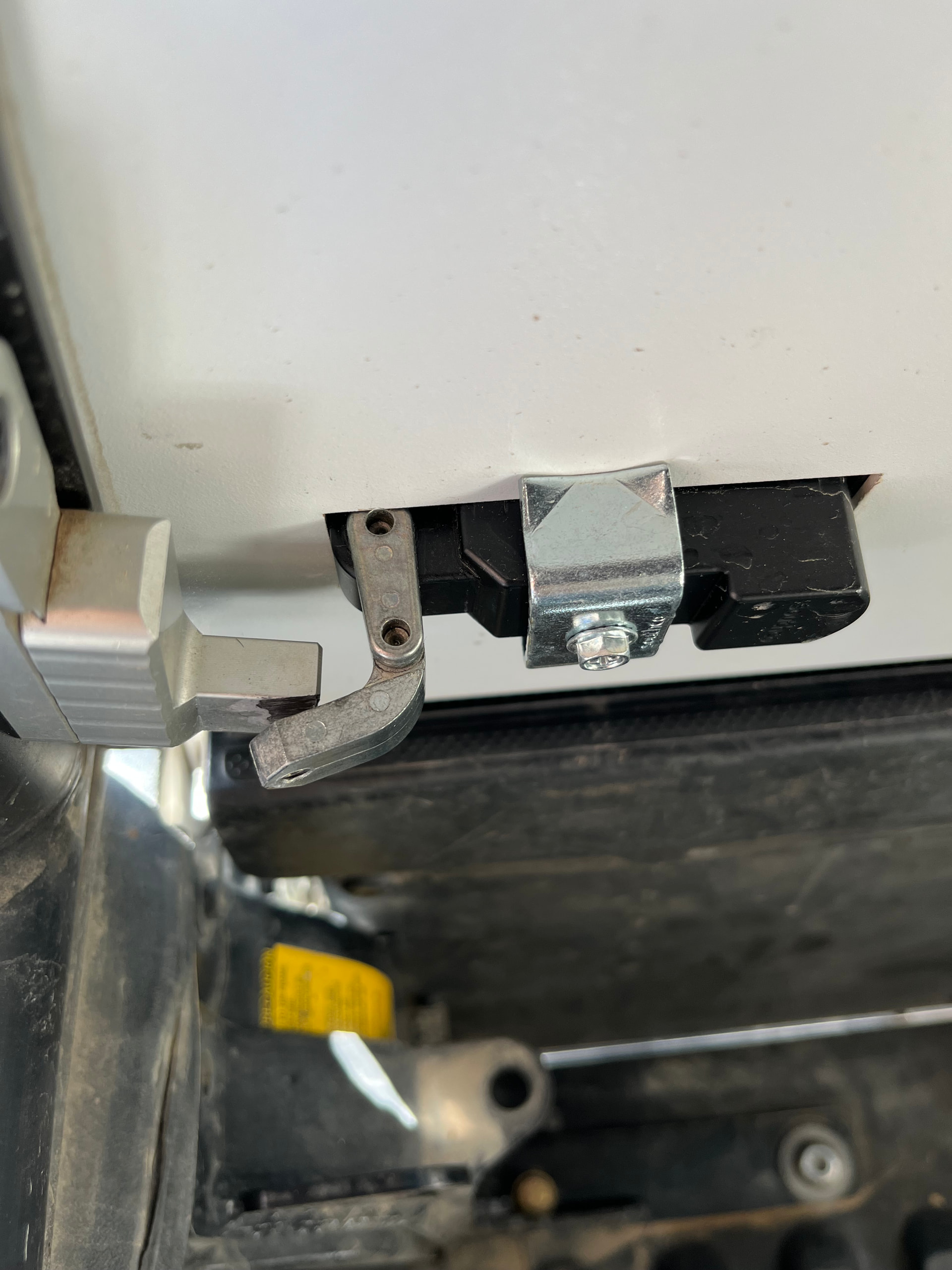

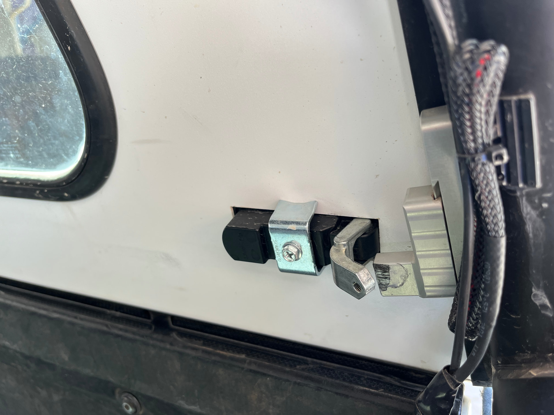

I upgraded the latches to the bi-directional key with the V2 Pro update. It is SO much better than the old key design, excellent, worthy upgrade. I haven’t had any issues with the panels bending so can’t relate there. But my big complaint with the new locks are the metal latches on the inside of the panels. Both latches on the back panel will loosen to the point that the back panel is bouncing back and forth and can be lifted open even with the latches closed and locked.
Here some pics of my problem:
I’m hoping GFC has some suggestions for how to remedy the situation.
Thanks Felix. So the plot thickens. So if I get the new V2 pro locks I get to look forward to them failing because the latches wear out. They are $200! I feel like I should be given these for free from GFC at least as a consolation for such a poor product but if this is the case with them I don’t want them as I will probably get my stuff stolen.
And all my problems above and I haven’t even abused my camper at all! Ive been camping in it only a few times and gone to the snow only twice. Ive opened the side panels under 50 times and the latches are already need of service.
