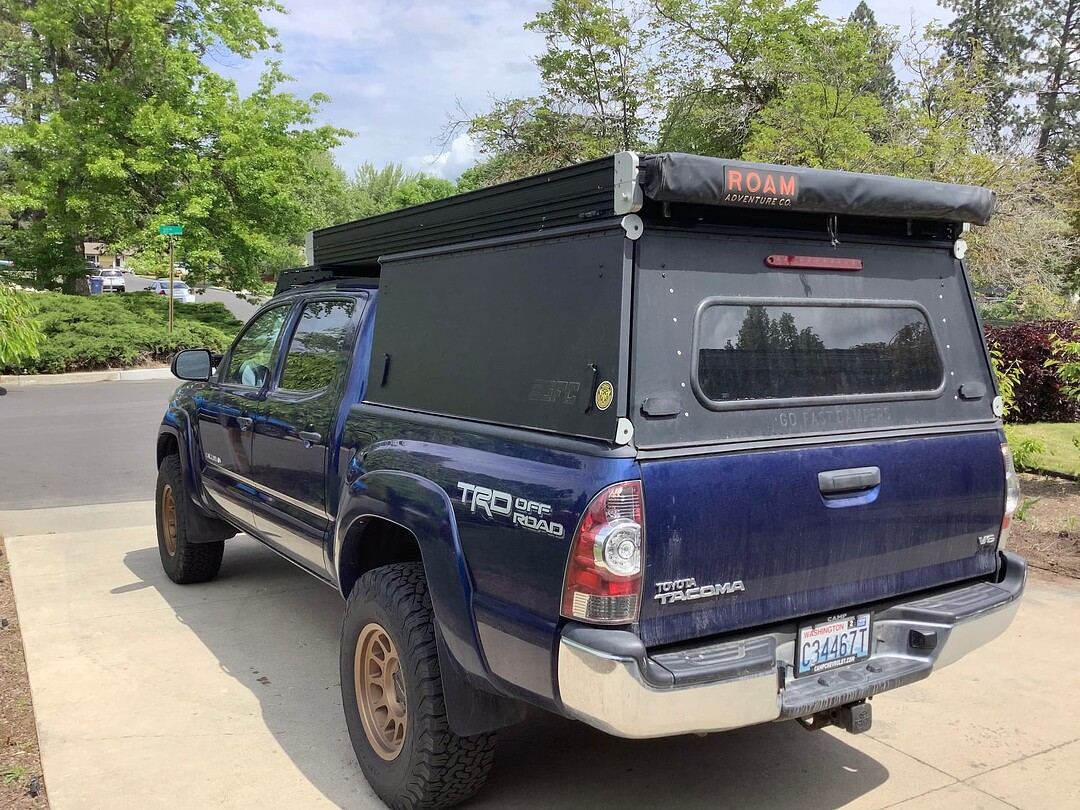

Roam Adventure 48” awning fits perfect.

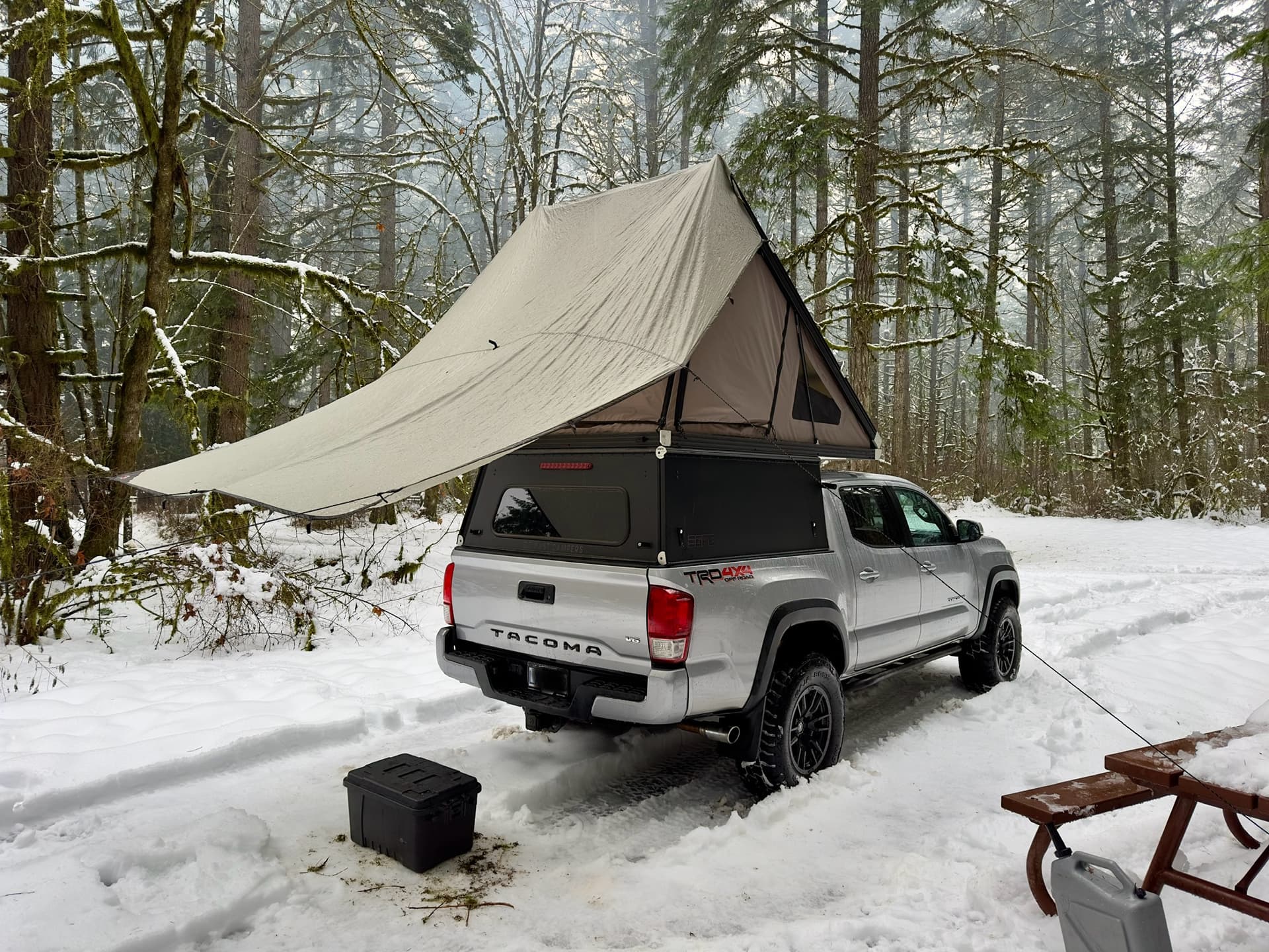

Here is my simple solution. I re purposed my Integral Designs Siltarp.

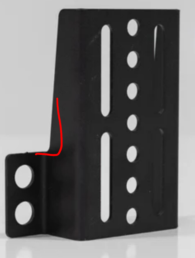

Were you able to use the GFC awning mounts without any modifications?
Thanks
Not without modification: the standard awning mount from gfc will interfere with the protruding lip on the top portion of the rear extrusion. Two options: notch the lip to clear the bracket is easiest. Other option is notch the back portion of the bracket to clear the lip.
