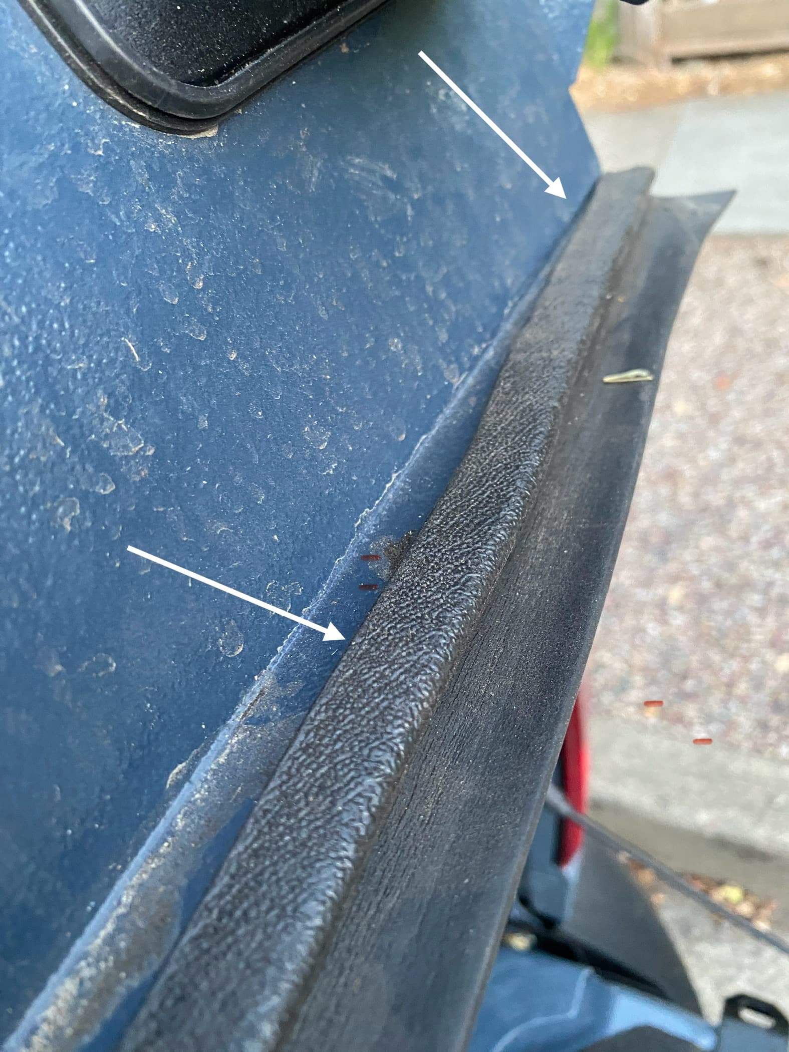

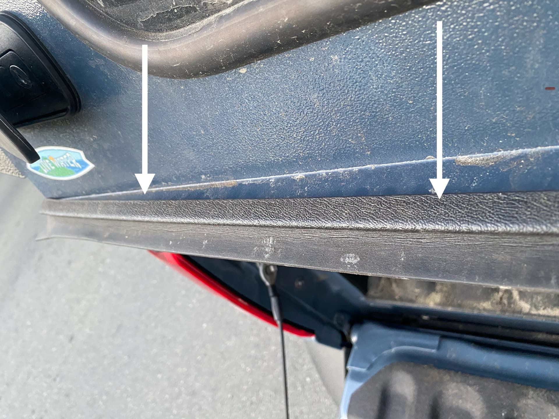

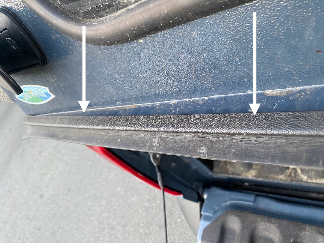

Hello, I’m interested to find out what you did for this situation. We’ve only had our GFC since July and already the window won’t open without popping the tailgate down first. Which makes no sense bc then there’s no getting out from the inside. Camping this weekend, our maiden voyage, I had to dangle myself out the unzipped tent in order to unlatch the tailgate, my husband holding me by the legs so I wouldn’t fall. What is with this? I attached some pics so you all can see how close the black seal is on the ends versus the middle.
