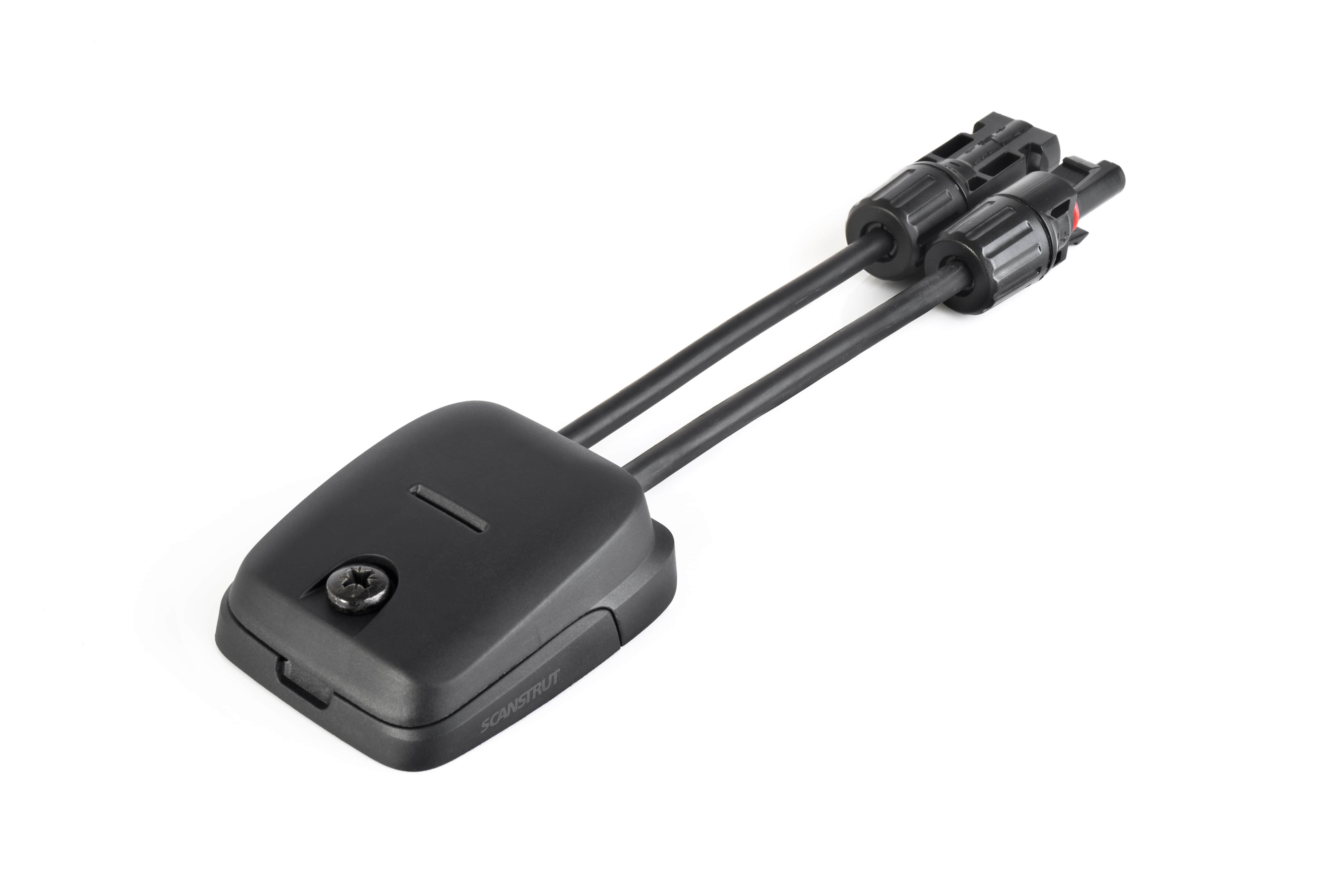

Has anyone tried using Scanstruts vertical or horizontal cable seals? I’m planning out my solar build now while I wait for my GFC.
I’m looking for an alternative to the typical bulky entry gland fixed to the roof with some messy looking sealant. I would go through the side but I do a lot of driving through thick forested areas and I would like to avoid running them over the side of the GFC. The roof seams like the safest and cleanest option as long as I can find a way to run it down to the bed of the truck. Looking at some of the instal videos though I wondering if the screws will pop through the roof and be exposed on the other side?
I would just worry about the screws in the honeycomb. I like the concept though.

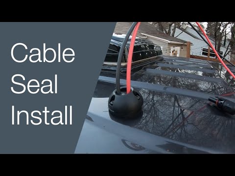

I just drilled a hole in the roof and used one of these to cover it. Held it down with some sealant and butyl tape. Been up there two years with no leaks or issues.

Yeah this is what Im trying to avoid see above.
