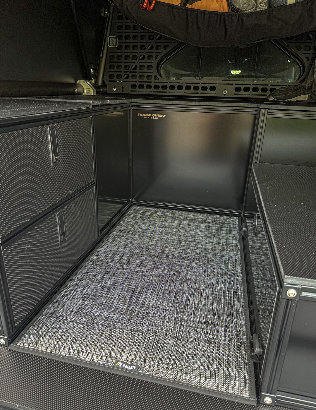

Assembled the Component/Distribution Panels. These will mount to the side walls of the power compartment. Decided on these to drill less holes and hack up less of the Terra Quest Off-Road Kent 2.0 bed storage system if I ever change stuff up or add things down the road these panels are cheap enough to swap out.
