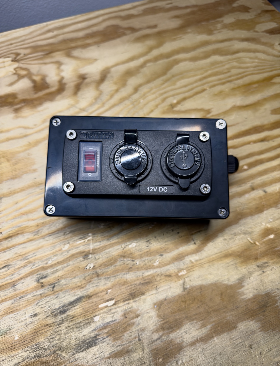

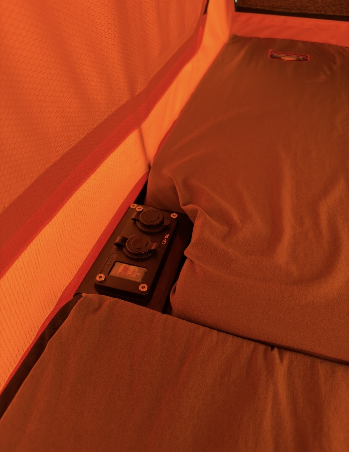

**Installed: **

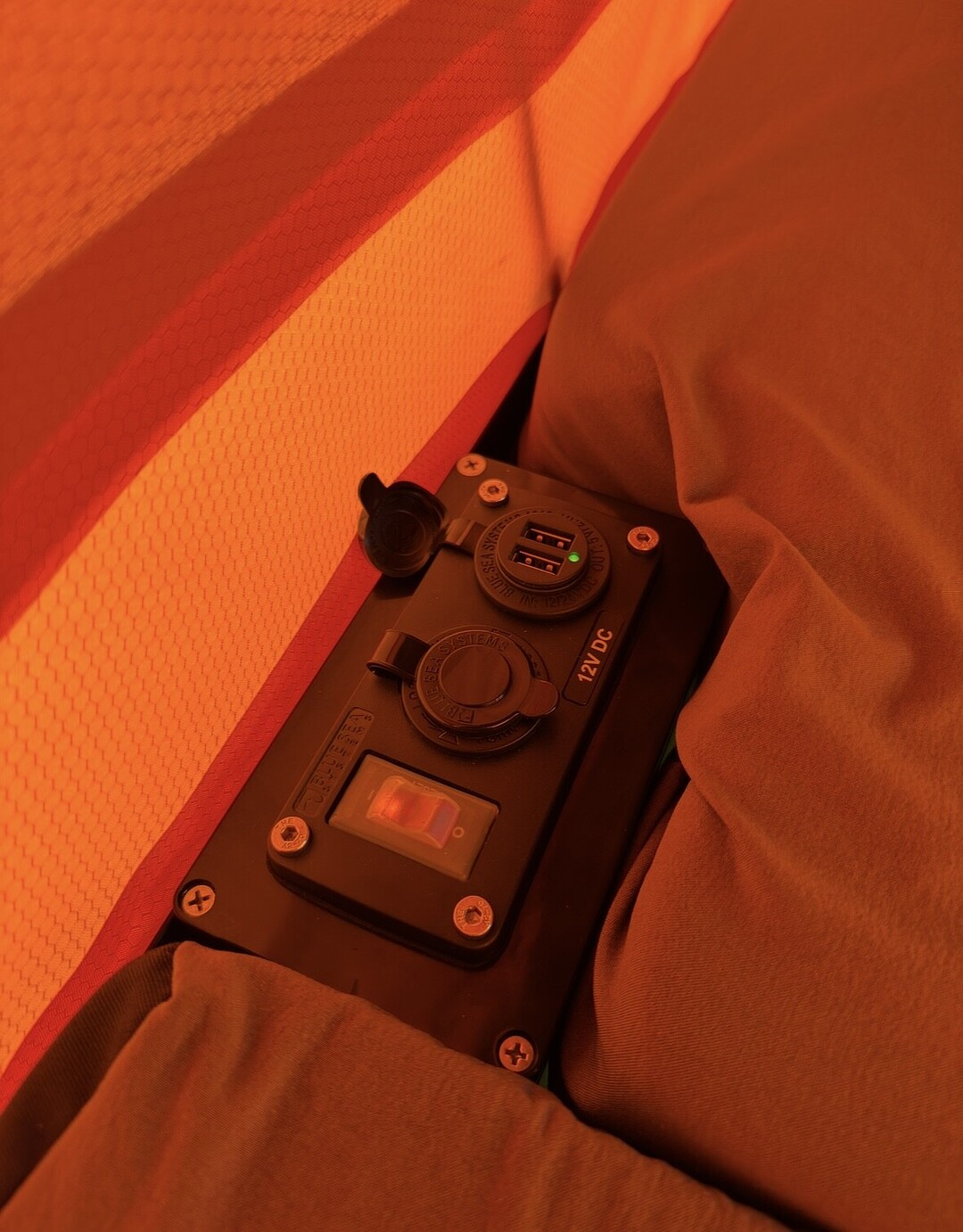

-BlueSea Switch/Port (P/N: 4363) (Upstairs Power Outlet)
-Junction Box IP Rated (Upstairs Power Outlet)
Finished the wiring and install.

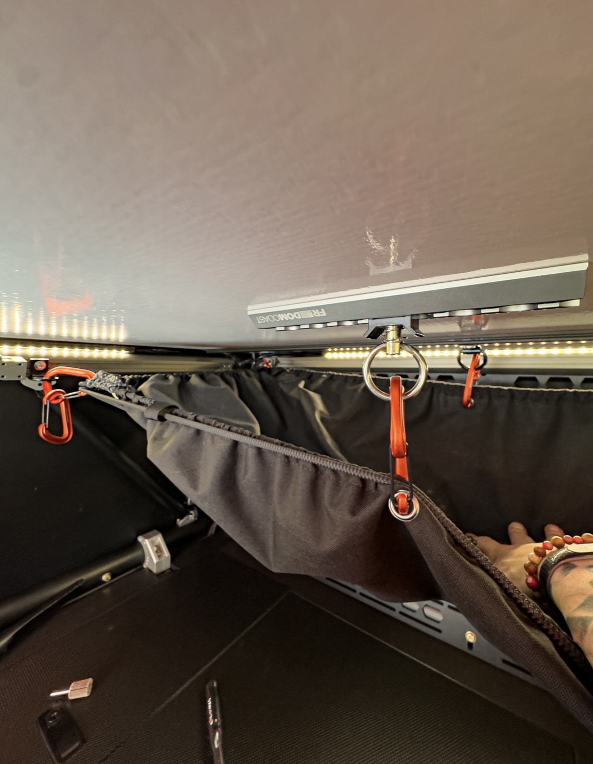

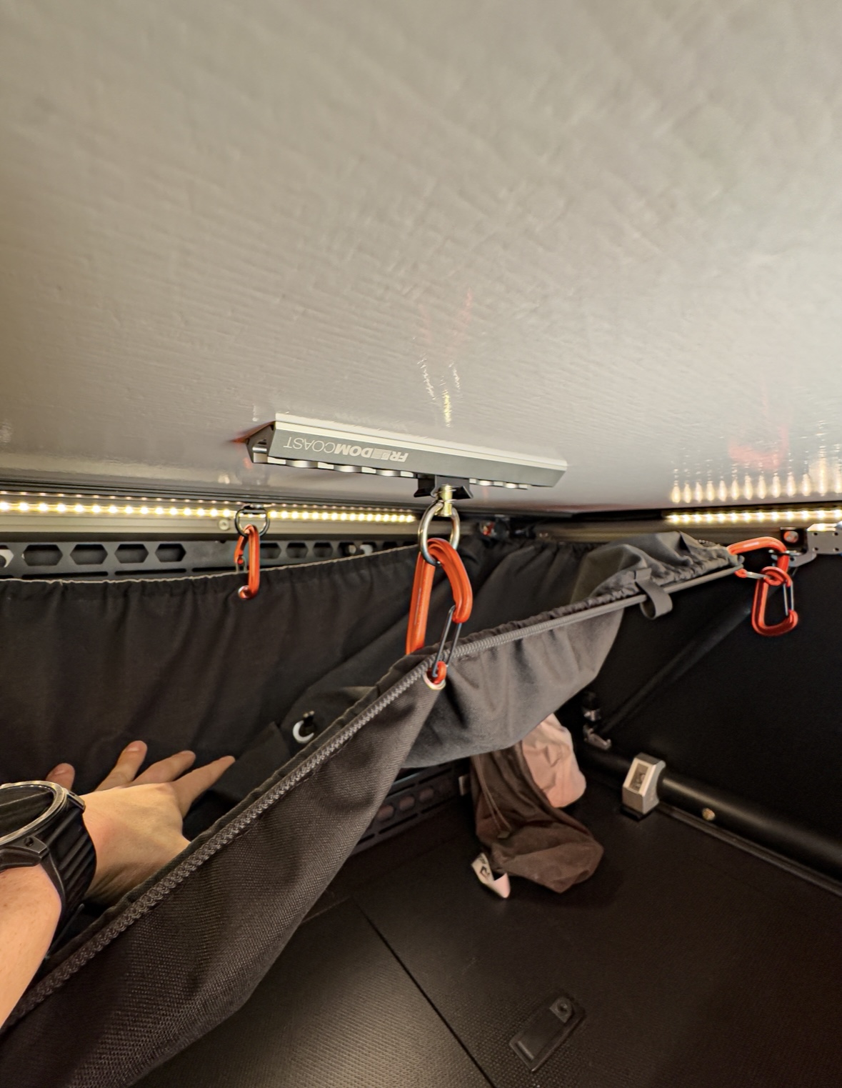

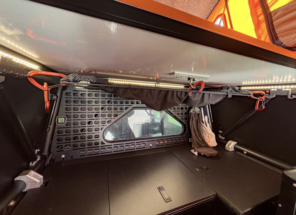

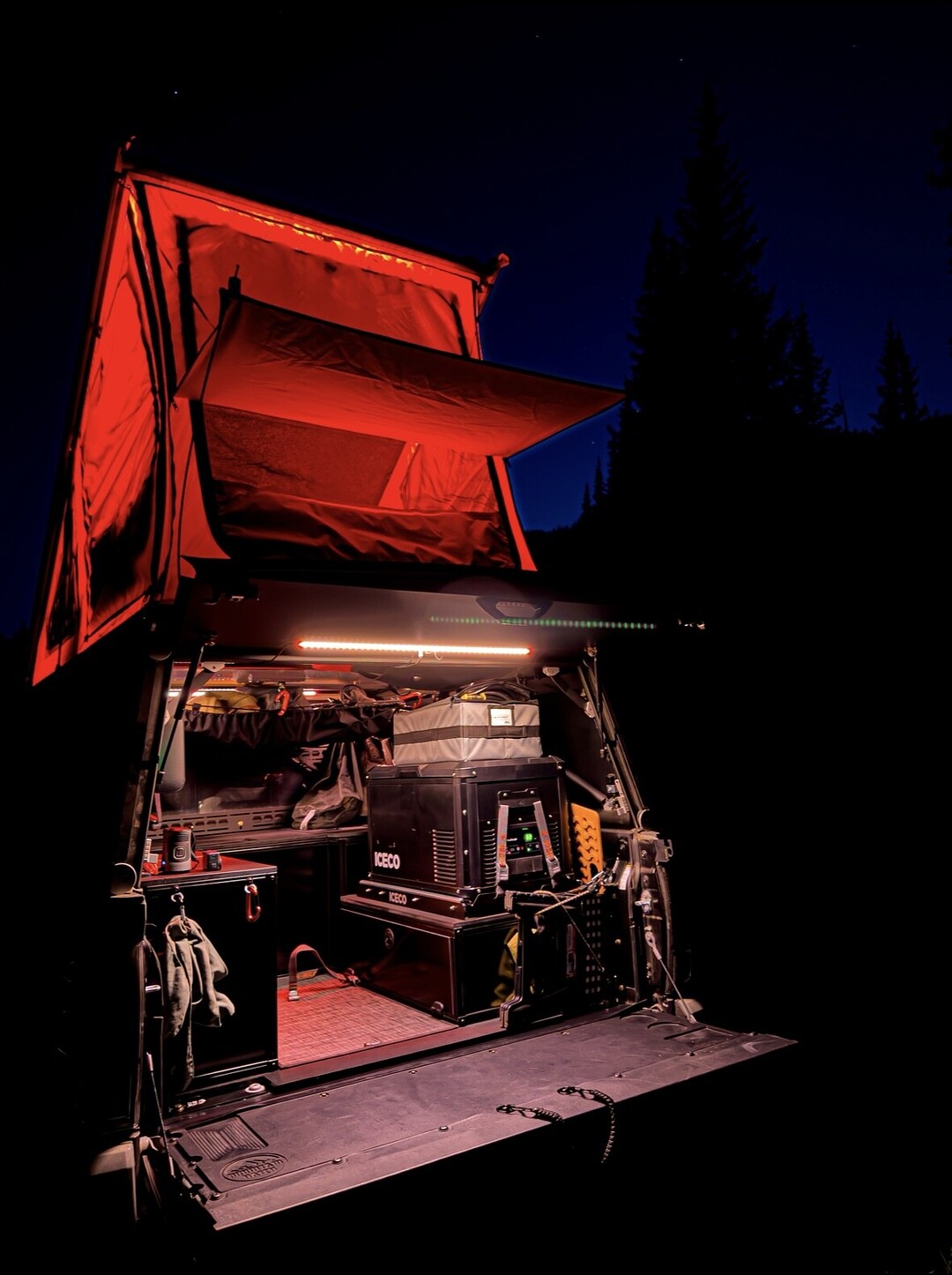

Installed: GFC Pro LED Lighting Kit Installed

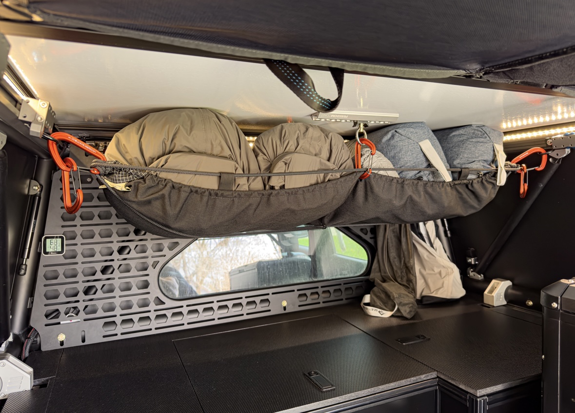

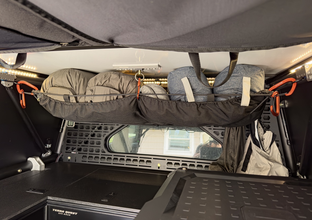

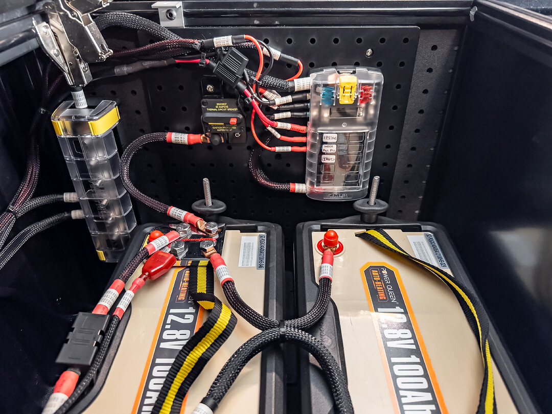

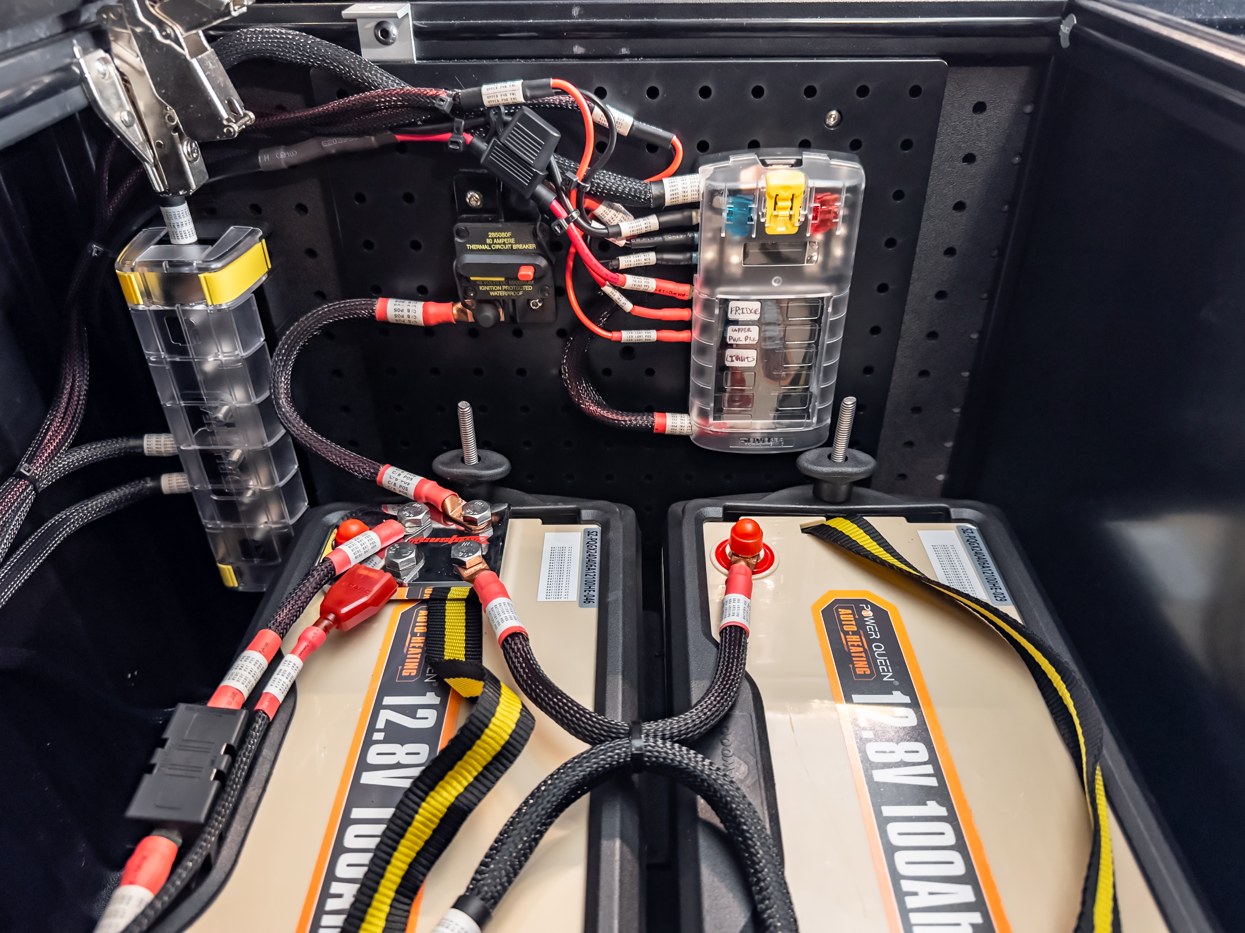

Fixed: Bedding catch no longer sagging a ton and the underside bungees no longer all out of place.
Before:
After:
Nicely done!

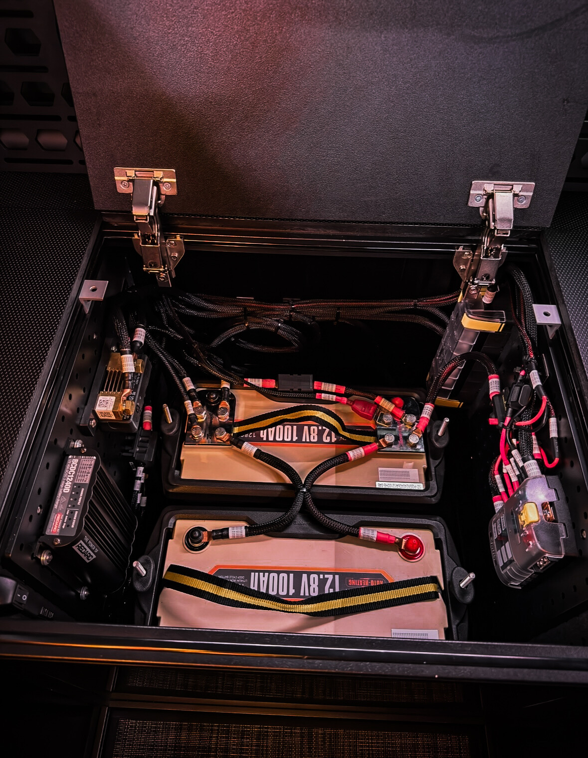

Swapped: Blue Sea Fuse Block 6 Circuit for the 12 Circuit Fuse Block

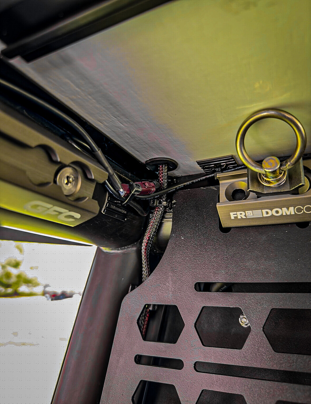

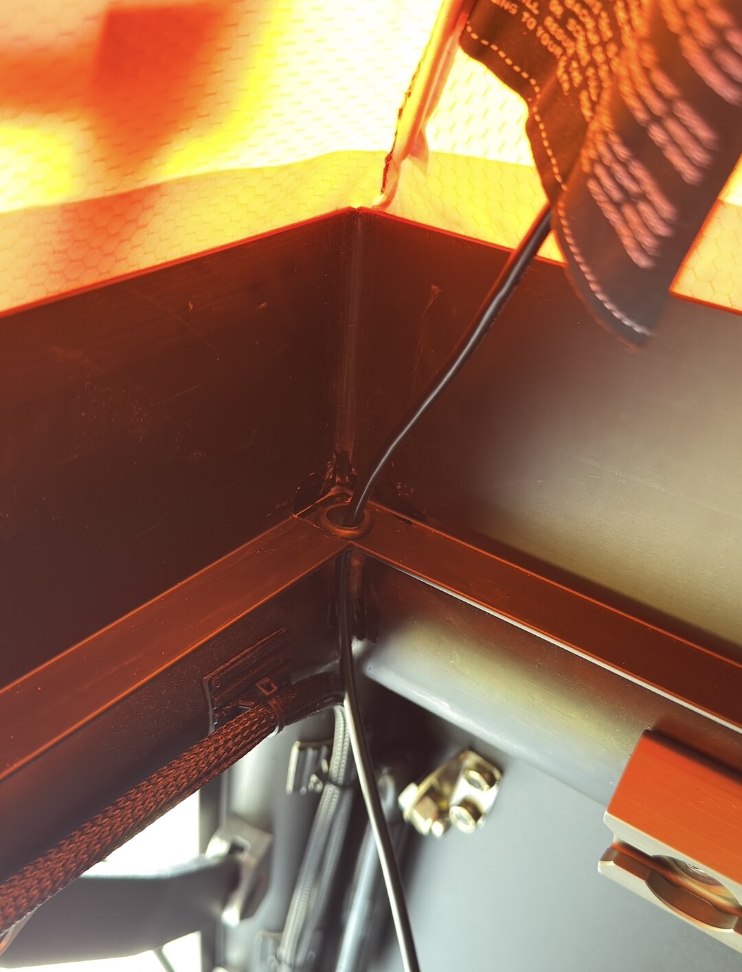

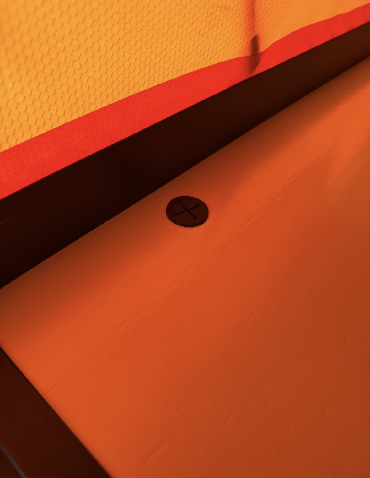

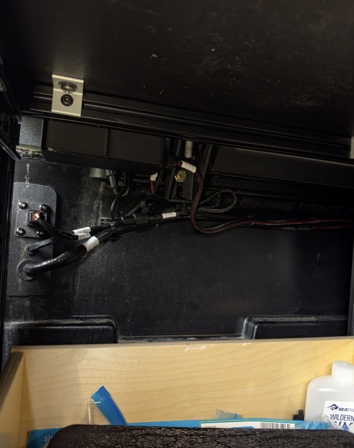

I wondered what hole size/grommet you used to run your upstairs lighting and how you managed the cable wire on the tent fabric? I thought about running my light wire down the extrusion to the front but would prefer to run it straight down like what you did there. Did you have to adjust the small square panel so as not to interfere with the wire? (assuming that’s your layout?
I just kept making that size hole until the grommet would fit with the connector for the wiring kit, It was kind of a PITA I had to go at it multiple angles with a 1/2” bit after it was big enough to make it to where the connector fit through then added the grommet. The small square panel doesn’t interfere as the corners on the board are rounded on the bed square. I can move the cable with the panel in. Yea I wish there was a way to secure the wire but i’m not too worried I have a Pro V2 tent material coming to swap. I can send you more info and pics if you wanna PM me.

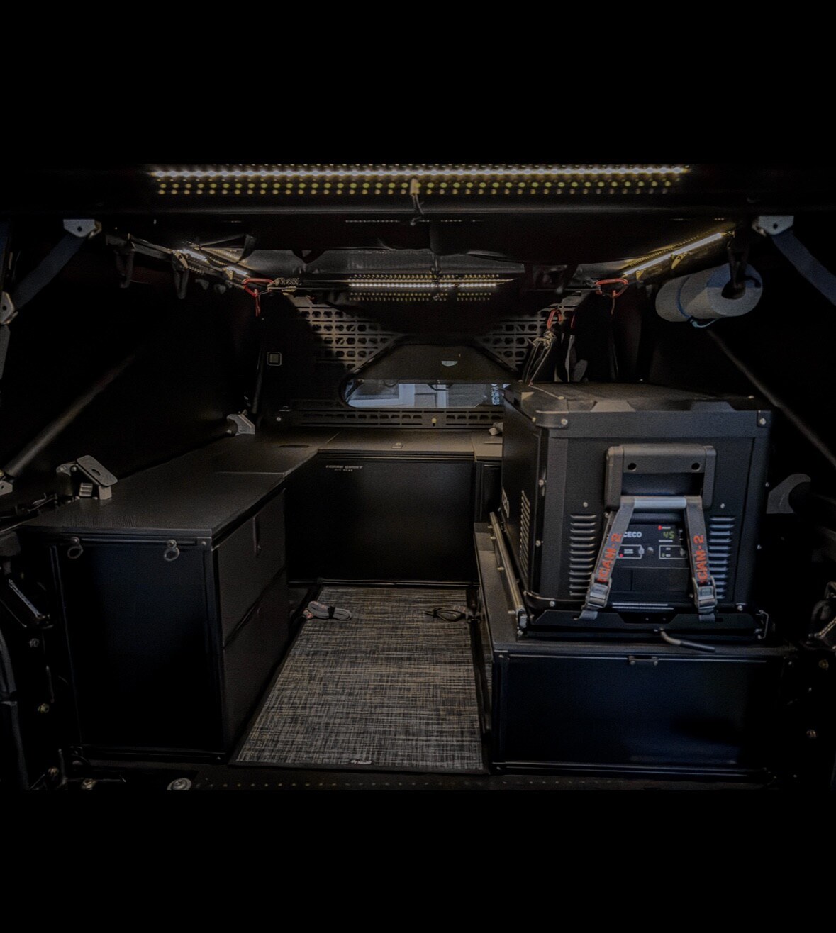

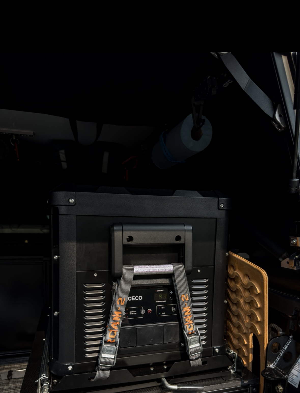

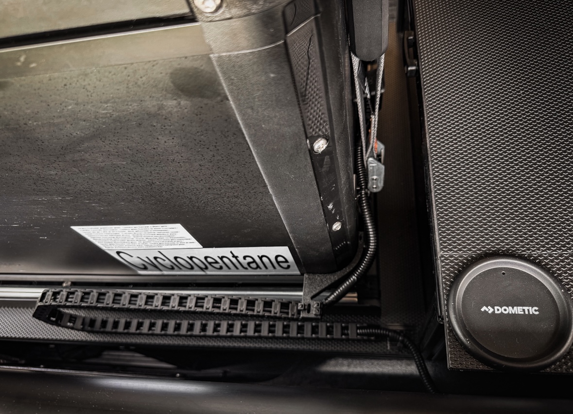

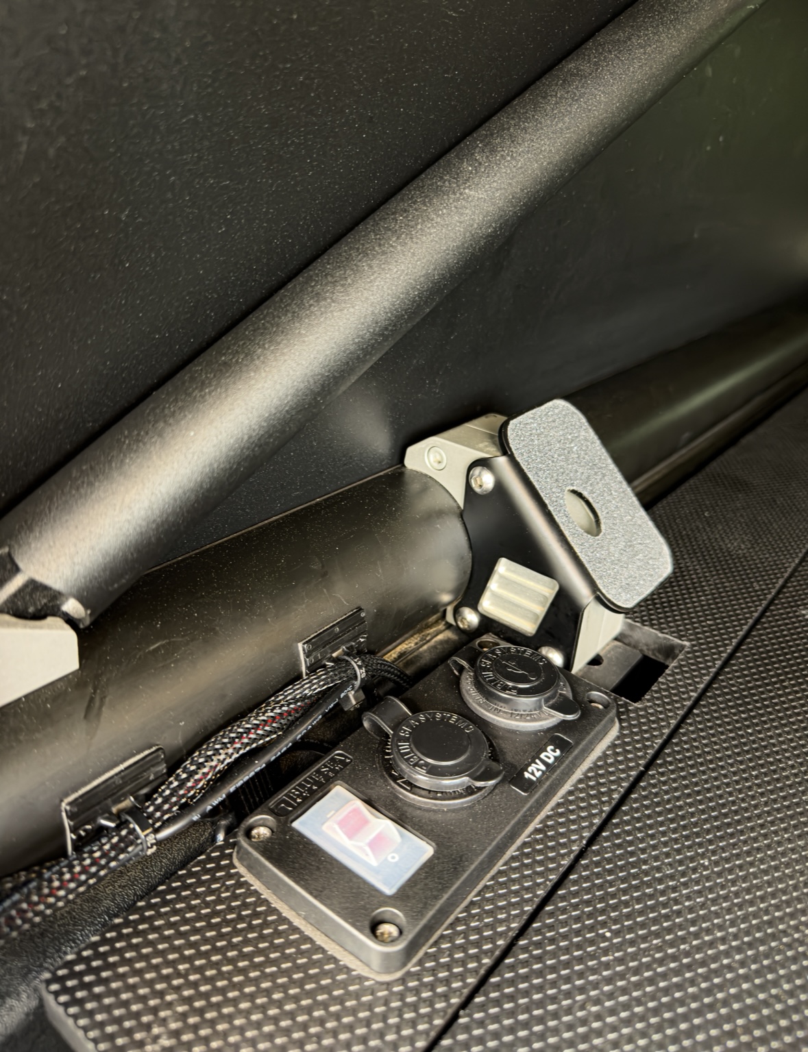

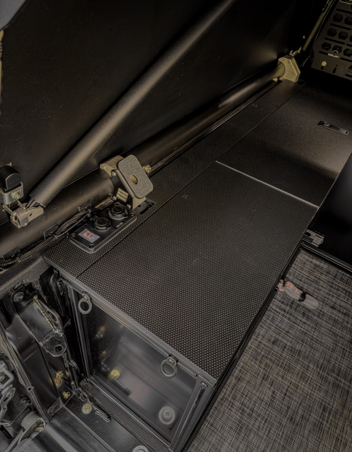

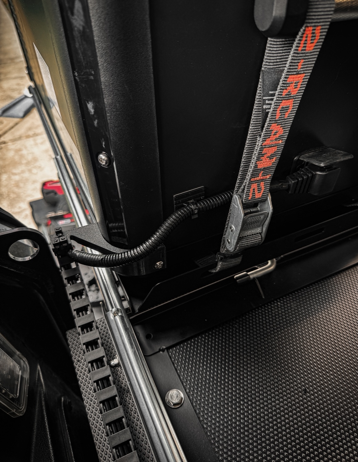

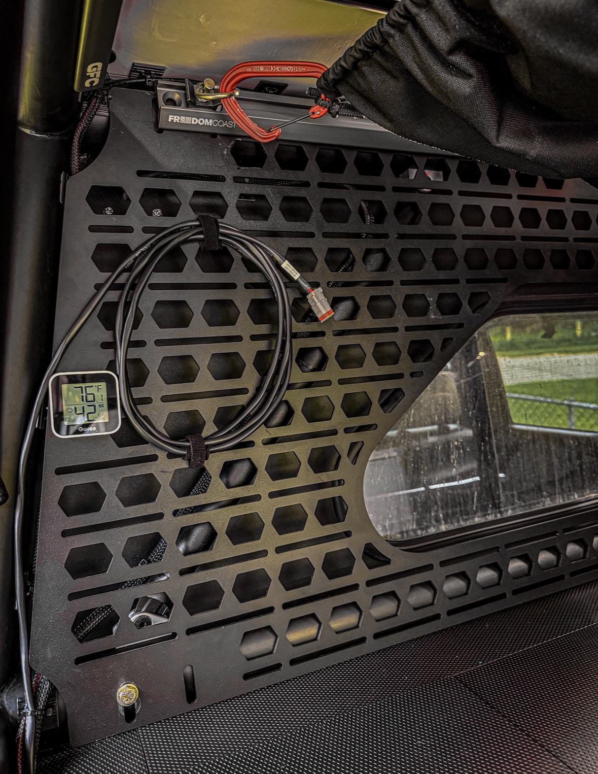

Installed/Changed:
Fridge wiring cleaned up and the drag chain In a better location.
Got the lower power panel wired up also.
Starlink Mini PCI Race Radio Power Kit setup too. This is temporary until I eventually get a cab rack and then i’ll run the wiring through the bulkhead.

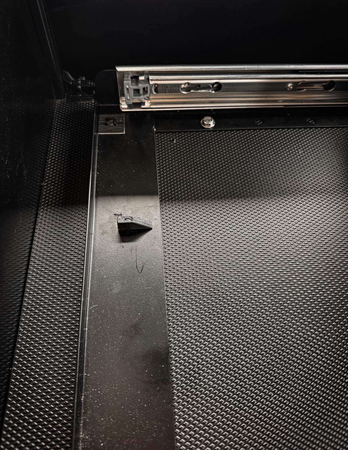

Thanks to @Buhlockaye for the printed goodies (Switch Panel Junction Box, Fridge Slide Stopper, Fridge Wiring Support Arm) to make it all work!

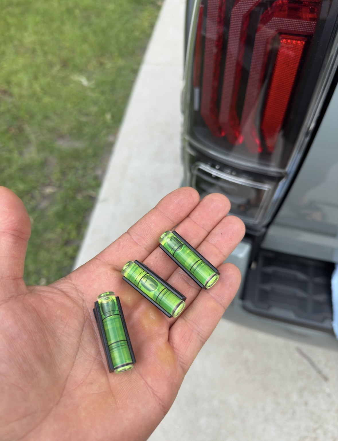

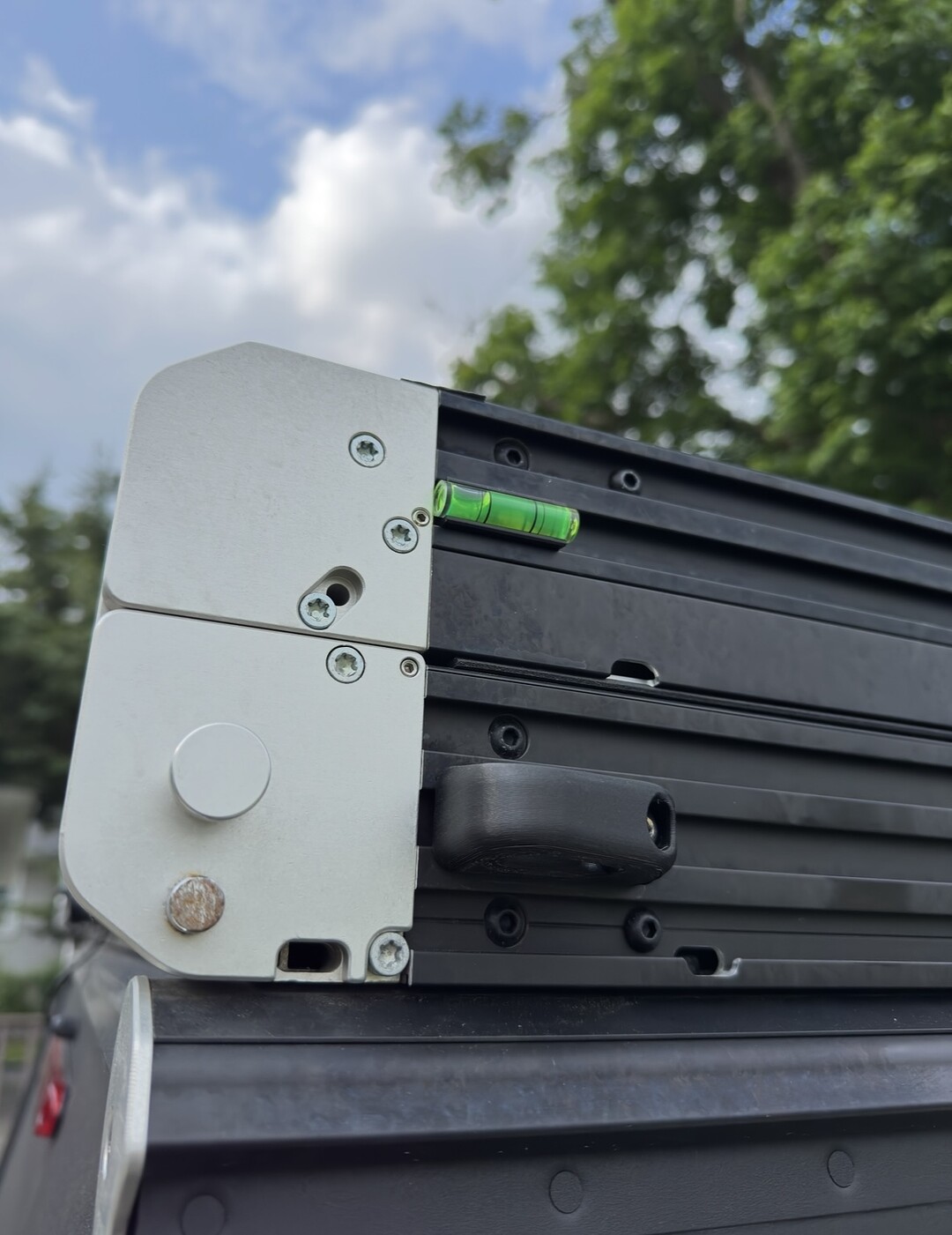

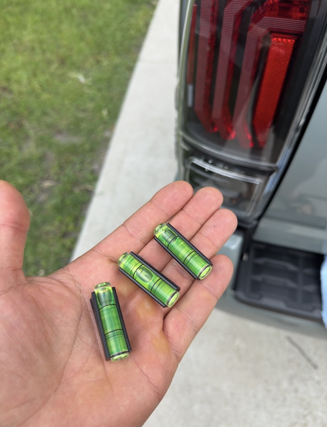

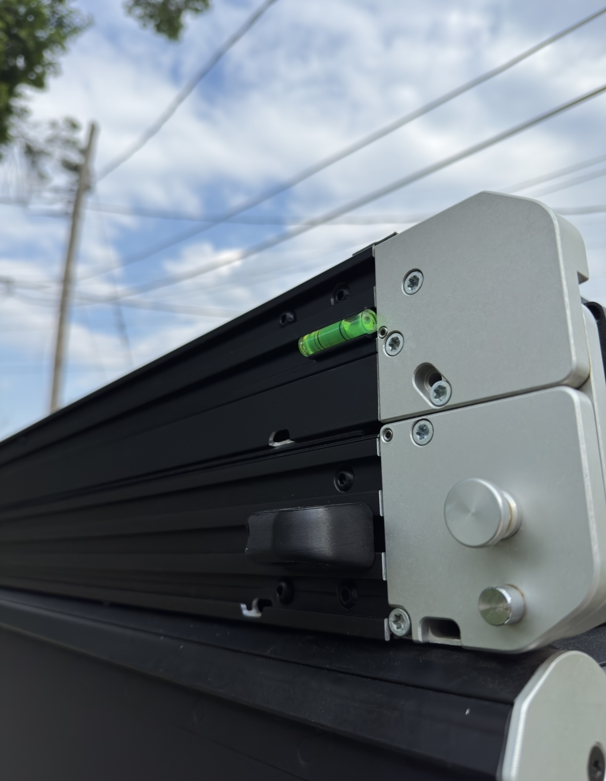

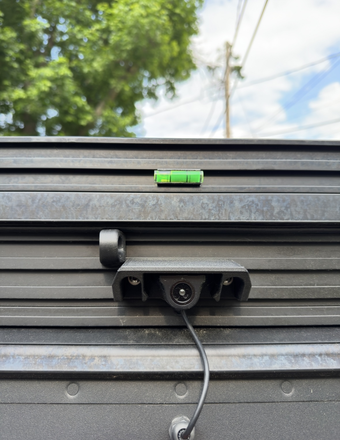

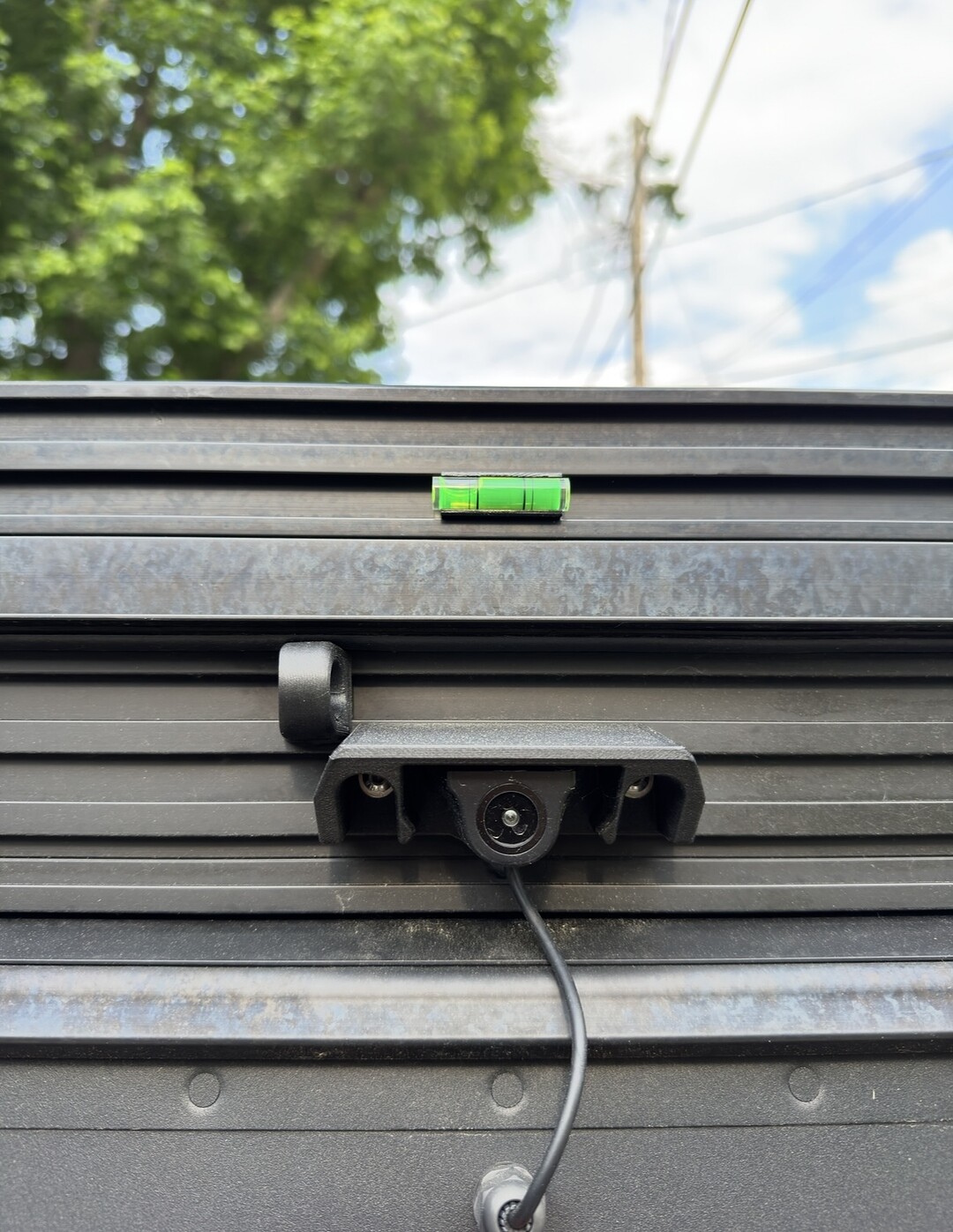

Installed: Bubble Level Hack thanks to @Shittco
McMASTER-CARR P/Ns:
2148A85 Tube Vial
2148A77 Mounting Flange (Spray Paint Black)
Adhere Mounting Flange With 1/2” 3M VHB Tape
One of the first mods i did. Very little effort needed and well worth it. Only thing is over time in AZ sun the green turns to clear.
At least you could slap new ones in yearly for very cheap if you cared. Yea you guys get some gnarly sun and a lot!

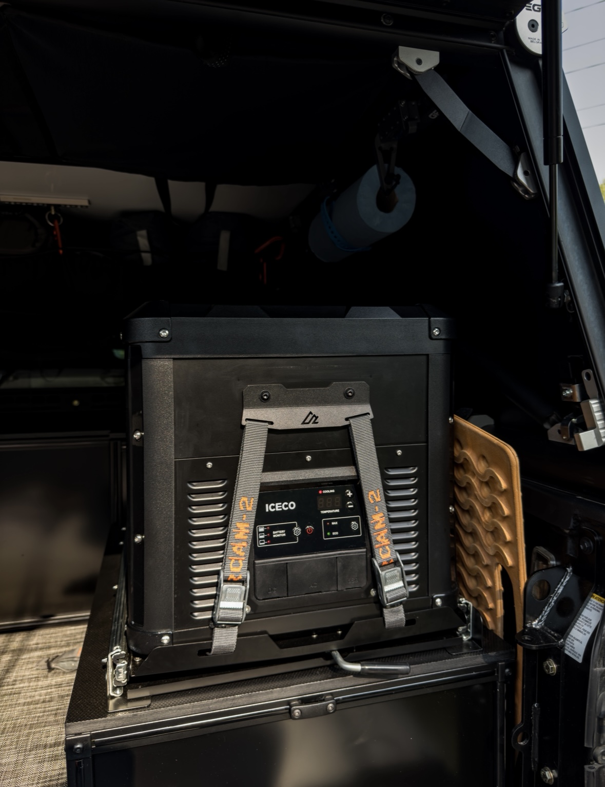

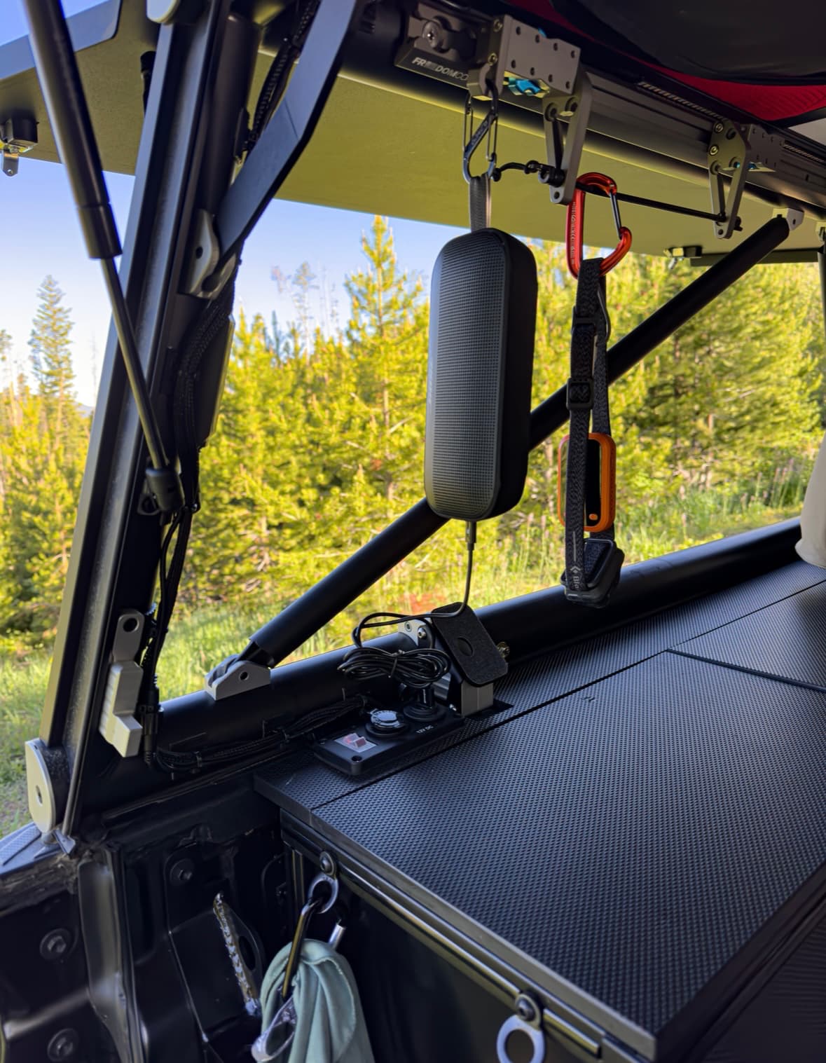

Installed: American Adventure Lab Pro Handles (ICECO Fridge)

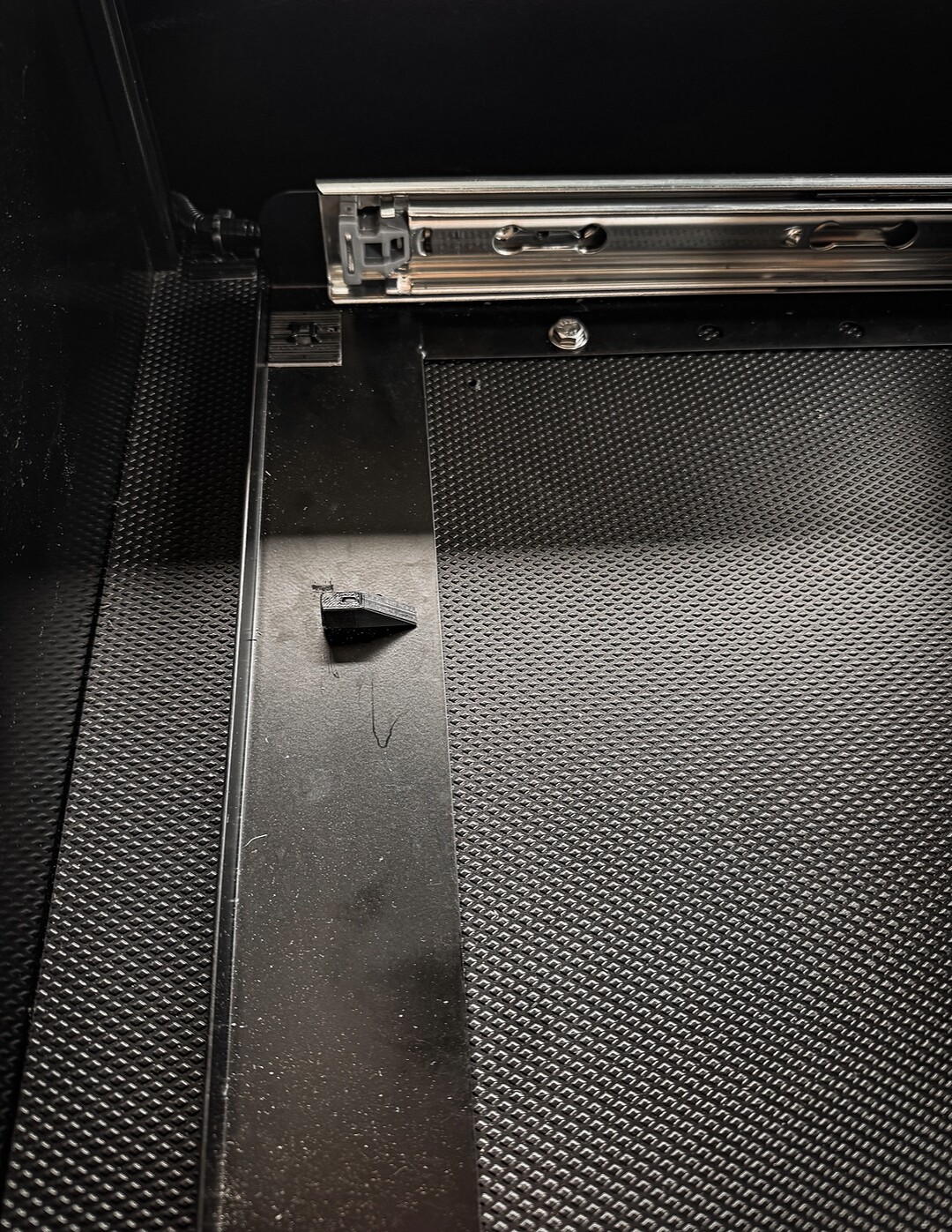

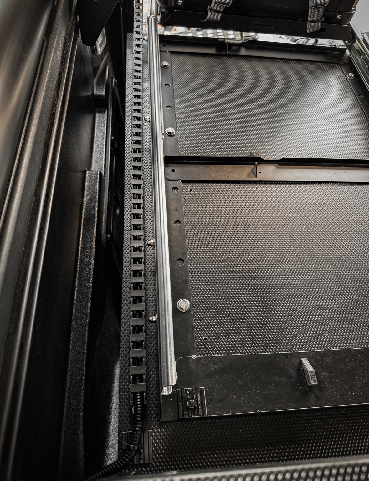

I’m in a similar situation and would like to copy your solution. Can you explain how you attached the Freedom Coast rail to the bottom of the floor?
Drilled two holes in it and ran a flat bolt with fender washer from the top to bottom and used a flanged nut on the bottom side.
