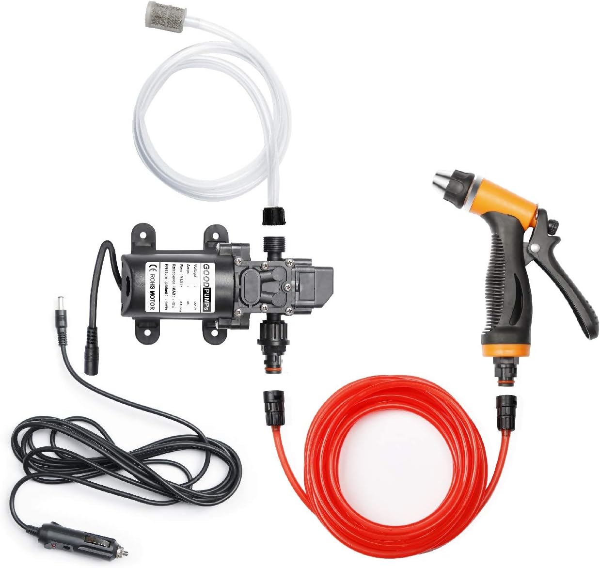

I had something like the Nemo Helio. It’s perfect if you want a shower, but if you want some pressure (washing dishes, hosing down muddy dogs or bikes etc) it falls a little flat. I ‘upgraded’ to this thing and it’s pretty awesome. Just drop the tube in your Jerry can of water and you have an instant hose.
