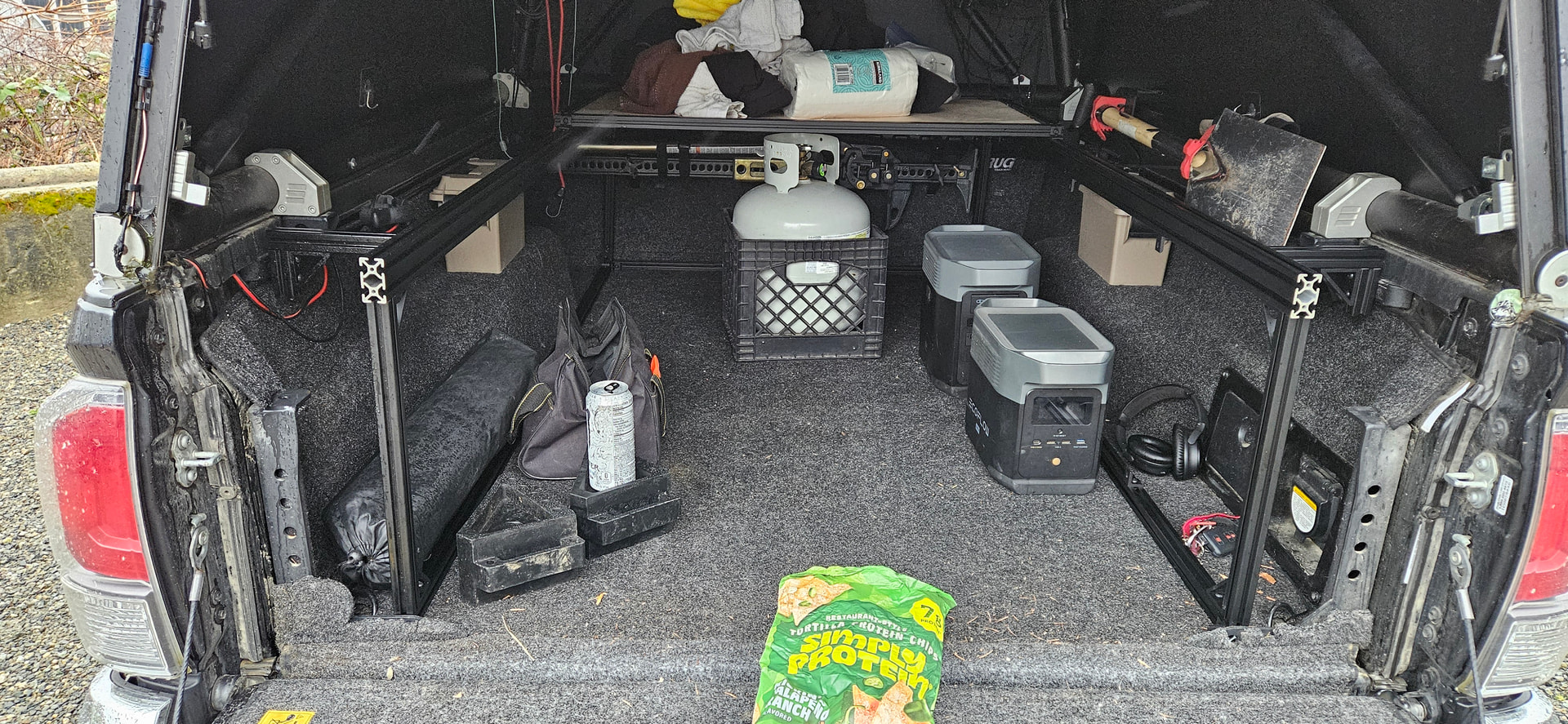

Step 1: Framing the bed storage
Just installed framing in the bed of the truck, and pretty happy with how it came out. It’s going to be a bed height wall at the edge of each wheel well, and for now, a sliding shelf that rides on the rails. This lets me fully utilize the dead space the wheel wells create, and instead of just tossing paddle boards or whatever on top of all the other gear, can can set it on the shelf. I could also add in more panels to have a fully flat surface at bed height and use that for stealth camping if needed. The shelf is currently not sliding, the 4 rail slides are $120 total, so I figured I’d make sure everything is looking good before I order them.
Thinking of using the same material the GFC roof is made of for the walls. The shelf supports my body weight at 220 lbs. Pretty impressive as the framing only weighs about 40 lbs.
