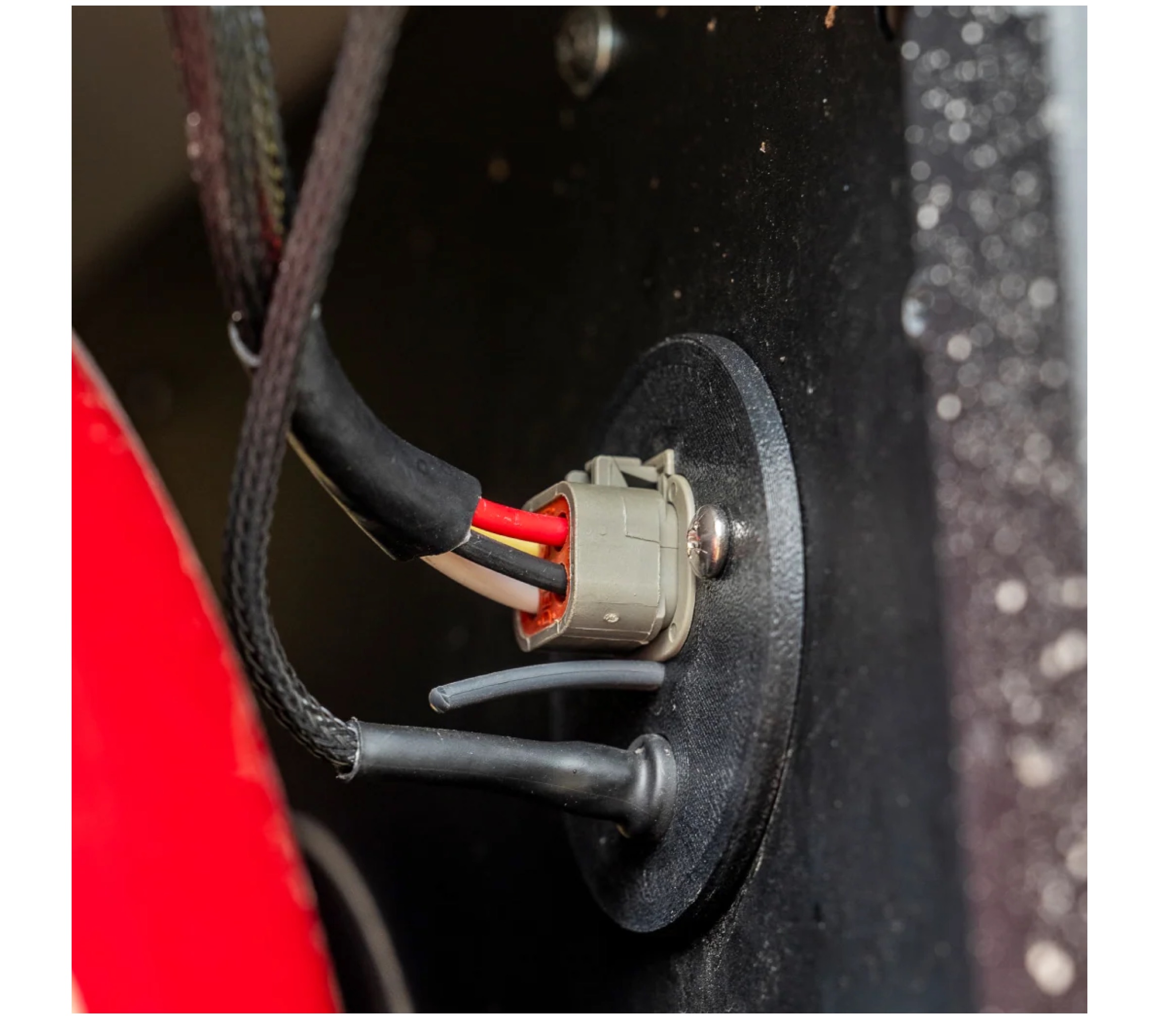

I want to run 200w flexible solar panels in parallel. I was just looking for what others have done and where they passed the wires through the hardtop. There isn’t many low profile roof glands that will fit between the bottom of the tent and the hardtop
Ah, I gotcha. The clearance between the RTT and top is definitely tight with our direct mounts. I would probably run some sort of pass through that uses a DT plug on the exterior of the top. You could then terminate the solar panel leads with a DT connector that would plug into the pass through. This would probably be your lowest profile option, in my mind. It would also allow you to remove the entire RTT and solar setup without cutting wires or leaving a hole in your top.

I found a roof glade last night made by scanstrut that are just under 1" that may also work. I have some more research to do and miyay but both options and see which one is going to fit best and where.
