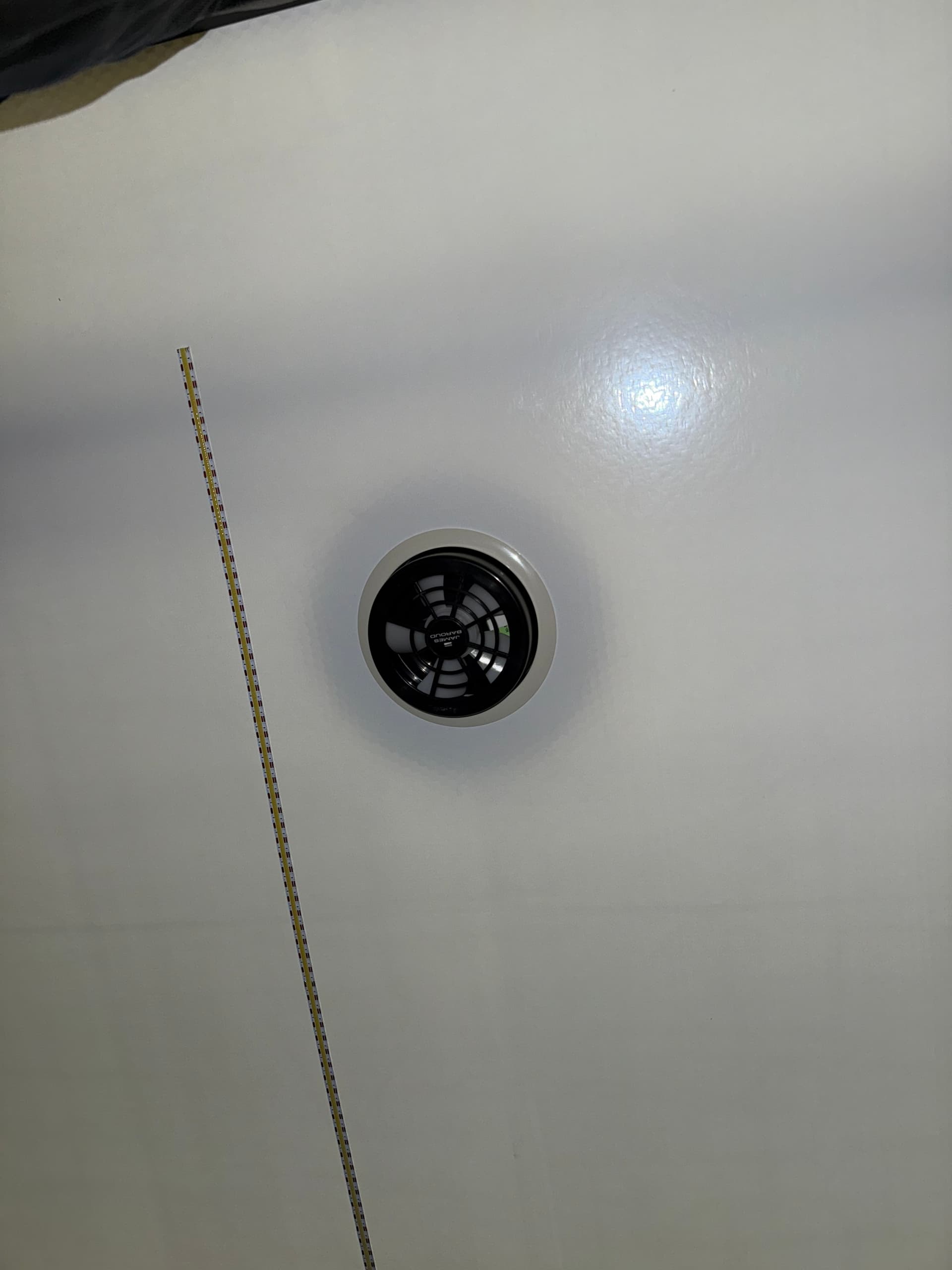

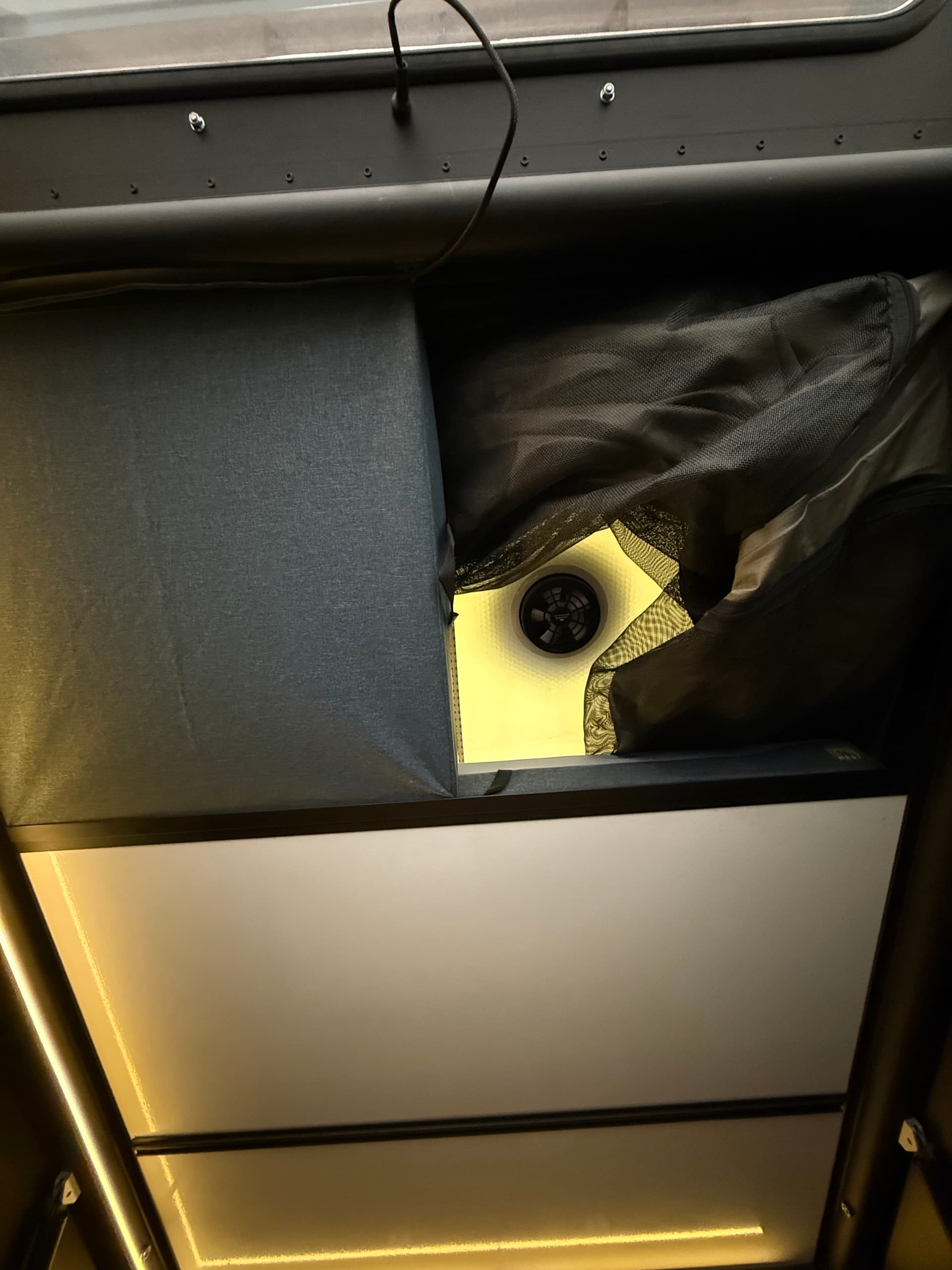

Figured I would add my two cents here, given I did it a bit differently.
I went with the James Baroud fan, that is now $160. Not sure I would sway someone toward this, but I figure a real name might actually back their products should something go wrong. Overall it looks exactly the same as the fans everyone has posted here.
The piece of the fan that sticks into tent is roughly 4 5/8" in diameter. I ended up using a bimetal 5" hole saw running in reverse, which worked perfectly. Cleaned the top with alcohol , used painters tape as a guide to center the fan, and stuck it on. Decided to go with just VHB tape rather than using screws given my historical success with VHB. Maybe I will regret it? I figure I would rather go without screws in order to minimize intrusion.
One nice thing about using a 5" hole is that you can use a 5" cable grommet trim piece to give it a nice, finished look. I bought this one: Hardware Resources 67000WH 5 Inch Diameter Cable Grommet - Single | Ferguson Home and it fits like a glove.
One last thing I did differently was mount it off-center so that I could use it with a single small panel out and the tent down. This mattered more when I originally mounted a large fan in my last camper, but I figured I might as well give myself the ability to use it with the tent up or down.
Edit: Pictures added

Pictures of yours would help…..
Heard. Edited above with pictures.
very nice this is slick
That looks awesome. I may have to follow suit after I see how things go camping this summer.
I’ve got the tools do it! (And an extra fan I couldn’t return) haha
