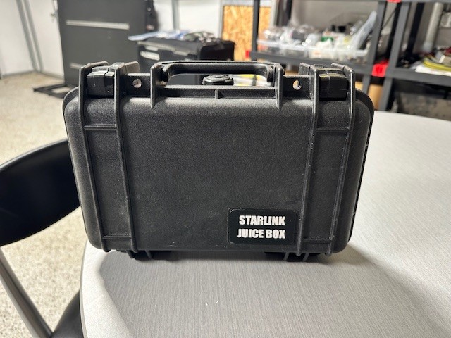

I built something similar before I bought a Mini, a 12 volt juice box for my Gen 2
