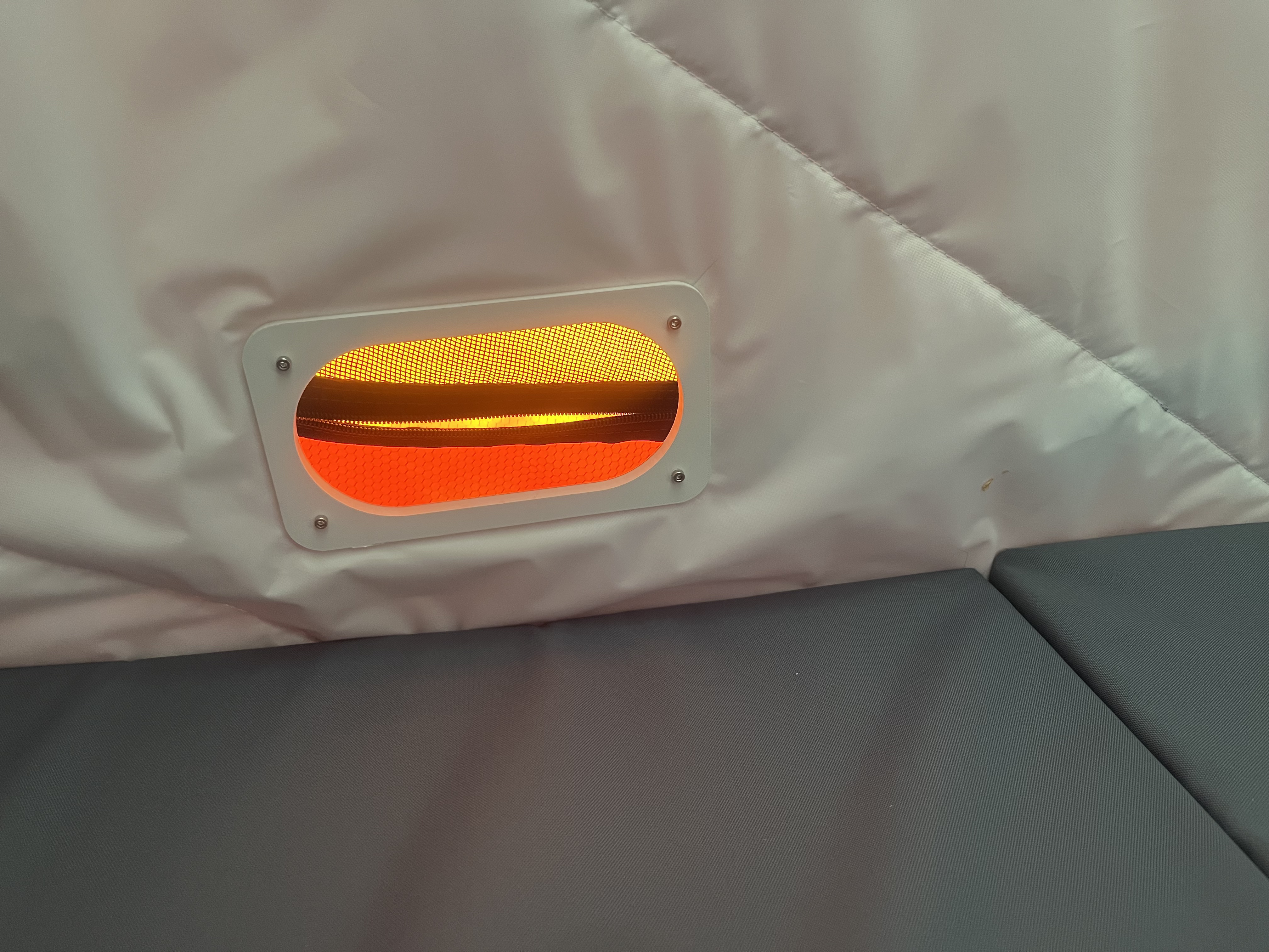

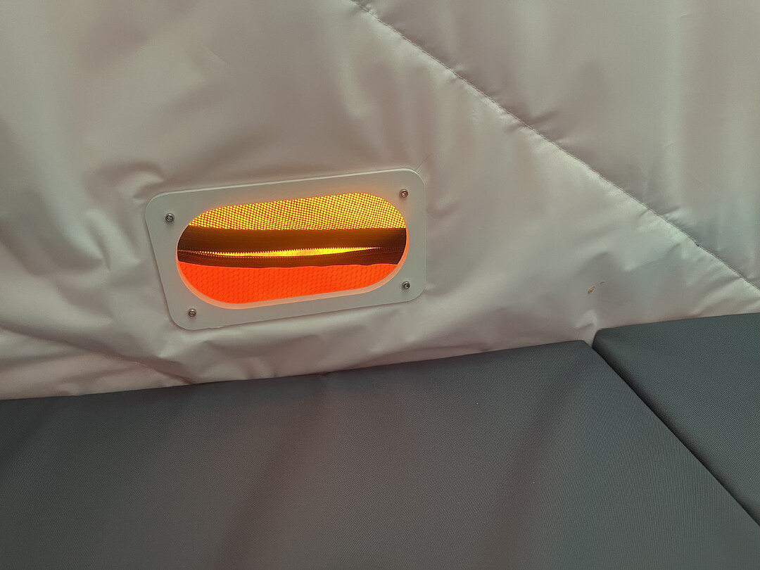

This is the design I’ve currently got. Would allow two heater tubes through. I’m starting to think that two separate tubes with quick attachment points would be better. The other thing this needs is a way to connect tubes on the inside of the tent (fitting on this port + velcro to place) so the recirculation doesn’t happen just in one corner.
This prototype is a laser cut + tapped aluminum back plate for rigidity, plus an ASA front plate that has a lip to capture the raw edge of the fabric cleanly. Could modify the ASA piece with some more sophisticated geometry.
Thoughts? Maybe a quick connect system like this one would be best?
https://www.etsy.com/listing/1821602333/heat-link-the-ultimate-diesel-heater

Looking amazing!
