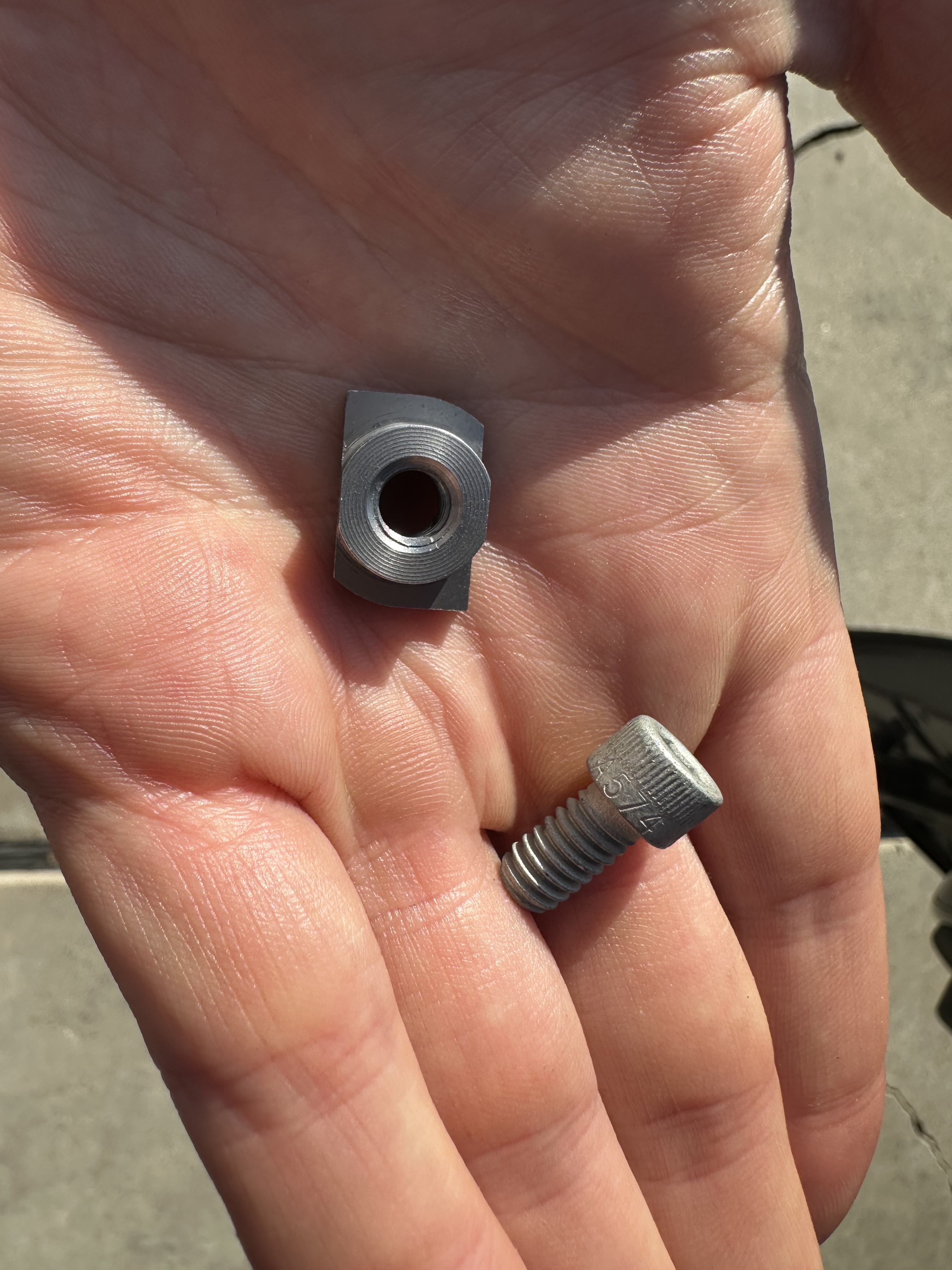

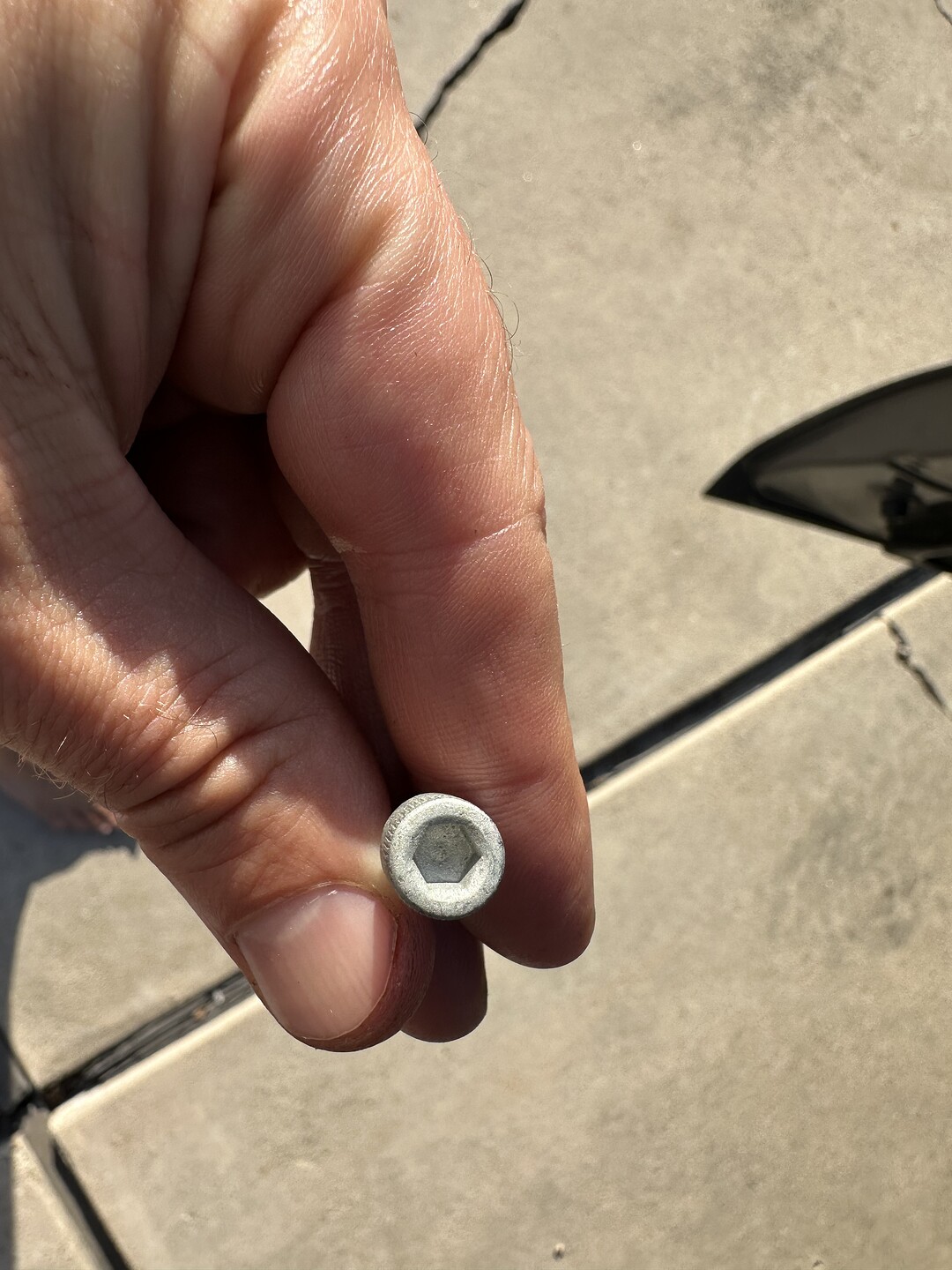

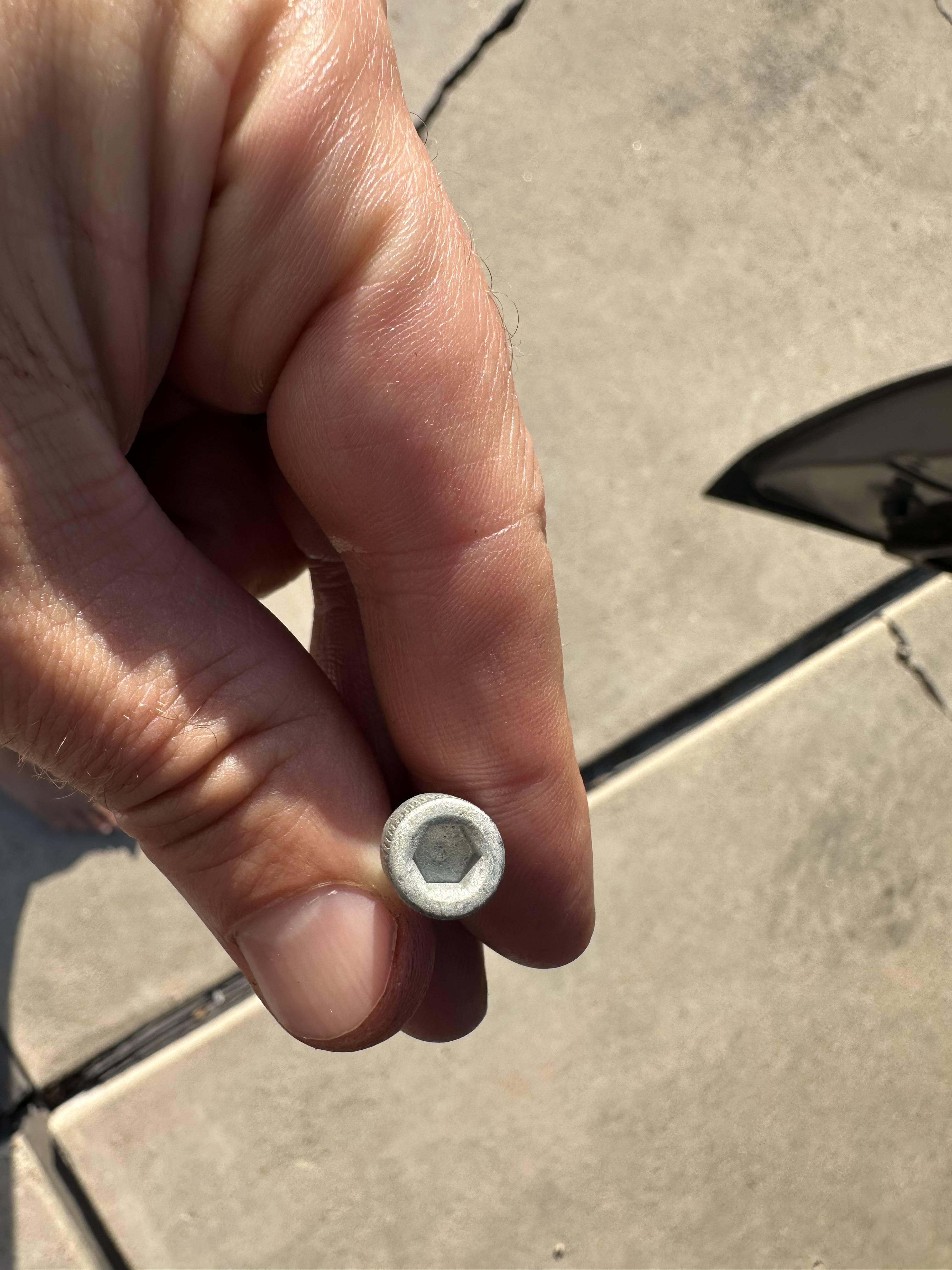

Help, I was an eager beaver and used my impact driver to install drip rails. I stripped the A574 bolt that is supposed to be hand tightened into the T nuts. Who has a solution for extraction?

Thanks @Semi - it’s the bolt compatible with the T nut. Photos attached.

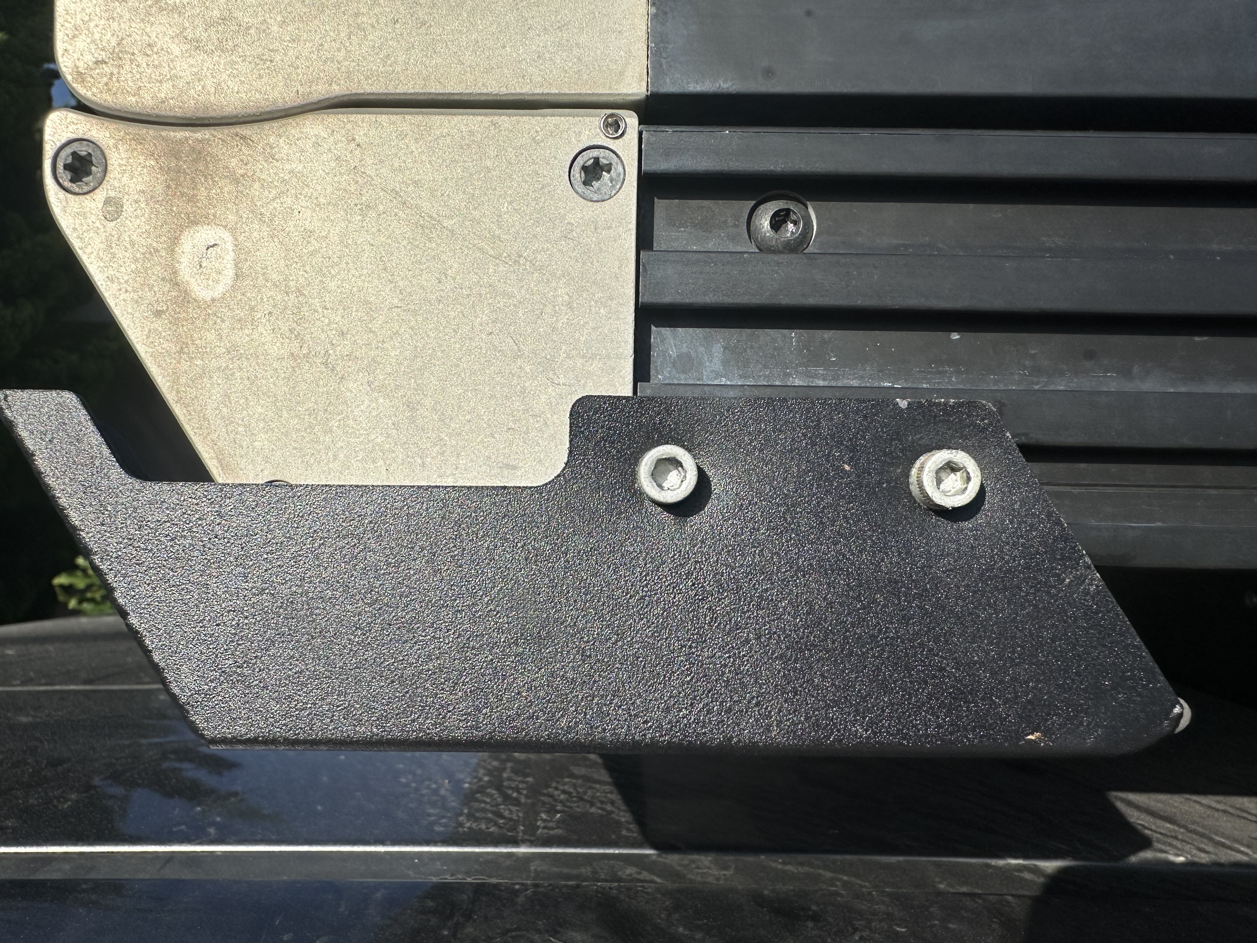

Once you get them out the DripRails should be mounted in the upper track. They will catch too much wind in the lower track and will crack over time.

Likely the A574 is a manufacturer stamp for the bolt part number or for the coating, it’s not really a bolt description. The bolt is a 1/4"-20 socket head cap screw 3/8" or 1/2" long (hard for me to tell in the picture). A very standard size.
It may be a big contributor to the bolt stripping is the quality of the hex wrench you were using. Most brands are pretty soft, and the corners start rounding. I highly recommend getting a high-quality set such as Bondhus, you can find some reasonably priced sets online.

Wera Hex-Plus keys bite into a damaged head. Knipex TwinGrip pliers will grab the exterior as well as anything, and better than most. If you have to drill it, add a little oil to the bit for better results.
