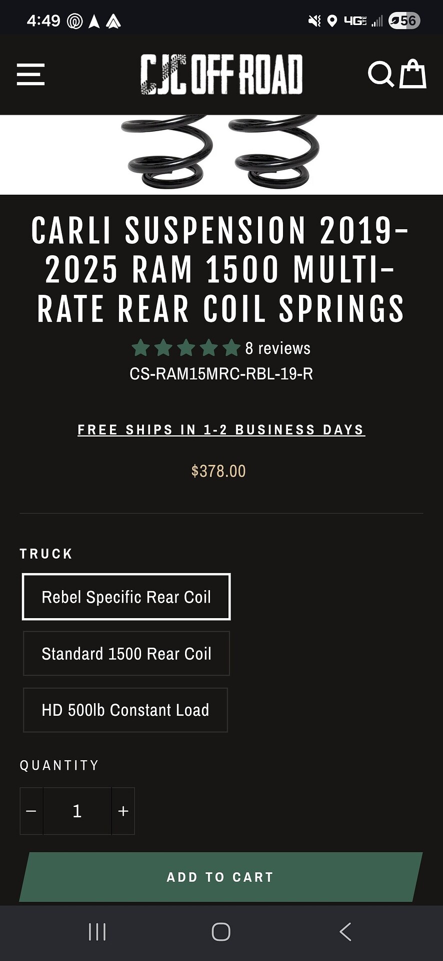

@ws6616 just to make sure, I would want the HD 500lb Constant Load springs for the camper, right?
if you have front end lift or using the Rebel front suspension (aka, 1” compared to standard), then go with that.
if not your rear end may sit a bit higher even with the load, but that sounds like what you’re looking for? hahaha sorry I forgot :rofl:
