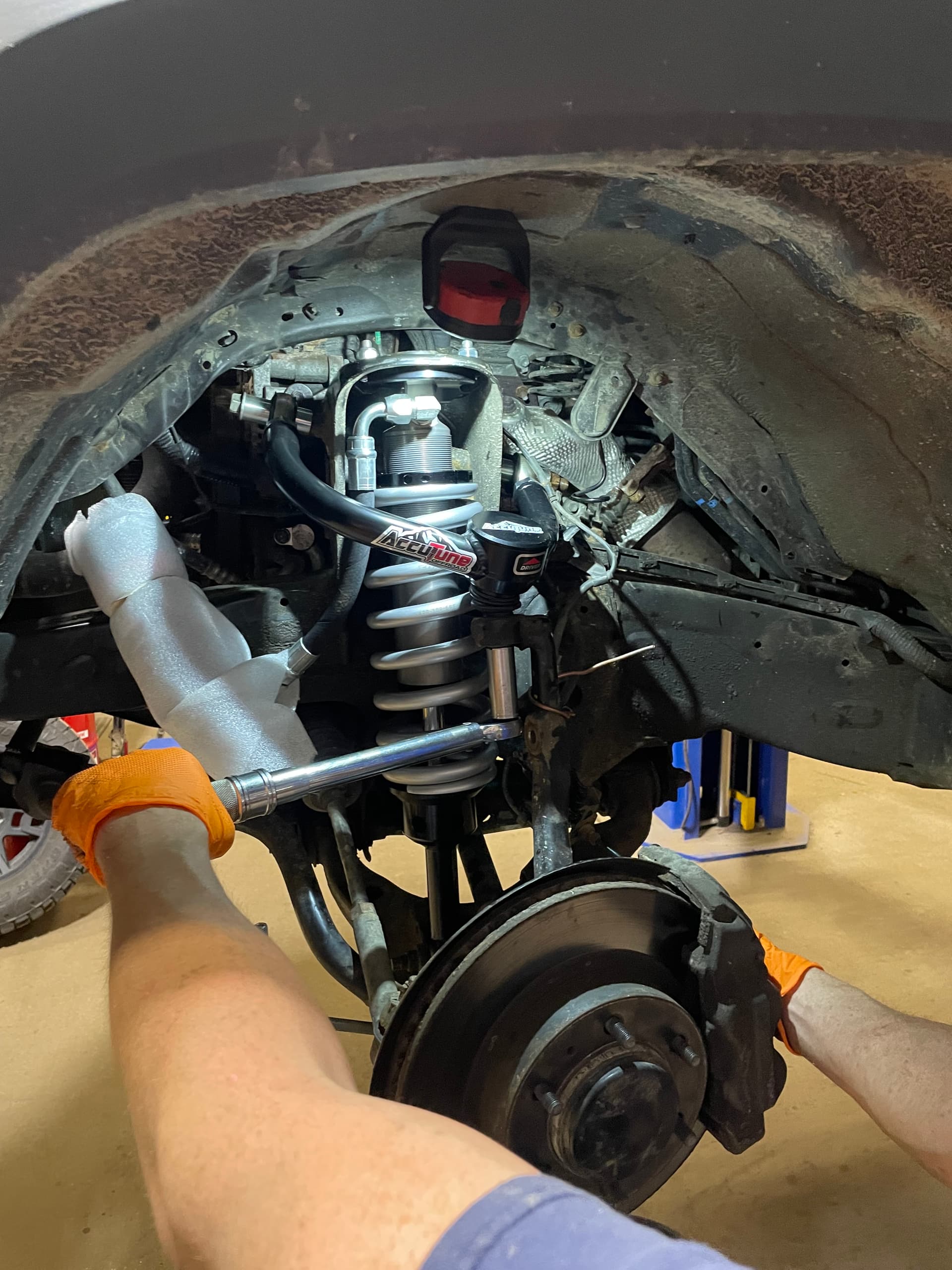

I used Accutune Off-road to build a mid-travel setup that was perfect for my needs. I recommend them to everyone that asks about my suspension.

Depends on budget and planned use. Are you a go fast dirt road bomber? Different setup than what my grandpa style driving needs. Accutune was on my list too - they weigh the truck and tune accordingly for your driving style and weight.

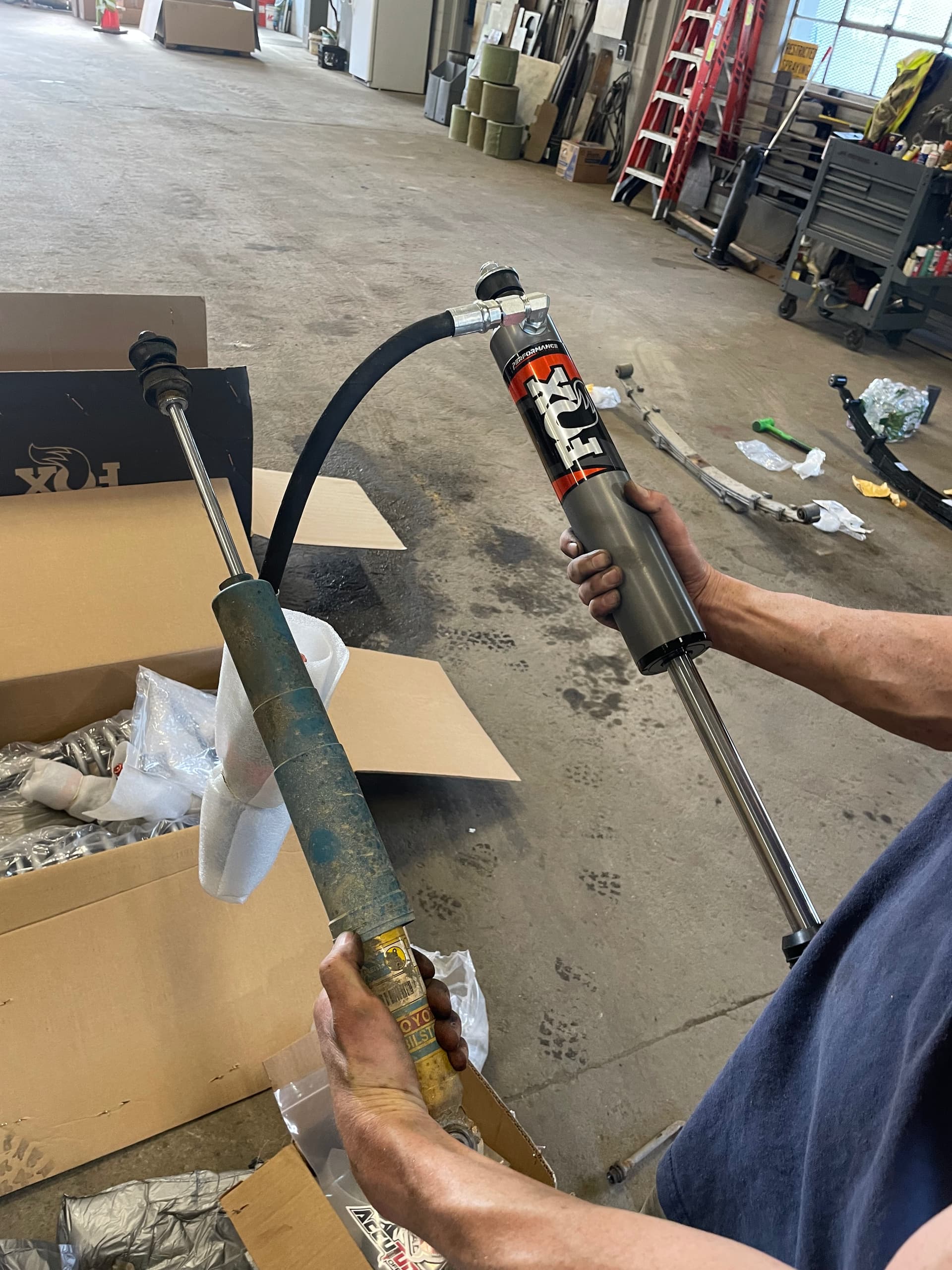

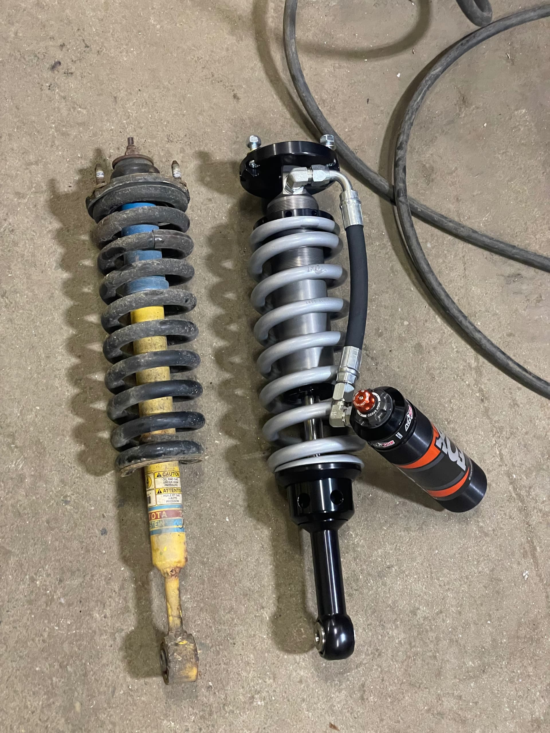

I also started with the Sumo blues. My camping gear for a 4 day late fall/winter loadout weighs 266 lbs (water excluded). Add the GFC at 275. Was always sitting on the Sumos. Without gear I had ~3/8” travel to the Sumos. Felt like driving one of those clapped out spring cut civics with the folgers can on the exhaust - bouncing off the stops.
My requirements were: #1 - Had to fit in the garage, so 1”-1.5” max. Didn’t want to loose droop, again 1" max, wanted some rake when empty, almost level when loaded. Mine is a manual, and I don’t want to regear, so 33” tires are out - also see #1. I don’t enjoy rock crawling, I mostly drive USFS roads since this is my camping rig. Watched the WheelEveryWeekend/Overland Outfitters Shock Value series.
Those were my “use case” requirements. I super wanted the All Dogs OffRoad parabolic springs, but the lift was too much. Went with Ikon RXT Stage 1, 5100’s all four corners, Perry Parts bumpstops front, kept the Sumo blues as bumpstops in back (they are super plush). So much better ride on and off road and no loss of manners. Still have my front sway bar.
