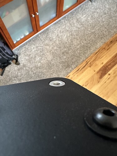

Did a test…
Added nylon washers around each tnut and now it feels solid as a rock!
Still has a space but I guess unless I counter sunk that’ll always be there.
Forgot to add pics.
Thanks everyone. Got it done.

Ideally, a countersink in 1/8th of an inch in the 1/4 inch aluminum brackets would be the trick I just 1) didn’t have a countersink drill bit and 2) didn’t know what size the inside of the TNut would need to be drilled.
