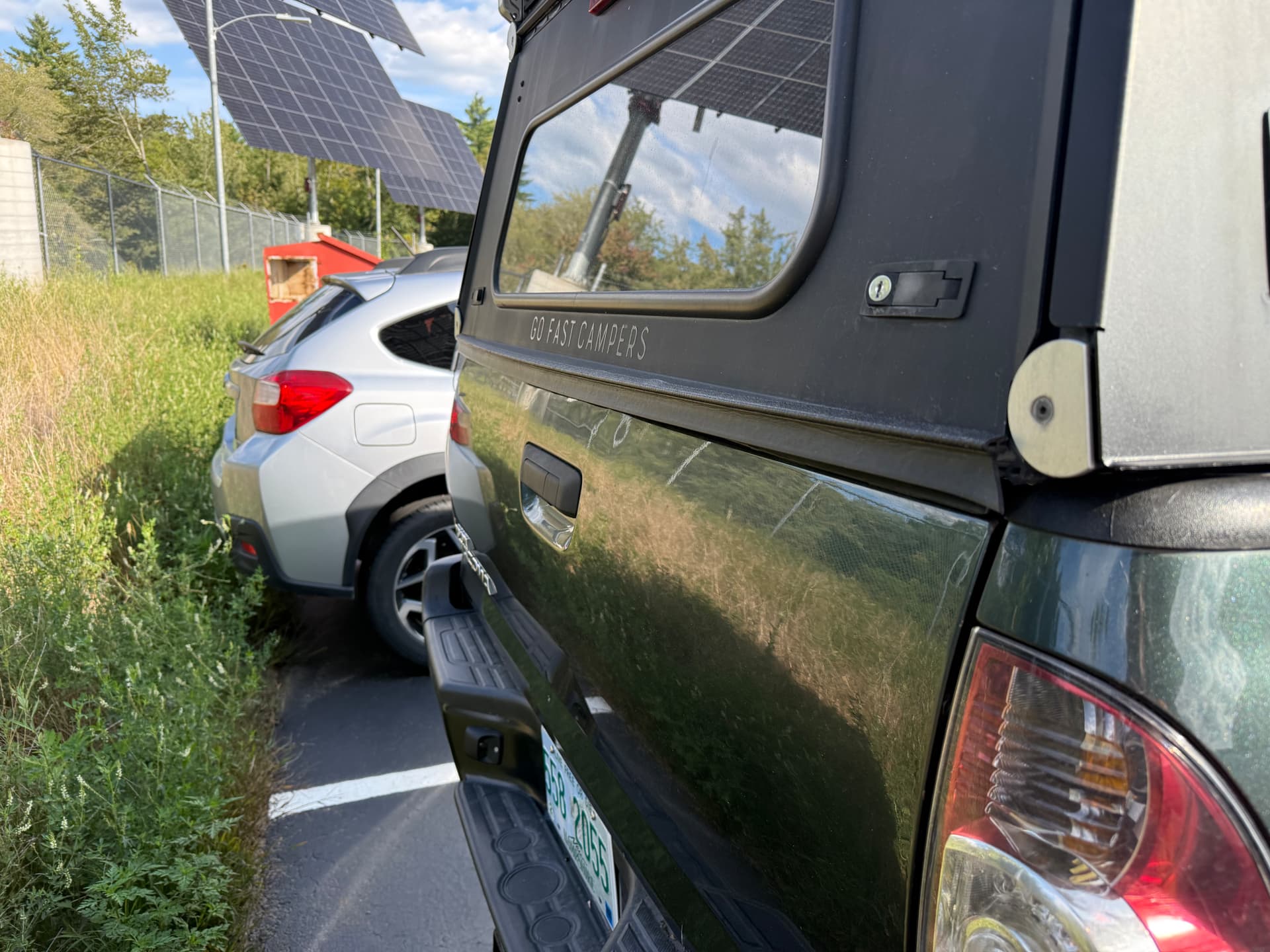

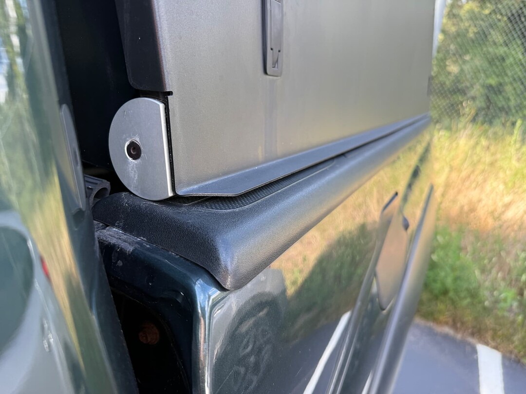

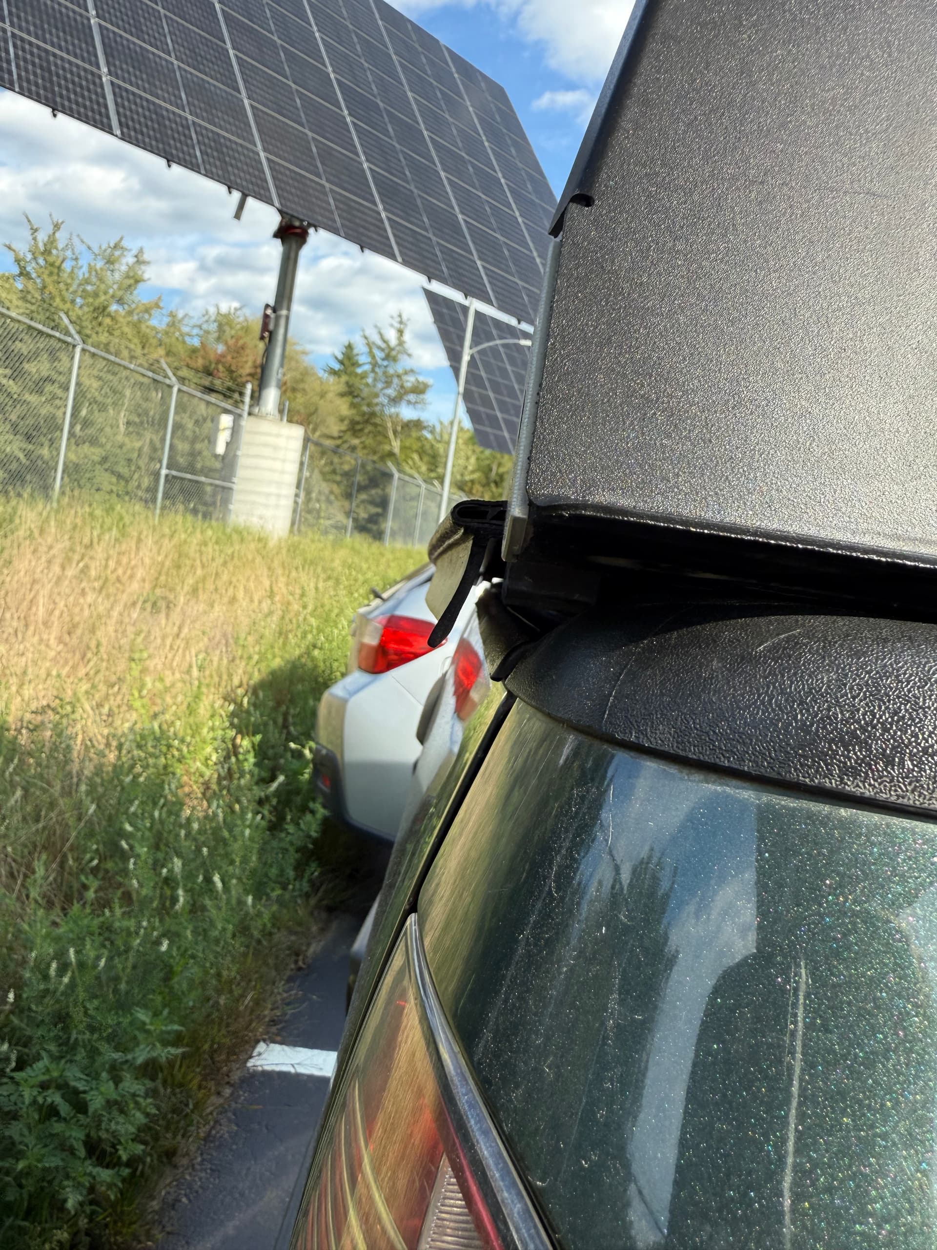

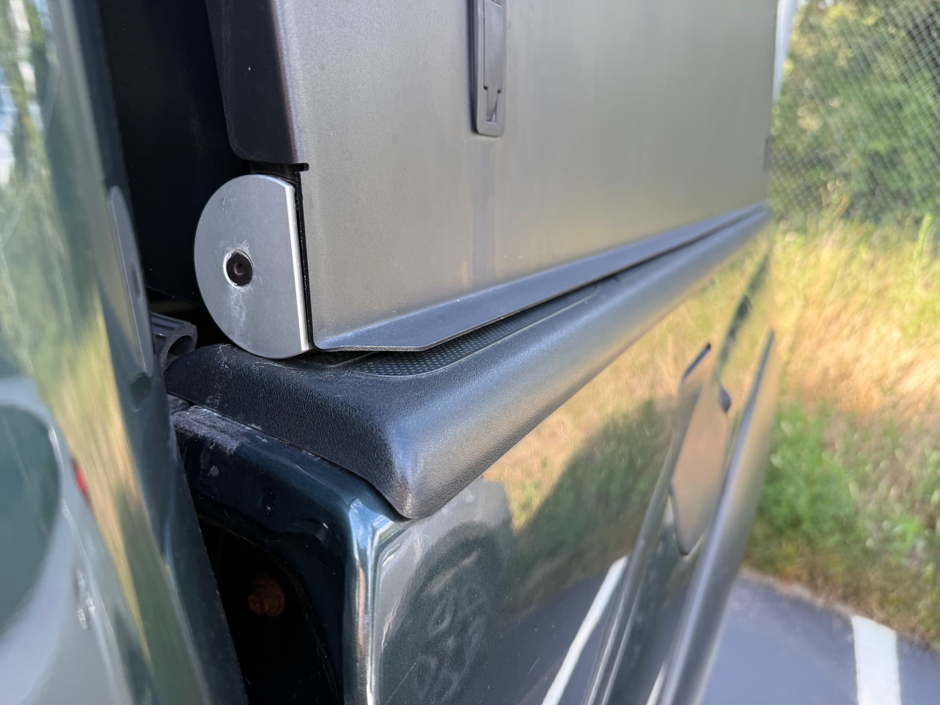

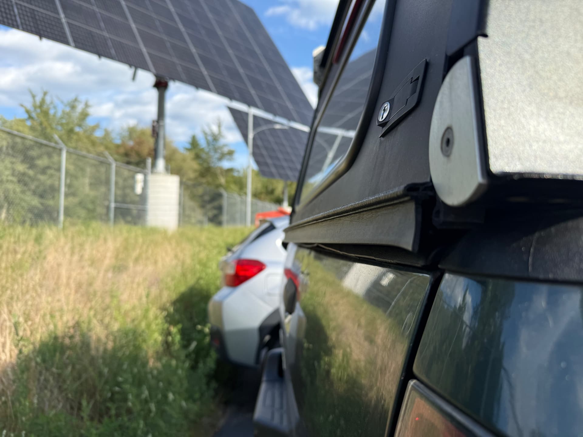

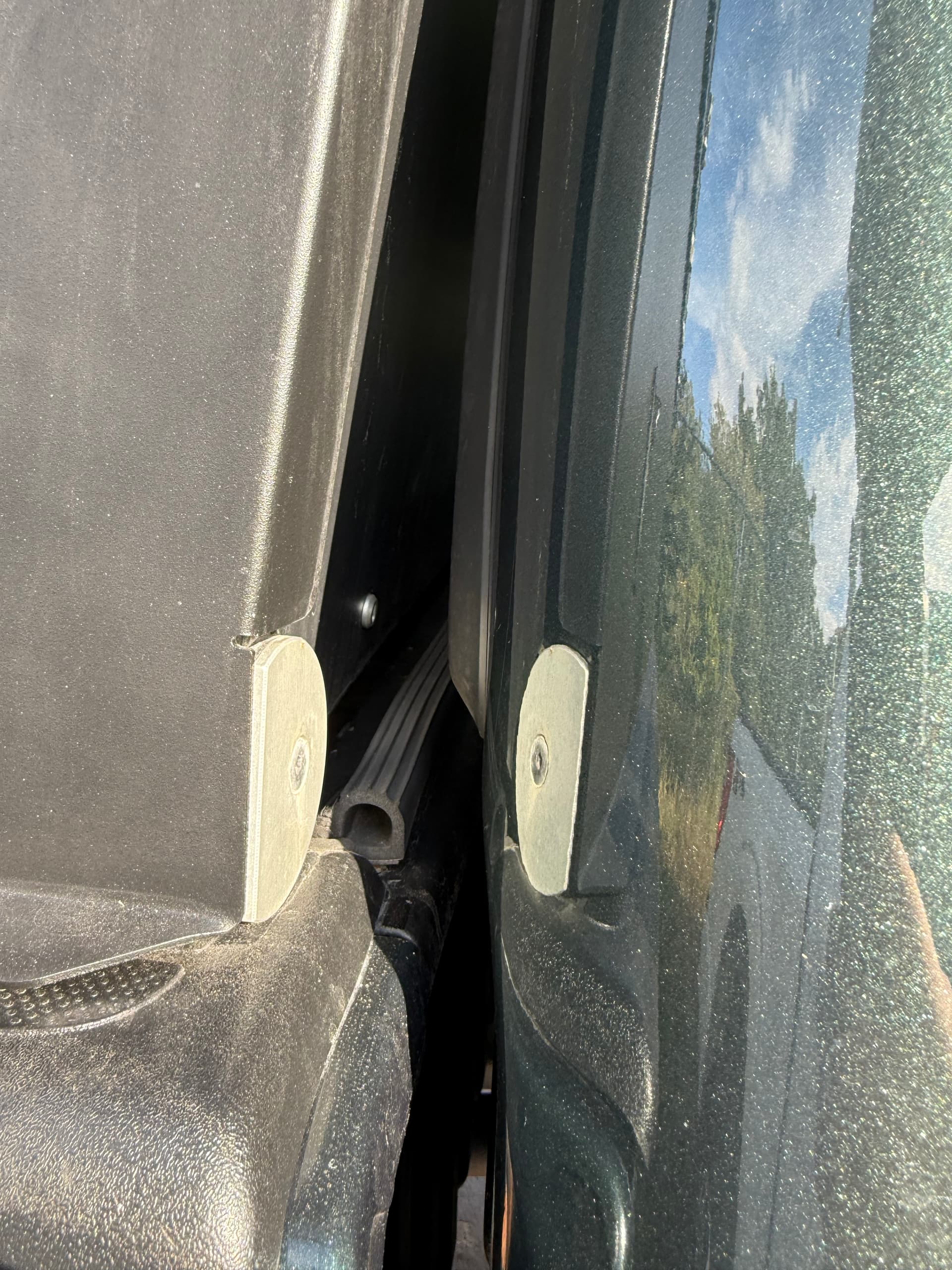

Got some pictures of it today. The worst gap seems to be at the bulkhead.
I have a V2 Pro meant for a 3rd Gen on my 2nd Gen and it works. The gasket/seal on the back hatch panel needs to be modified but otherwise no issues.
