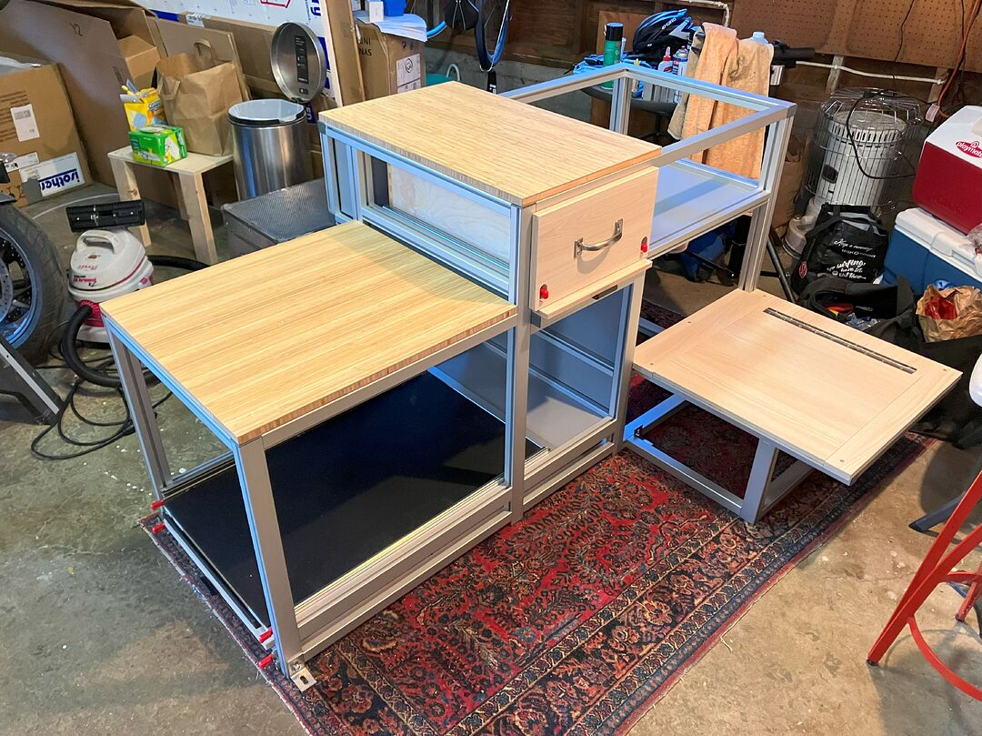

Making progress on the GFC Camper Mod. The cabinet is designed around the ARB Zero 47 which, while pricey, is a great fridge. The fridge tray as designed will hold the Iceco VL45ProS which is considerably less expensive than the ARB, has slightly more volume (one more liter), and has a Secop compressor. It’s a great fridge for the money.
Section view through the cabinet. Note how the fridge tray extends forward to allow the fridge lid to open completely. Slot at the bottom in back is for the fridge power supply. We can put a panel on the top of the cabinet if someone wants to use it as a standing height countertop/desk. Also the top drawer can be reoriented to open sideways into the camper instead of out the back.
The short bed version has a shorter cabinet (33” instead of 36”), reduces the outdoor kitchen length by 2”, uses the cabinet cubby for table storage, and moves the Lagun table mounting bracket to the side. Fridge and drawer dimensions stay the same as the long bed version.

I have a piece of camping furniture originally designed and built for a Super Pacific owner (Tacoma long bed). I’d like to offer it in its current or smaller size to GFC owners. The price is $4250. Here’s a vid: https://youtu.be/mUSD69mZk6c?si=S_p3r3vEhS6mgGau
For the same price, I can custom modify it to fit a short bed and/or a smaller fridge. As shown it fits a 75L Dometic. The storage bench with hinged top can be removed.
