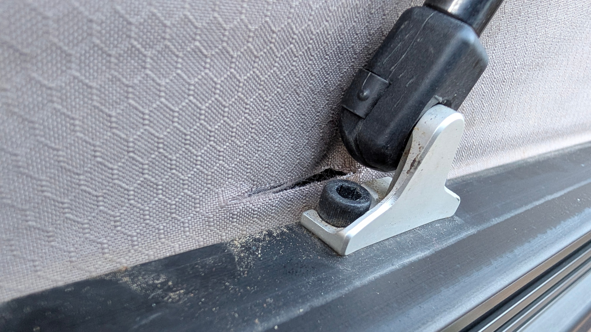

I was replacing my gas tent struts and had removed the locks on the top and the bottom to pop them out of the sockets. I was pushing towards the rear at the top of the strut and hit it with my hand to pop it out first. To my surprise, the bottom one came out first and and tore the fabric. I’m entirely sick about it.
What’s the best way to go about repairing this so it doesn’t continue to tear, yet along let water in? Should I take it to a repair type place, but who does this kind of work? Would the GFC iron on patch kit be enough to hold things together?
