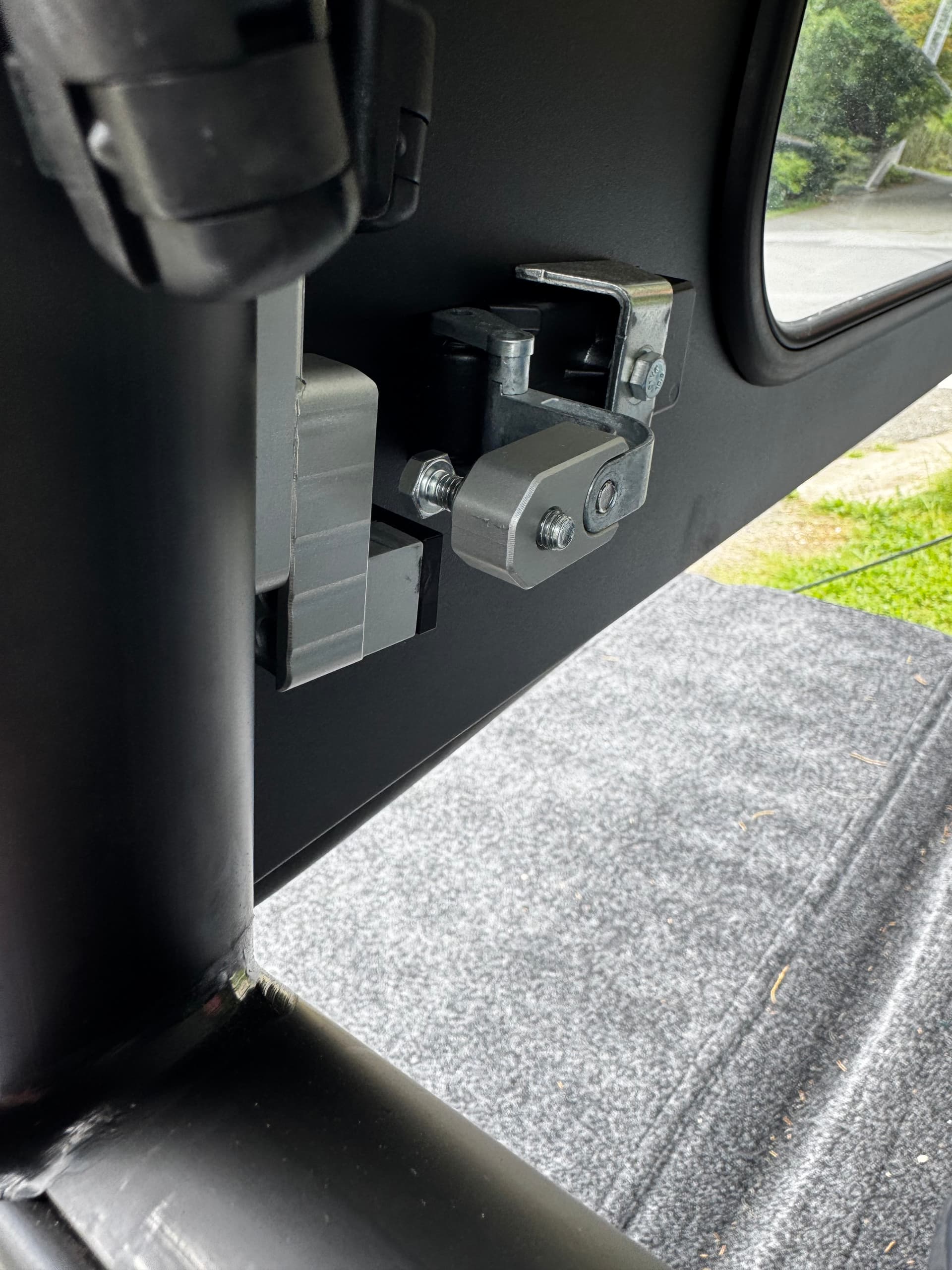

Picked up my V2 Pro camper a couple of weeks ago and just discovered that when the rear panel latches are closed they don’t actually catch on anything, so the panel can’t be locked. Looks like latches are misplaced. Has anyone else encountered this issue?
See that silver tab on on until left? Slide it upwards.
This is so you can lock the latches but still exit from inside by pulling the tab down like is currently shown in the pick.
Thanks! It would have taken me a while, if ever, to figure that out.
It’s so you can lock yourself inside at night. You lock the panel, climb in, close the panel and then slide the locking tabs up.
Yeah, it’s a great feature.
