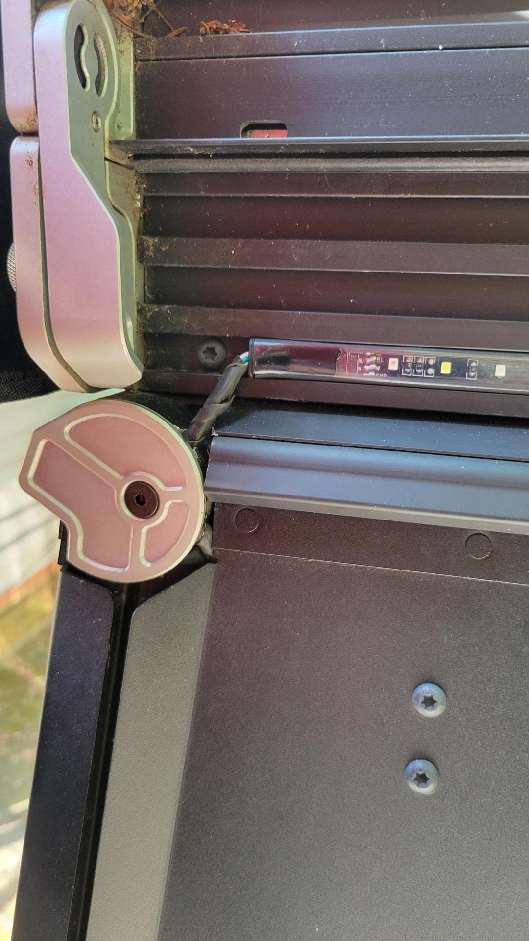

i’ve been putting off wiring mine, the splice kits are rather janky. is there a wire harness that plugs into the 4 pin trailer harness that gives you just braking? or possibly a smarter 3rd brake light that can plug into a 4 pin and replace the stock 3rd brake light on the camper?
Diode dynamics and I’m sure many other companies have brake light wiring harnesses that are plug and play with either the brake light or the trailer connection. If you want to go that route should be easy to use one of those to get you up and running.
Pretty pleased with this solution, a cheap 48’“ flexible tailgate lightbar fits snugly into the T track of the camper. Have a 3rd brake light, turn signals and reverse all plugging into my 4 pin trailer wiring for $13.51. Drilled holes to bypass the hinge of the rear door. Feels more elegant than the splicing kits for just a 3rd brake. Any tips on what to put in place of the GFC 3rd brake light, there are three holes in the alloy panel?
