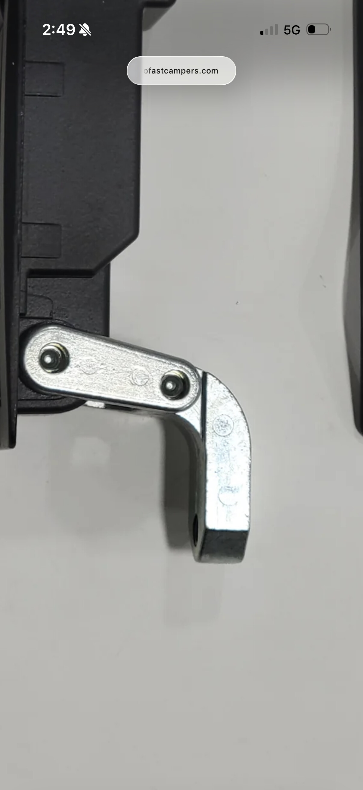

Mine looks like this lol. Didn’t even come with a tension screw…
shoot! Contact customer support this should be an easy fix.
