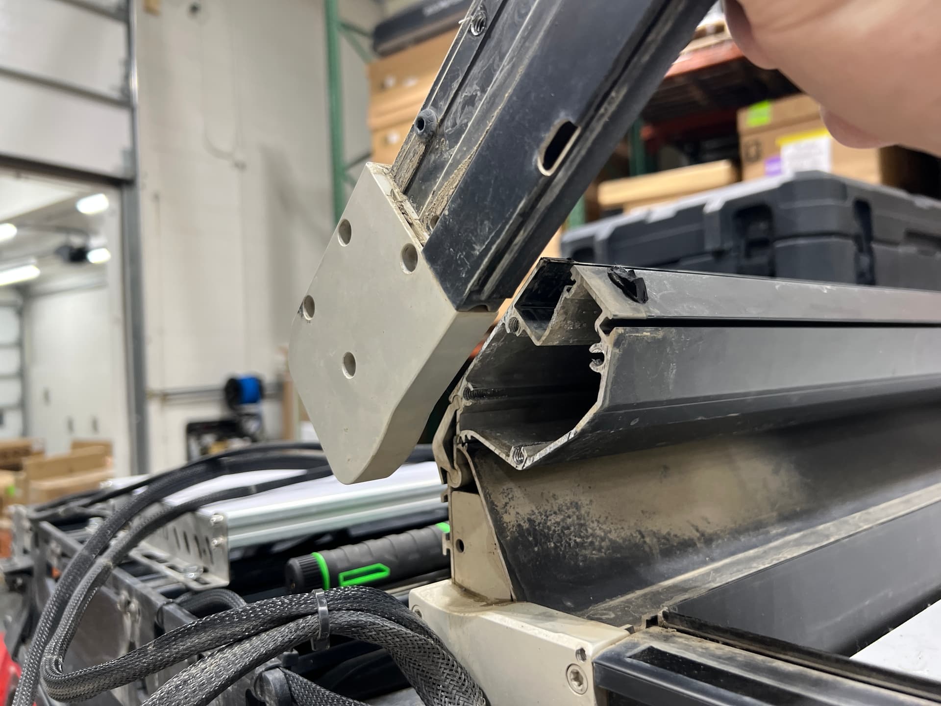

So far so good. I had the older keeter rods that were the flexible green plastic and god damn they were a pita. I ended up having to remove one of the side blocks to get the last rod out but again the bolts came out without a fight after a little heat.
Thankful to have access to my jobs shop to do this so I can just leave it disassembled overnight and I don’t have to do it all at one time.
Can confirm the last keeter rod took as long as everything else combined. Royal pita. Ended up having to take the entire rear bar off so I could thread the rod into the tent. That one part is enough that I’d have paid a shop to install it for me but given it’s a 4 day drive to the nearest shop I’m glad I did it myself.
