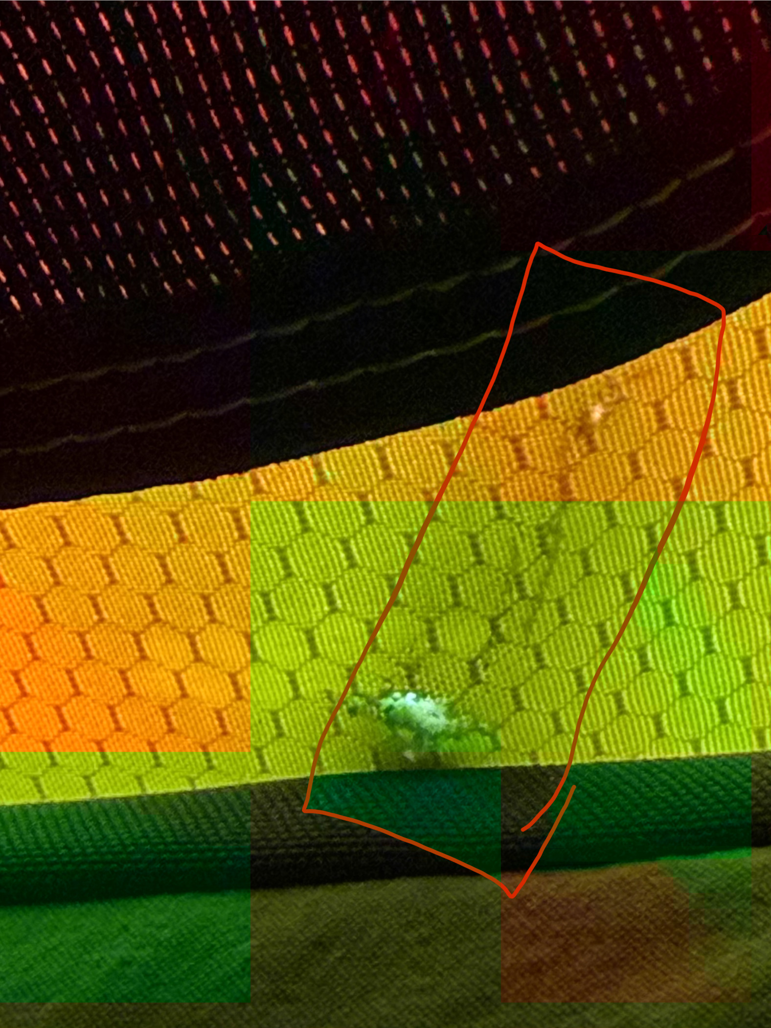

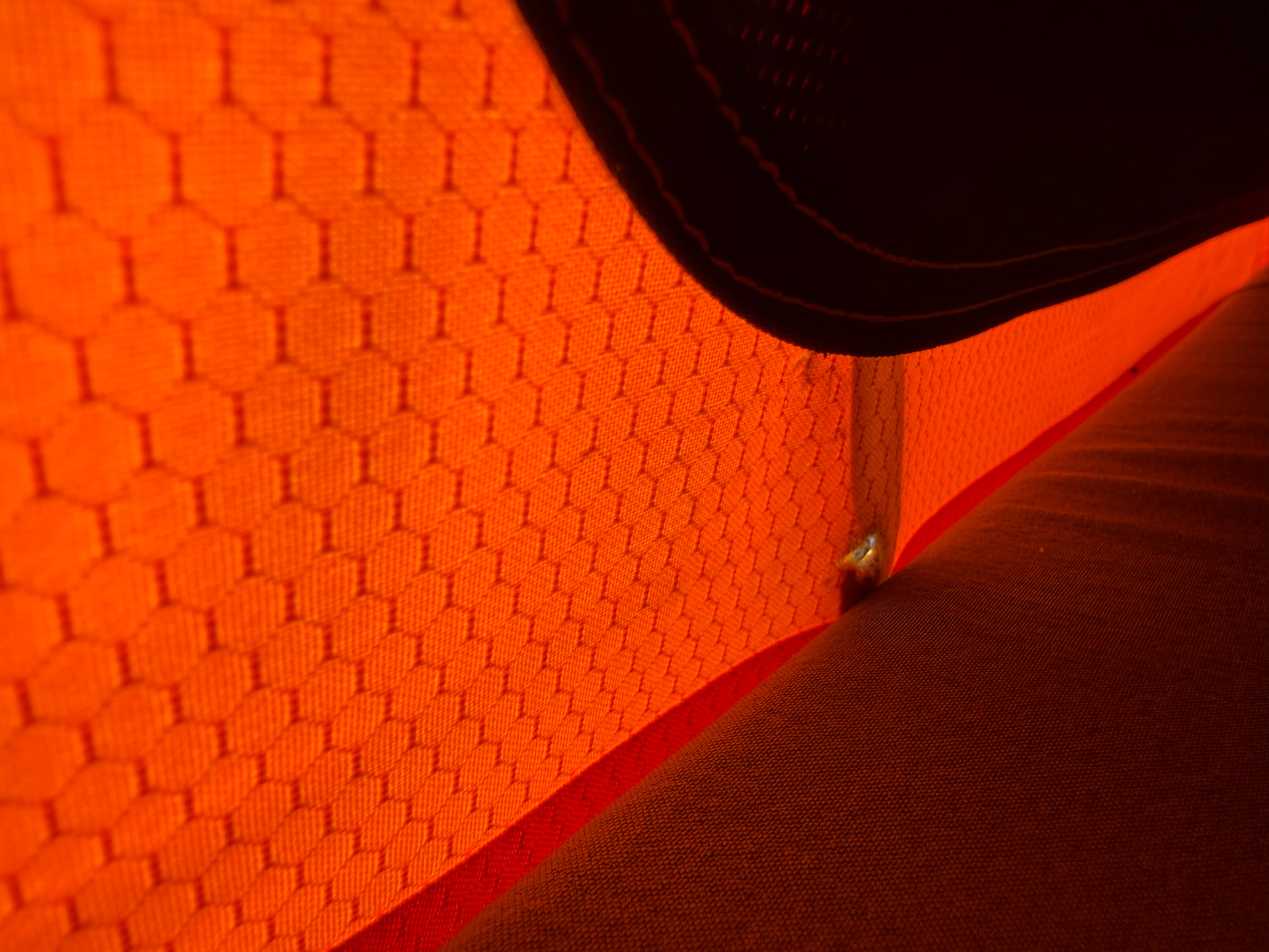

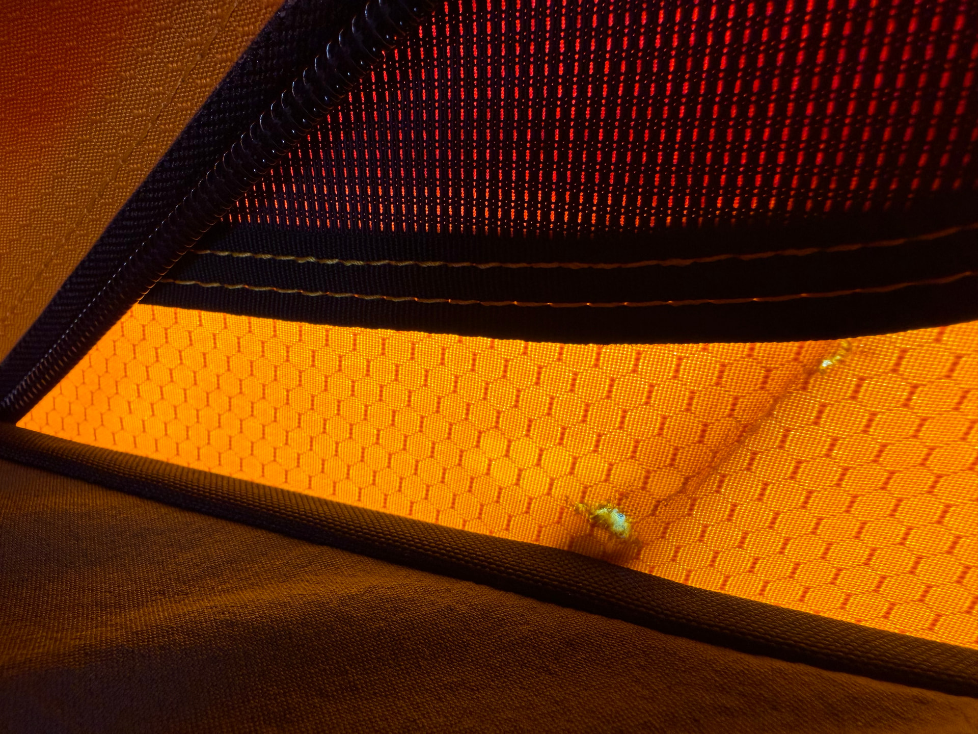

I received my V2 MAX in April of this year. After only about seven nights of use, I was surprised to discover holes beginning to develop in the tent fabric on both sides, directly along the areas where the struts contact or run alongside the tent material.
I contacted GFC warranty expecting them to investigate what appeared to be premature wear. After some delay, I received a response that honestly surprised me. In nicer terms, I was told this was essentially “operator error” because I was supposedly stacking the sleeping panels/shelf and bedding incorrectly.

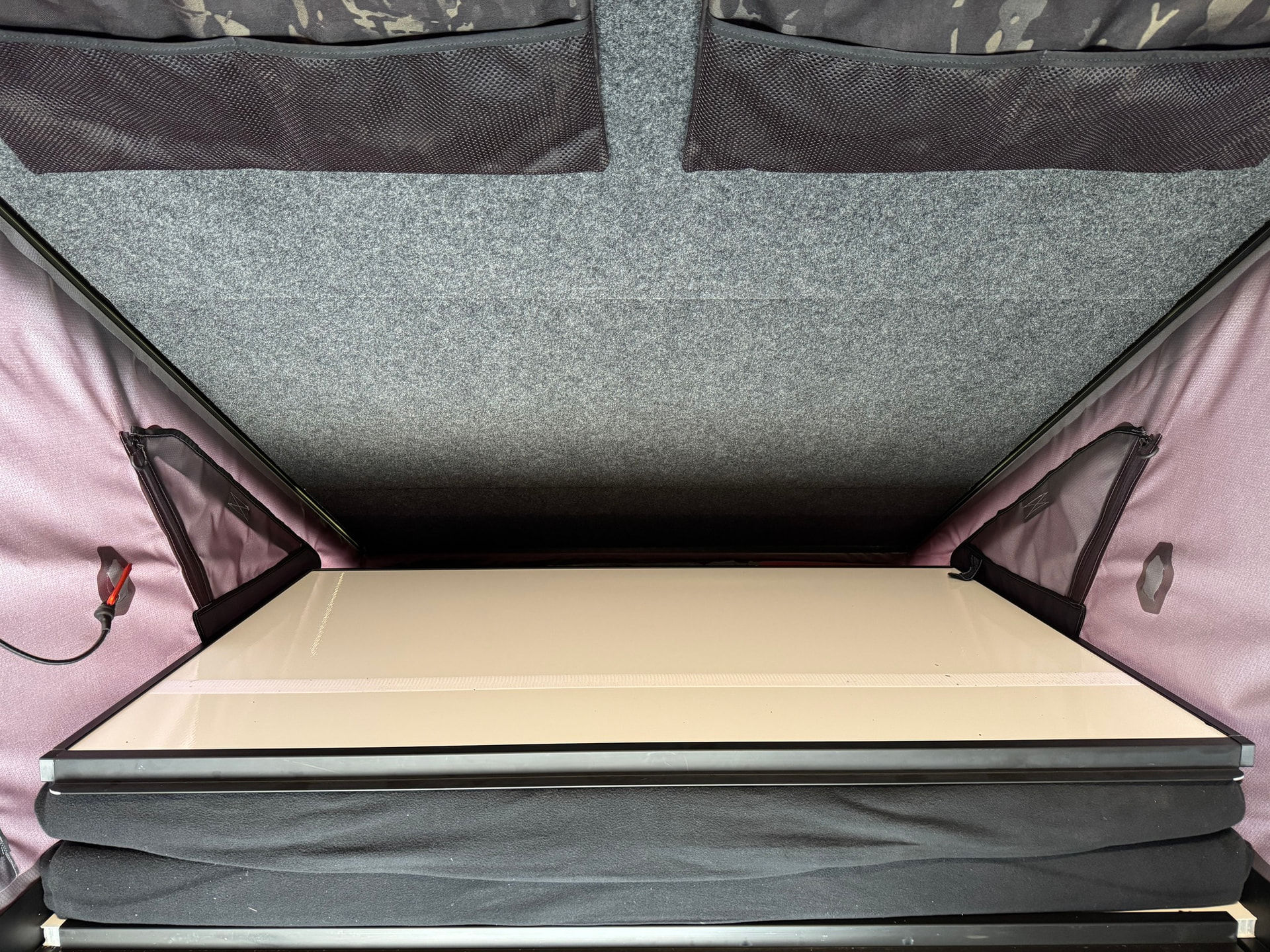

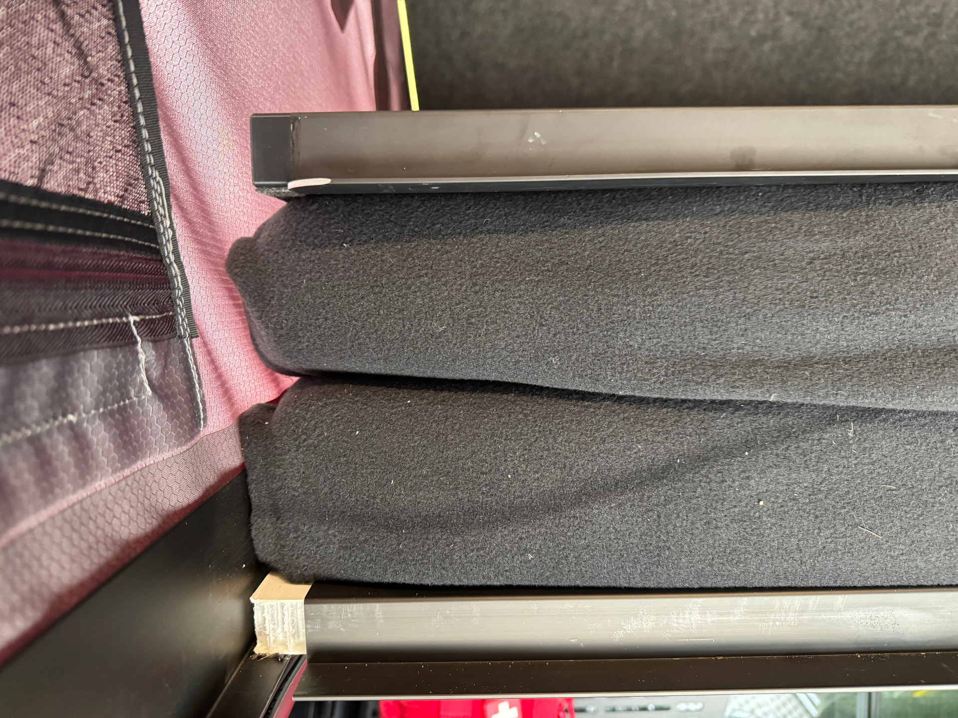

GFC sent me photos showing the “proper” way to stack the bedding and panels. I have a few major problems with that explanation. (attached)
First, if stacking the sleeping panels or bedding in one particular way is so critical that doing it differently can cause holes in the tent after only a handful of nights, that should be clearly communicated to customers when they purchase and take delivery of the camper. I certainly wasn’t made aware that the tent material was this susceptible to damage.
Second, the wear pattern doesn’t seem consistent with their explanation. As the photos show, the material is wearing along the length of the strut, not simply at the location where a rigid portion of the sleeping surface might contact the tent.
To me, this points to a design issue rather than misuse. The tent material should be reinforced on both sides of the tent wall anywhere the strut can come into contact with or rub against it. A premium camper designed for repeated setup, breakdown, and off-road use should not be developing holes in its tent fabric after approximately seven nights.
