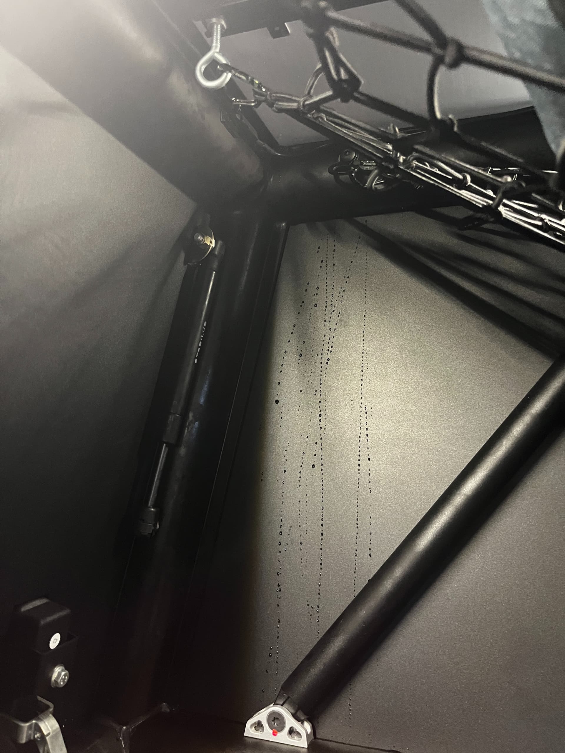

First significant rainfall in the V2 pro and unfortunately the water intrusion was significantly worse than expected. I did a pretty good job sealing under the bed caps, the front corners, and the tailgate so those areas actually performed better than expected. All three of my panels leak and I’m getting water dripping down from the bed area in the corners. Anyone have any tips for sealing the leaks on the front solid panel as shown in the picture other than just pushing a bunch of butyl tape along the seam?
Had the same kind of leaking. I used black RTV or similar and went around all the inner edges of the panels. Haven’t had any issues since.
Gave this a try. We will see how it holds up with the next rain. This is what GFC support recommended as well. Kind of a bummer to spend $9k and then have to seal 5-10 different locations on my camper. I was anticipating the camper to bed interface challenges but the amount of leakage from the camper itself was unexpected. I had multiple locations at the corners of the panels where I could see daylight after picking up my camper.
Yeah I just noticed today that my upper corners in the front still leak some. I’ll through something in those joints to seal them up too.
