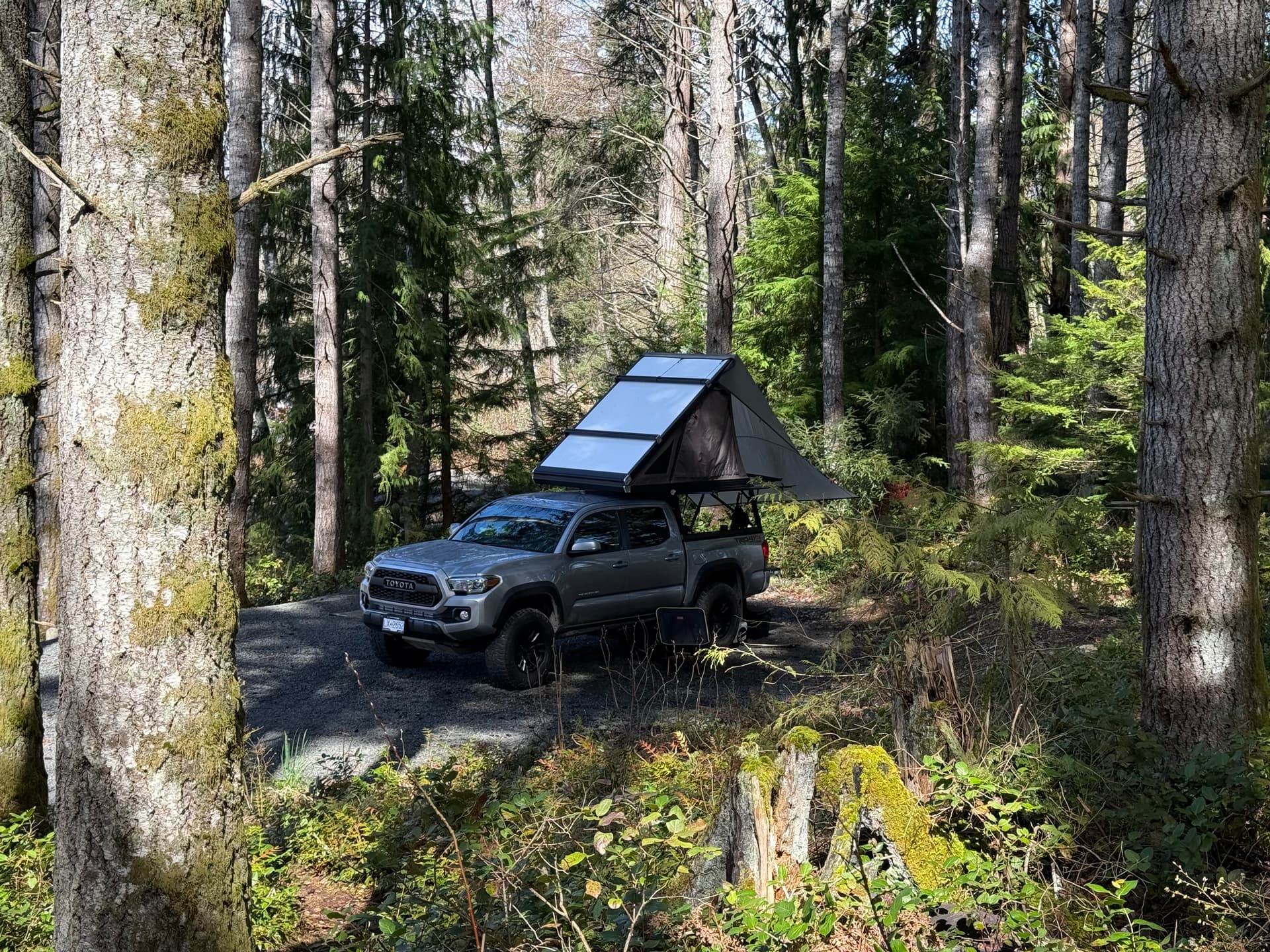

My fix for this is to mount a siltarp on to my roof see photo. This works well for keeping the tailgate area dry whilst camping.
