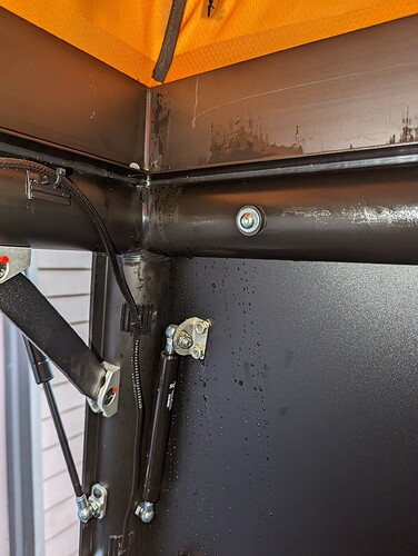

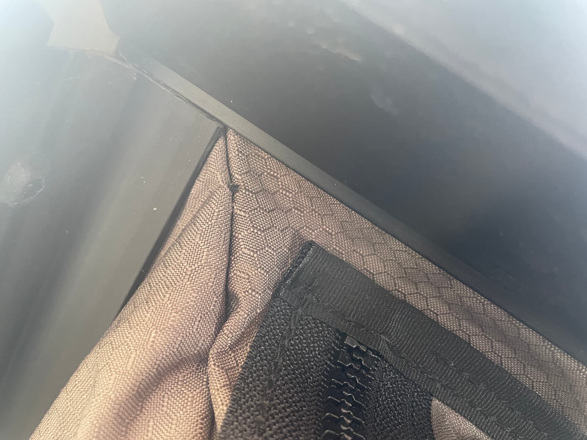

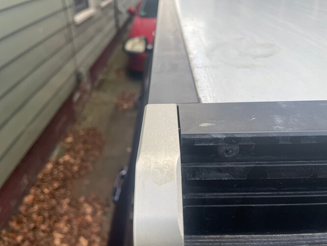

Update on my tent (picked up April 21, 2022). GFC sent out some more bulb seal for the corners, but doesn’t keep water out. I had some sand on and around the roof of the RTT after a trip I took a couple of weeks ago and noticed it inside the tent after the next rain.
It appears to being entering from this interior corner (rear, driver, upper corner). I’m going to search for some silicone-type material and seal up the gaps on the roof of the tent.

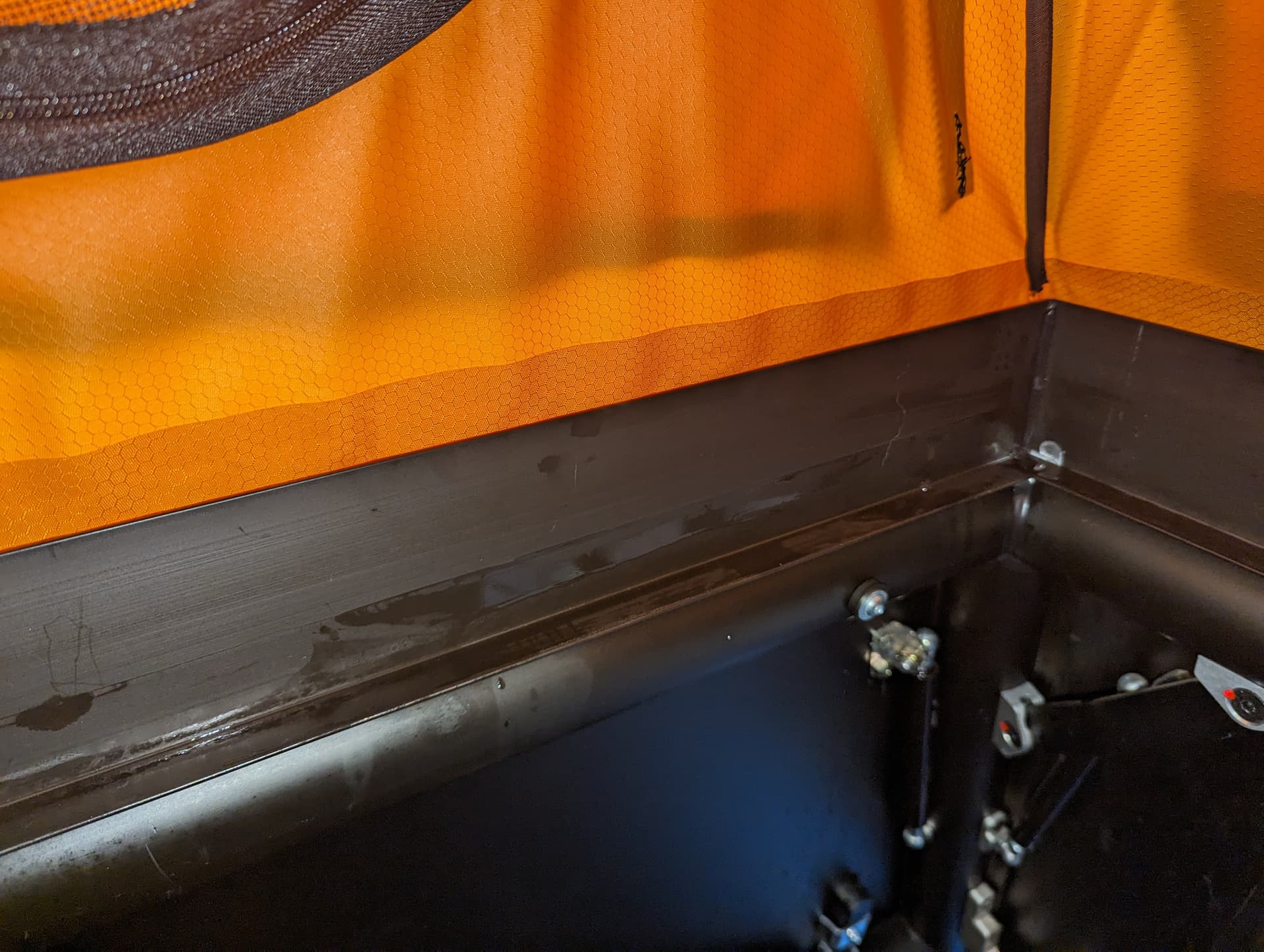

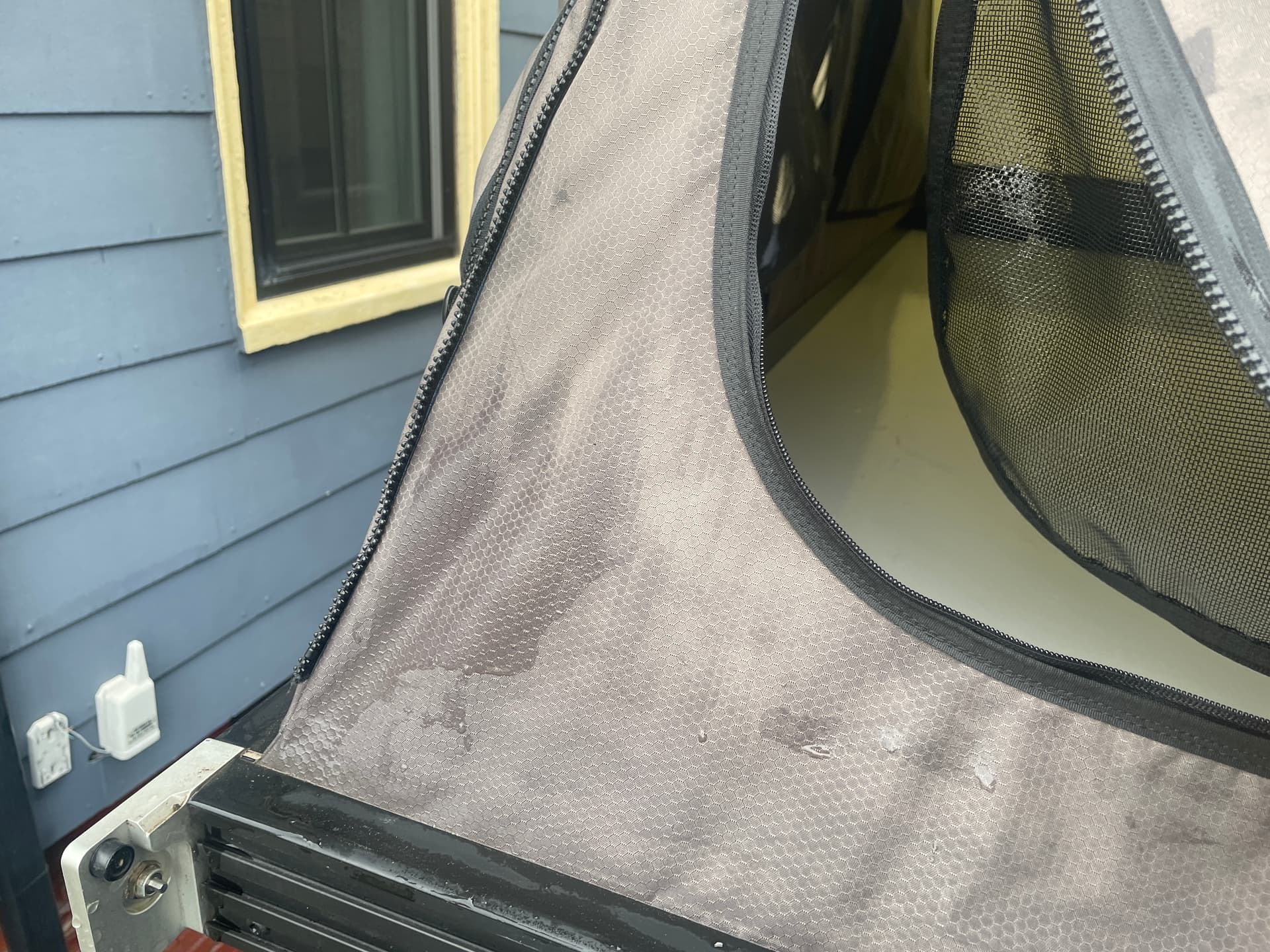

I deflate it completely by rolling it up and then laying it flat again, then check that there isn’t any bulging on the roof and the side rails are nice and closed. The pictures I just posted of the empty tent are from this weekend and I had nothing in the tent - learned my lesson…
The wet mattress was from the rain we had about 3 weeks ago. I’ve removed it until a solution is figured out. GFC is painfully slow to offer support. about 2-4 weeks between responses but I also have to wait for the rain to test any changes.

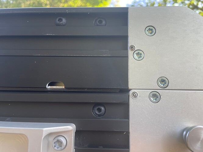

I just went out and bought some more flex glue and am planning to fill these gaps in the roof where I believe water could be intruding, although I’ve been told by GFC these gaps are intentionally left open and water shouldn’t get into the tent from here.

That’s hopeful to hear that there are tents that don’t get wet - this was my assumption all along that this tent I have is an anomaly. @phantomchameleon would you be willing to take and post some pictures of the these locations so we can compare builds?
I have build #1670 and haven’t had any leaks either. I can try to get some pics for you
Yeah, I will try and get some photos in the next day or two - getting ready to travel for Christmas so things are kinda crazy but should be able to take some photos!

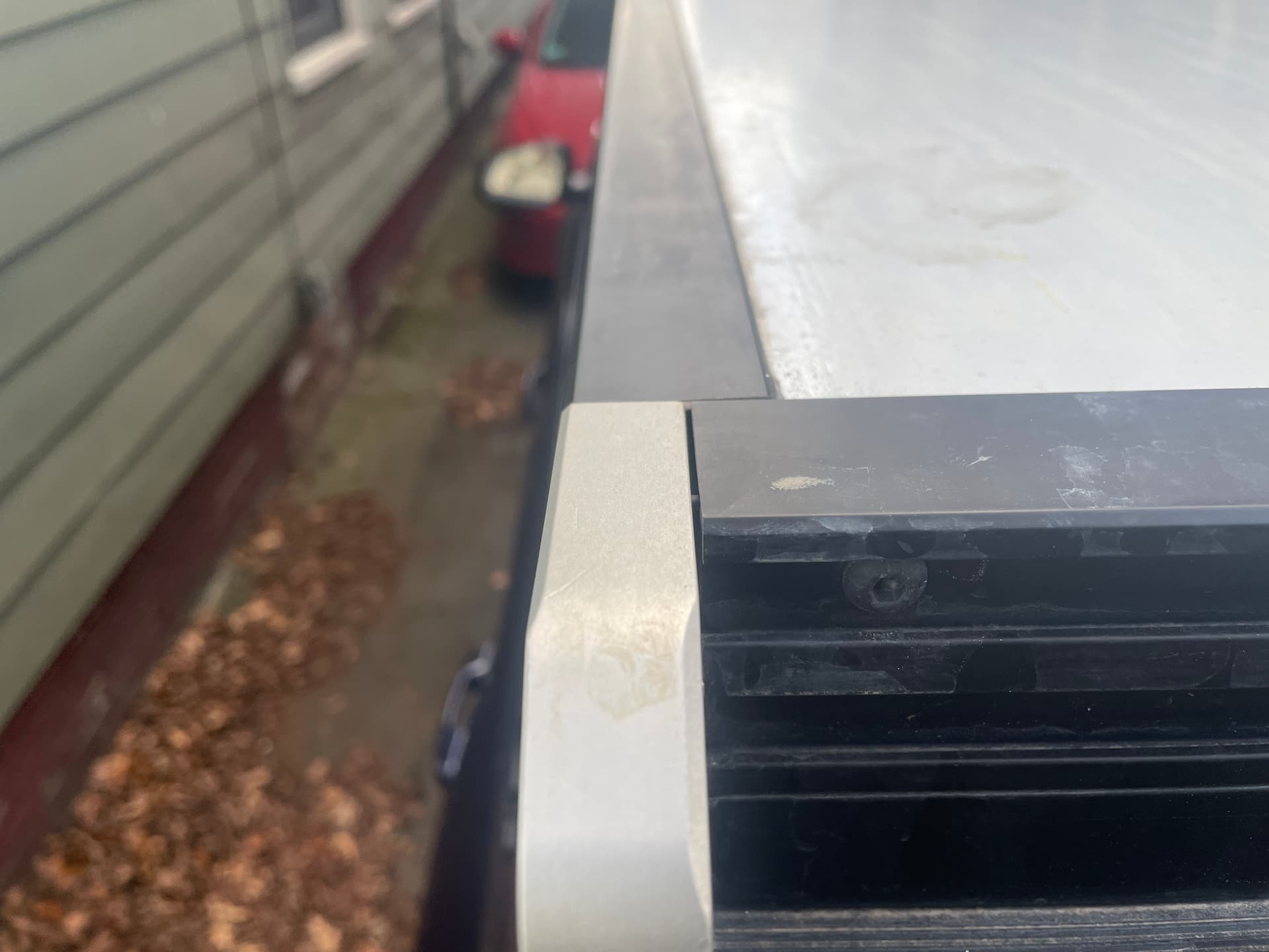

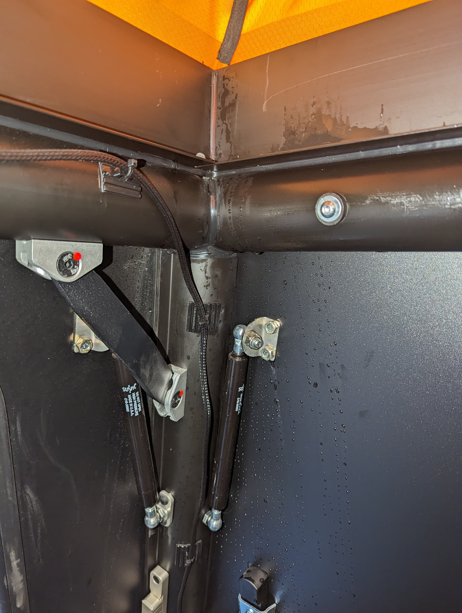

Checked out the camper after the horrible Portland weather to find some water inside. Tent seems to be pretty dry but back corners are definitely leaking. Build #3684 which should have all the weatherization updates. This is the first sign of water intrusion so far.
I’m also in Portland. I haven’t checked with the recent rains but would be happy to show you the GFC directed sealing I did on mine to see if it would make a difference for you. Last time I checked a few weeks ago it was dry. Build 2868 for me.
I’d definitely be interested! I’m planning to open up a service request once they’re back in shop and I’ll follow up.
