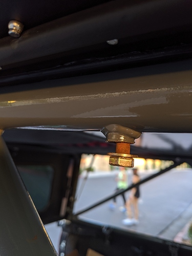

Also, as I theorized above, my frame is rusting internally, the bolts are corroded and the inside of the tube looks similar.

On the rusting they do recommend rust inhibitor application every 6 months to be fair. But that is a good amount of rusting. I live in rust belt and went through most of last winter without much issue other than that front tube. I’ve had to remove those bolts a few times and saw no rust, yet I saw some water fall out of the tube.
how is water getting into that space?
Some of it I think I was from the resealing process as it was black and as I understand water is used in the material/curing process.
As for the moisture and the resulting rust… Dunno, I’m in SoCal, moisture isn’t really an issue here.
