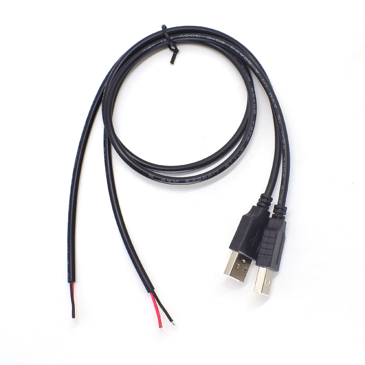

If your devices are 5V, just use a regular USB-A connector and use your sherpas USB-A ports.
