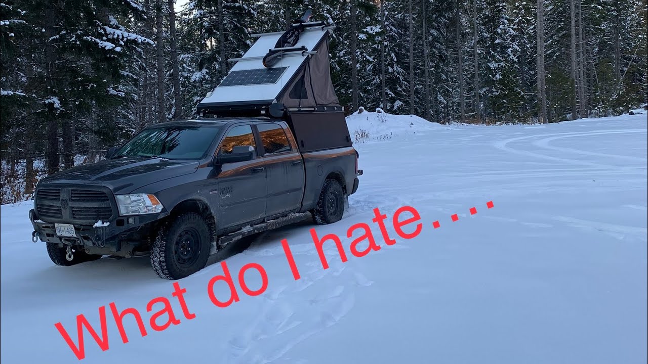

Cross posting, but I’m ok with that. Here’s my 1 year review!
GFC V2 - 1 year Review!
