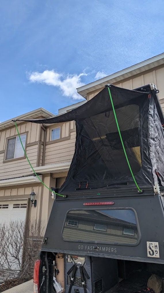

Ok Peeps - Finally got my printing woes resolved and have tested enough to be confident in them. Posted for sale on etsy
if anyone wants to test them on a V2 and give me some feedback that would be awesome

They have been holding up great for me. Multiple windstorms survived.
$20 per door, 2 brackets that go to the extruded channel and 2 ends to connect to the door fiberglass poles and tnuts not included.

Don’t know why I never uploaded the pics on there… all in one (the pole end has threads that go into the tarp clamp) VS using tarp clamps you already have. [someone asked for it and it wasn’t hard to model up I prefer the all in one]
This link got me thinking about making brackets that will work better with these type poles… maybe I will order some and see if the metal poles will work better than fiberglass poles…
I highly suggest it. The iron rods are much easier to put up and down, like instant. I have the clamps on full time on the fabric and just put the rods on when I camp. There is indeed some play as the iron rods are thinner than your rods. The 3d material does stretch and is a bit shady.
Anyways, your product works perfect on a V2. No issues.
Thanks for the feedback. with the full sized bars I haven’t had any issues but I figured with the different size that it might cause that issue in the plastic since it isn’t contacting in the same places. Looks like the contact is really only in a couple of spots with the smaller rod increasing the stress. I ordered some metal rods and will get on with making some new parts.
May have to send you some when I get them printed out.
The metal rods at the correct angle seem to provide much better tension.
