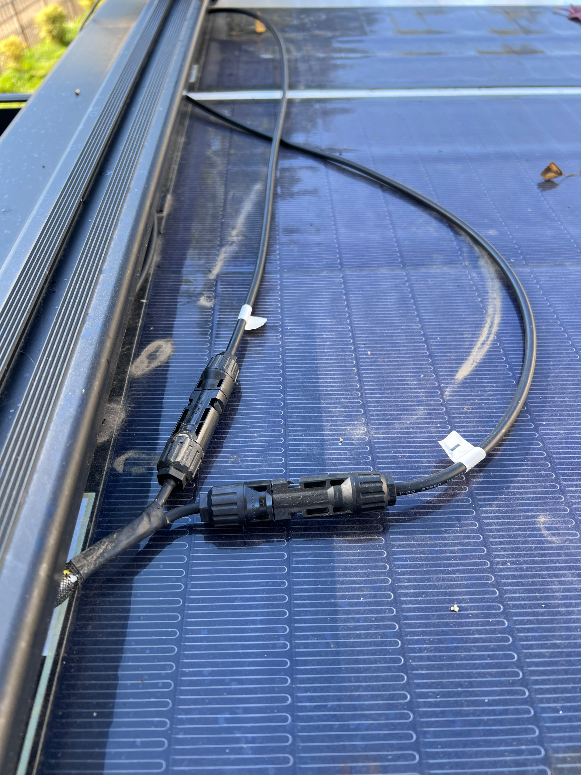

I added a second panel to mine. Max 2023 Tacoma long bed build, my solutions and looking for ideas
The wiring is simple because GFC included another wiring harness, there is a yellow and black and a red and black. The size and space you have for adding another panel is dependent on the truck it sits on as that determines the width of the V2 Max. Here is the connector set I bought: Amazon.com : Solar Wire Connectors, Solar Connector, Crimping Disconnect Tool 51 PC | Houseables Crimper, Connector Kit, PV Kit, Household, Panel, Cable, 12 Pairs 4mm, 2 Spanner Wrench, AWG 14-10, 2.5/4/6 mm² : Tools & Home Improvement

You can use one harness for both solar panels. I just chose not to. I ran a separate wiring harness from each solar panel to the Jackery because it has two solar input connections. This avoids having to combine the panels into a single circuit, keeps each connection within its applicable electrical limits, and makes troubleshooting easier. It may also improve performance when one panel is partially shaded.

Did you GFC come with the Solar panel pre-installed? Mine did not, they shipped it later and I installed it myself. If it is already hardwired then you would need to cut the wire and re-terminate the ends with solar connectors.
They shipped mine later as well, and I installed it. When you installed yours, did the wiring harness have removable connectors on the solar panel? Can you share pics?
Do you have pictures of yours?
Not of pre-installation. Pictures of post installation are already in this discussion. I believe the solar panel already had connectors or I had to remove them, sorry not sure anymore, its been a bit.
