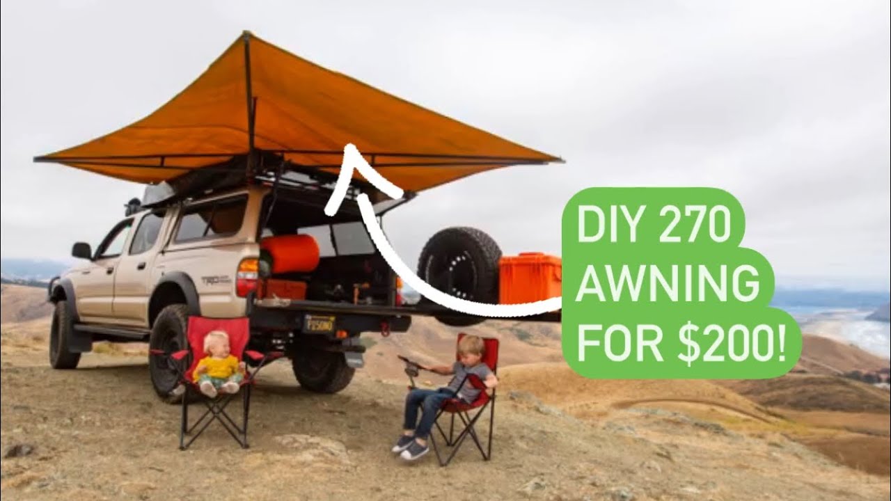

Has anyone tried the Overland Underbudget DIY awning for a v2 GFC? Im curious about compatibility with our mounts and our hinges.
