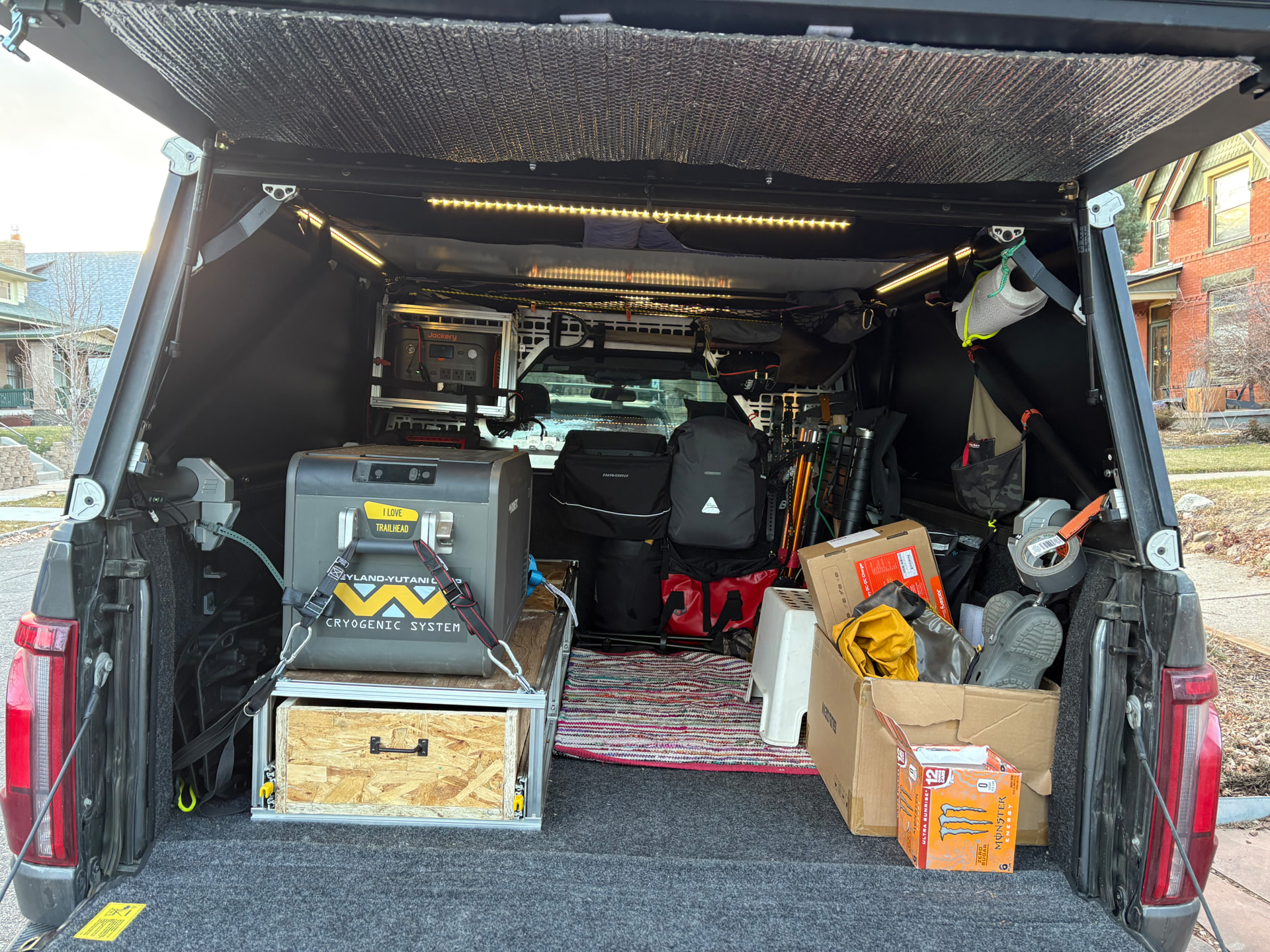

It’s not on a Molle panel but I made a front-mounted extrusion rack for my GoalZero. Pretty happy with this setup, it’s a lot nicer than having it on the floor. I haven’t found any major negatives yet.

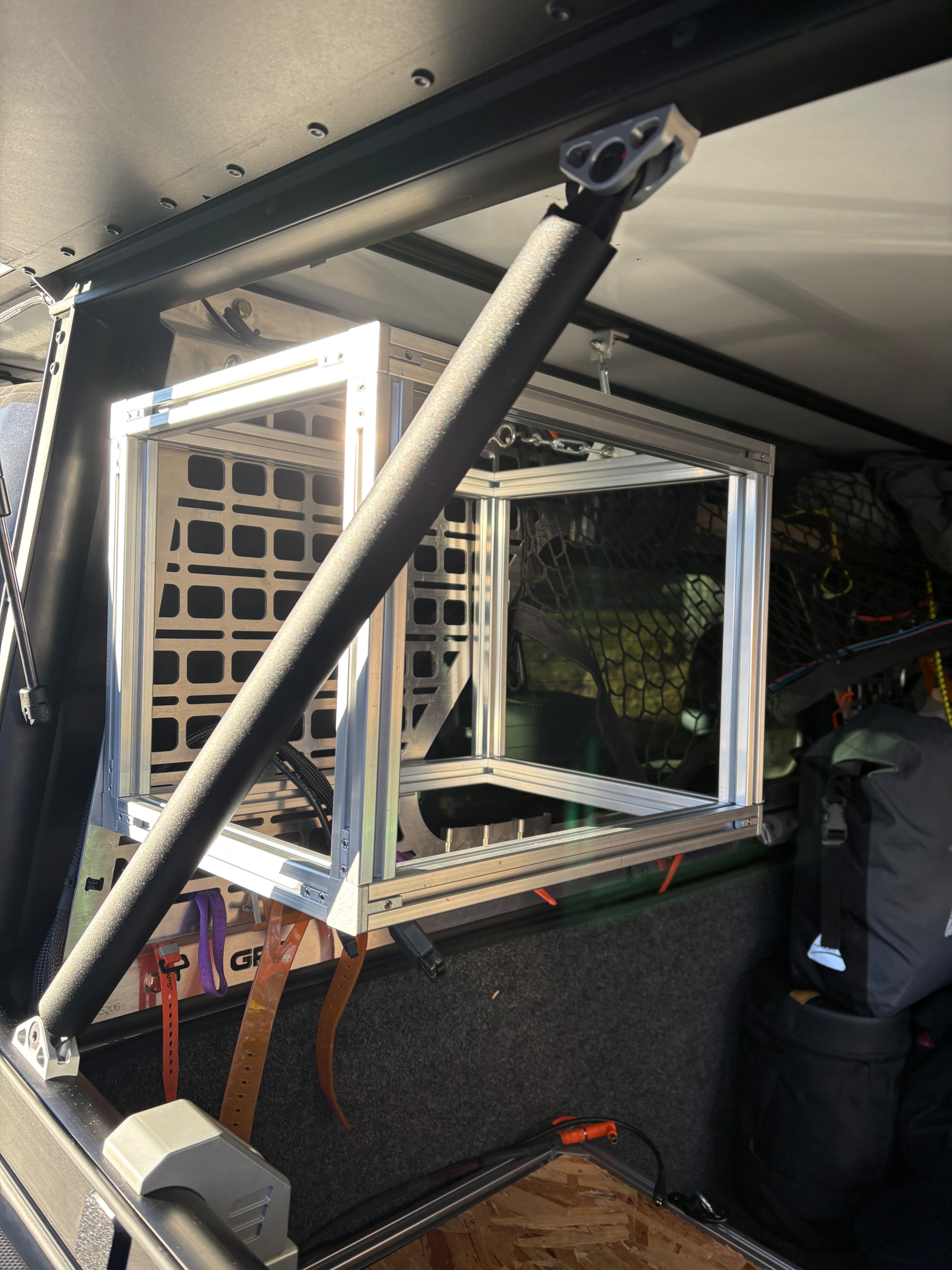

Updating the thread here with the solution I ended up coming up with. I got some ideas from @Vice_Chief 's build and decided to try mounting it to the molle panel. The weight is under 25lbs with battery and build. Much less below the 100lb weight limit of the molle panel. Haven’t given it a full test but feels incredibly sturdy.

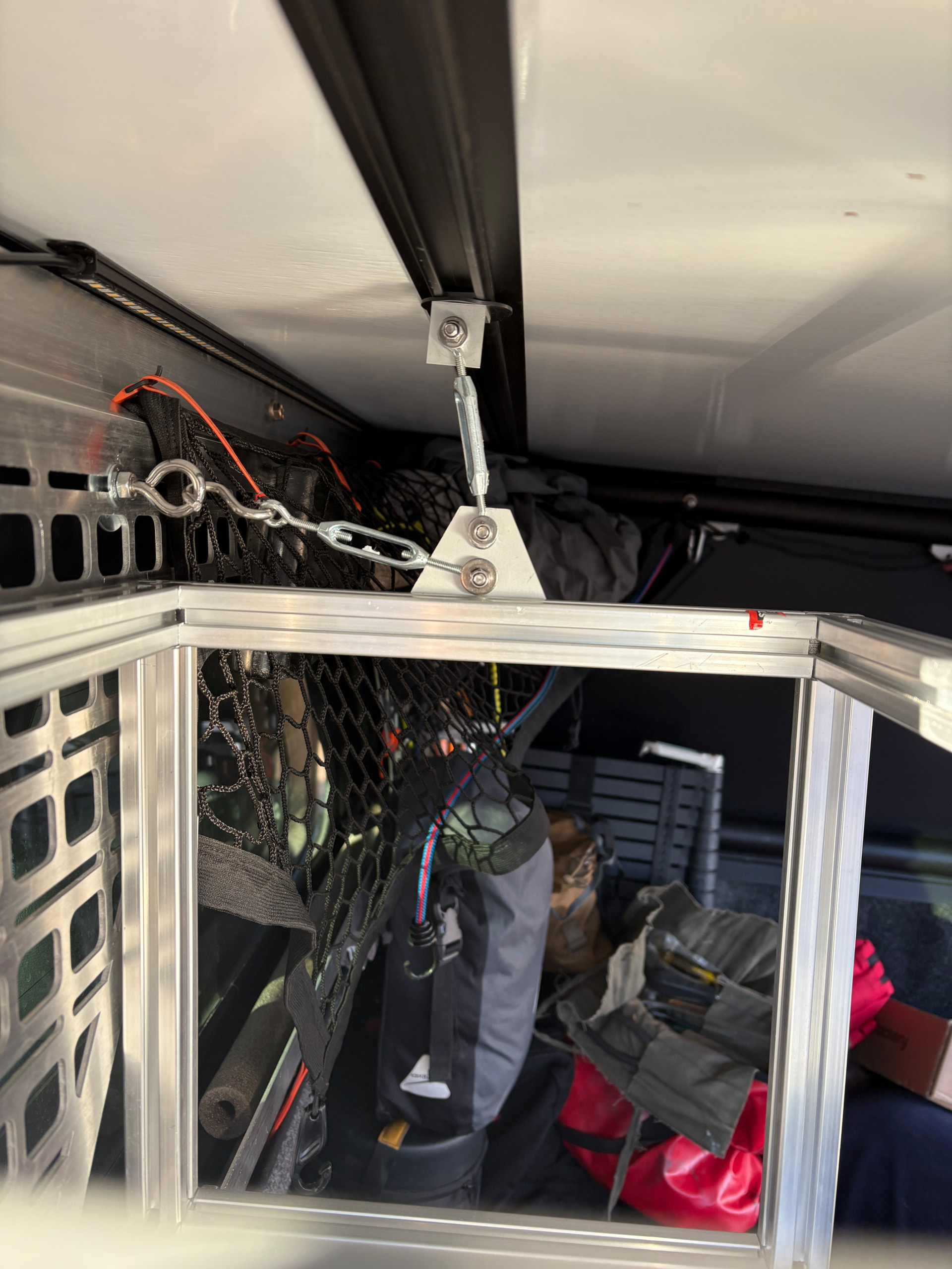

This is what I did. Its only been on for a week or so and no off road yet but seems solid. initially I has some movement and rattling between the top rear of the 80/20 frame and and the panel since the panel is kicked back at an angle. solved this with some spacers and rubber fender washers. so far so good.
