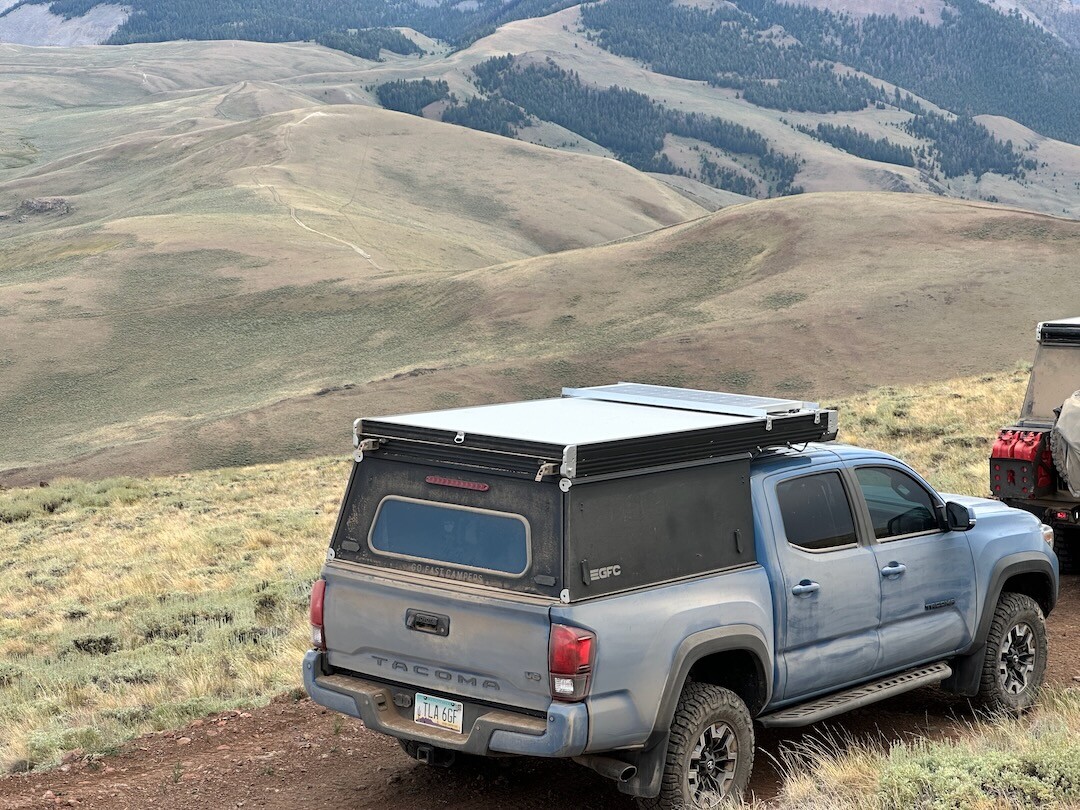

Initially a stock rig, but with the add of a ~265 lbs continuous load a bit of suspension work was desired. At work the fundamental question usually revolves around “what is the intended use case”. My interest is camping, the truck gets me to those places. The wheelin’ aspect isn’t my focus. Being from AZ, a requirement to avoid sun exposure was to “still fit in the garage”.
With all that background, here’s my solution to my desires.
*Armor*
TRD aluminum skid
Greenlane Offroad aluminum sliders (our friends to the north - take off ‘eh)
*Suspension, wheels, tires*
Bilstein 5100’s +1” on the front
Icon RXT leaf pack, Stage 1, just the right amount of lift ~1.25”
TRD OR wheels - function > form (just switched to SCS Ray 10’s)
Goodyear Duratrack RT - almost stock weight with 3 ply sidewalls
Perry Parts bump stops - 3dprinted solution? I’ll try
*GFC*
30 Ah LiFePO4
100w Rich Solar mono, custom rack
HardKorr flex LED 1m
custom corner electrical (USB A&C, ciggy, Anderson PP 30)
@buhlockaye latch covers

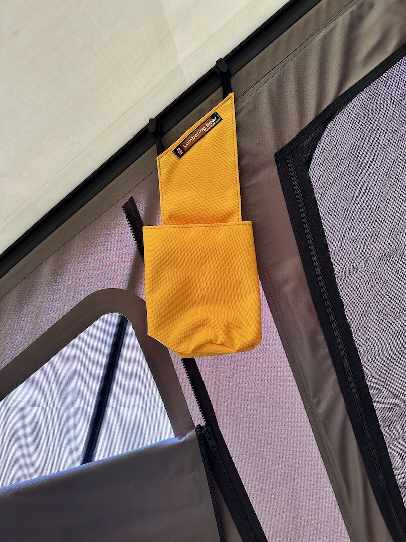

@lumberingbear v1 water bottle holder
custom MoonShade & table rack
custom shovel & saw rack
Dometic CFX55im
Dometic Go 11l jugs
MoonShade, custom printed quickfist mounts
PakRak bed stiffeners
@jedgar drip rails

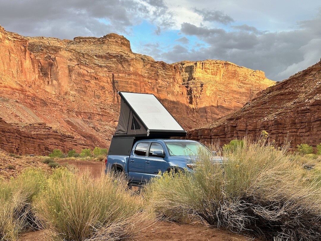

The first mod - adding a campfire on command.

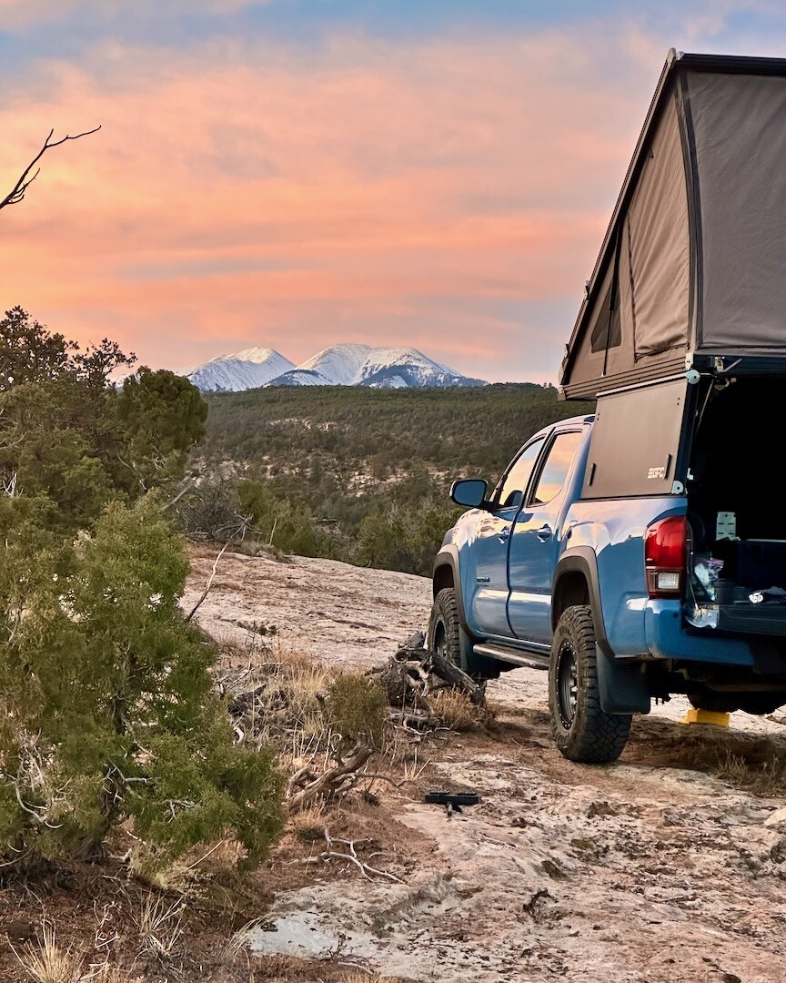

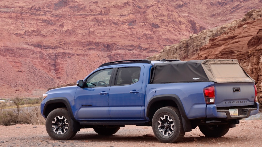

The Softopper camper mode - still amazed my wife actually did this trip:
When we added the REI 6 person - the tent being in stealth mode:

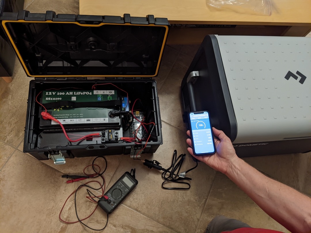

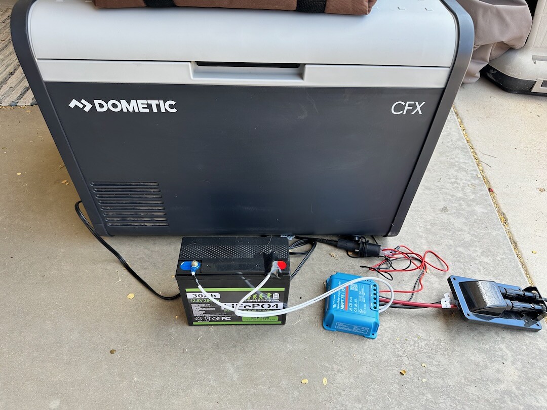

Running battery tests with the Dometic 55im
Hiker Trailer mode - didn’t like that as much as I thought we would.
First group “big” trip, GFC’s looked amazing:

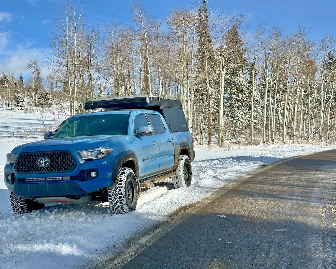

After that trip, did a smaller group, still in Softopper mode, but ended up at 9F over night. Frost on the sleeping bag foot end was extra “special”

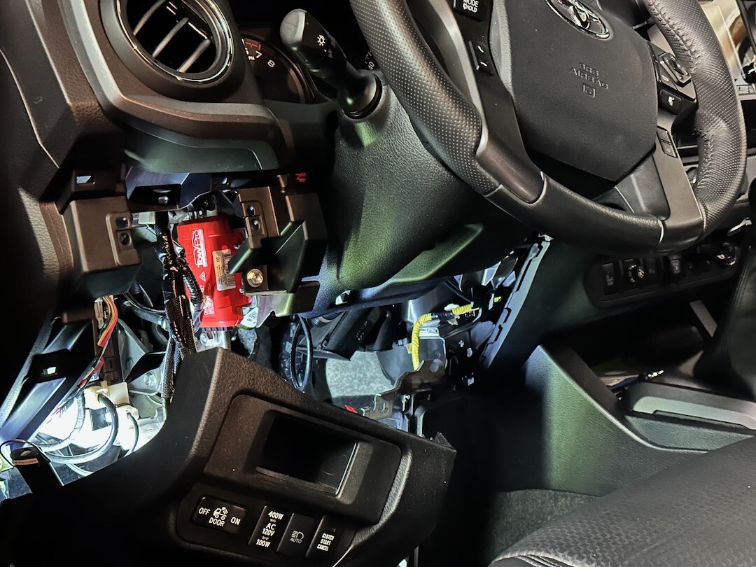

Ended up having a “rapid deceleration event” due to an inattentive fellow road traveler, added electric brakes to the Hiker.

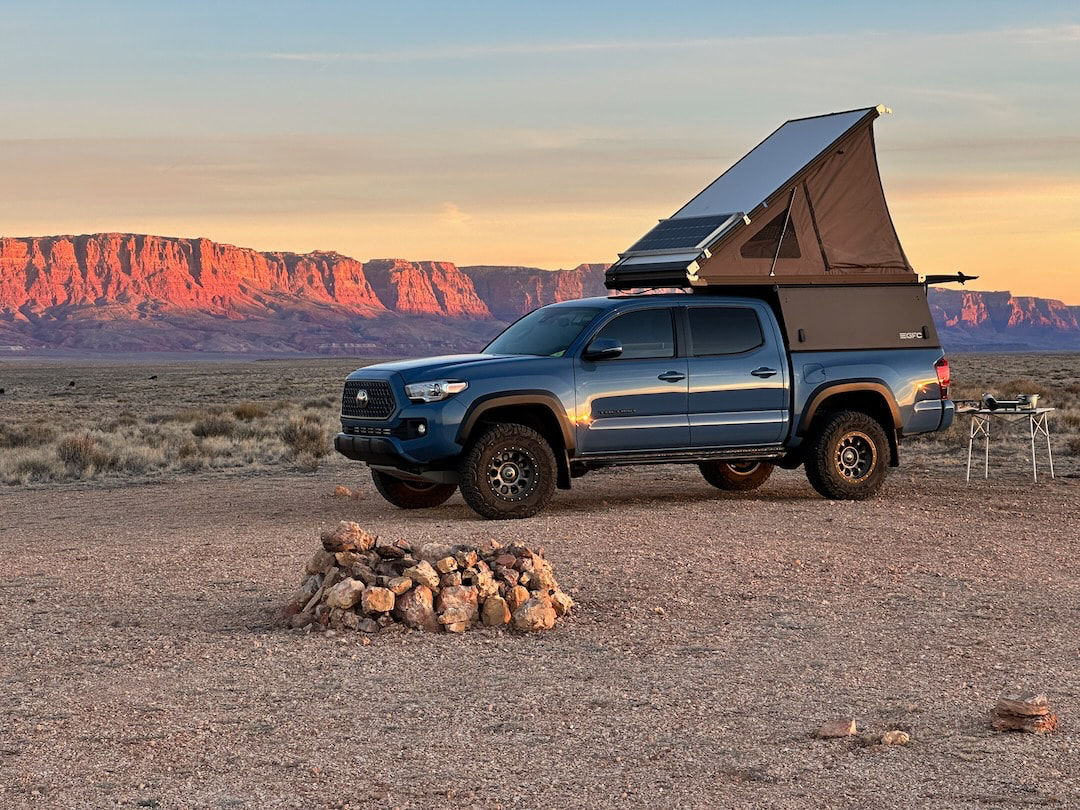

Needed a trip, but couldn’t rouse anyone for an early chilly run - so Comb Ridge area called and I did a solo run.
About this time, the group chat kicked off and yeah, that GFC joined our household.
New battery - 30Ah LiFePO4 and testing for use. 2 gallons of water, 90F outside, open a few times a day, 100w panel. My wife humored me with all this on the patio.

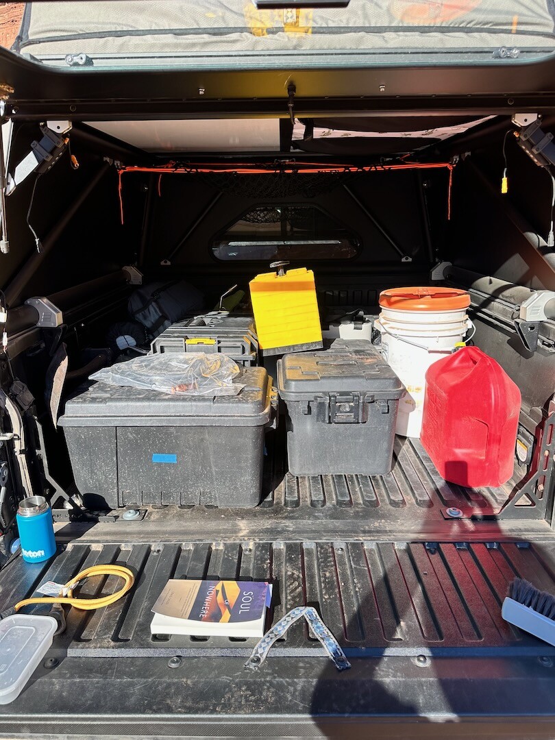

Still happy with the load out - Dewalt extra large toolbox as Kitchen and bench and step into the sleeping area. Low cost but effective Plano bins - pantry and compressor labeled, bucket which contains the mylar bag which contains those LNT blue bags.

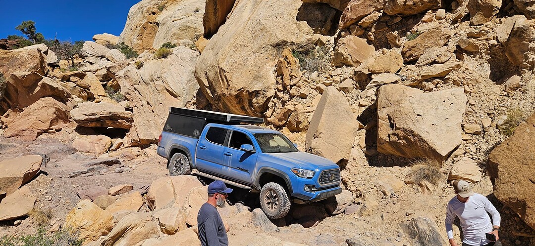

Fixit Pass in the Swell, bigger stuff than I would normally do, but a couple of fantastic spotters, led this blue truck through.

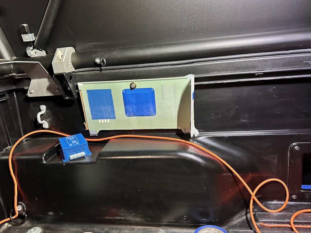

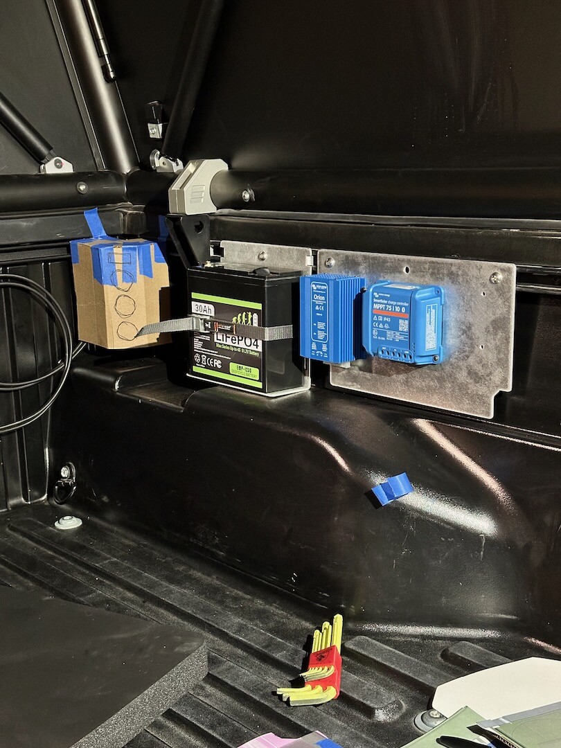

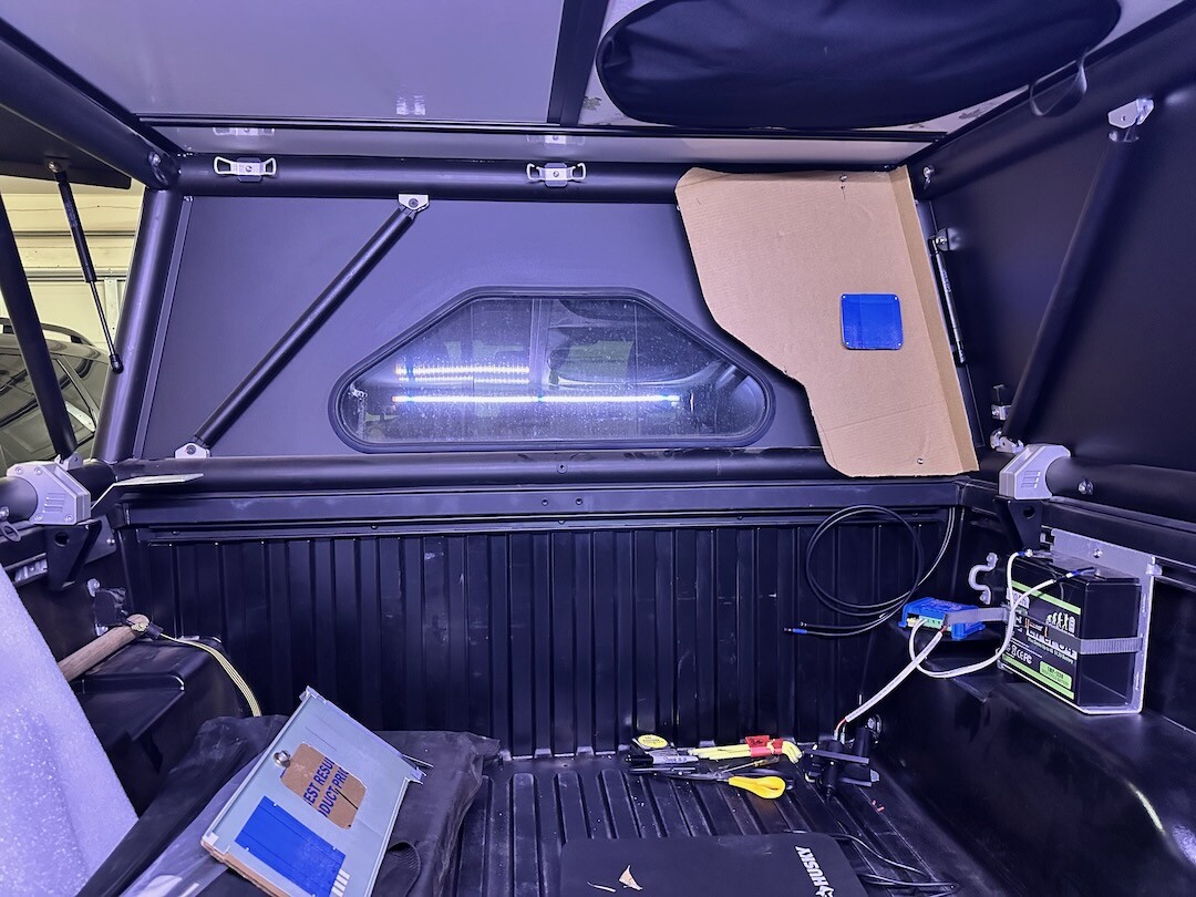

After the Swell trip, started thinking about the house battery. Knew the 30Ah would get me through 2 days no sun easily, started making cutouts. Wanted the wheel well to protect the tender bits. Used some cordage to run potential wire lines.
Need another trip to clear the mind, couple of friends from work, did a 3 day weekend together. The 4Runner at the end, Taylor, used a wok and made stir-fry. Crazy Cats did that smell good! Put on my list to experiment with a wok for a cooking utensil.
Still pondering on the electrical - maybe mounted on the cab side wall? Eh, don’t like the aesthetic- but put it to CAD (corrugated aided design) to confirm
Ended up with a side panel, protected from stuff in the bed by the wheel well. The 30Ah battery and Victron 75/10 SCC worked well on a 9 day trip through Idaho’s Lost River Range.

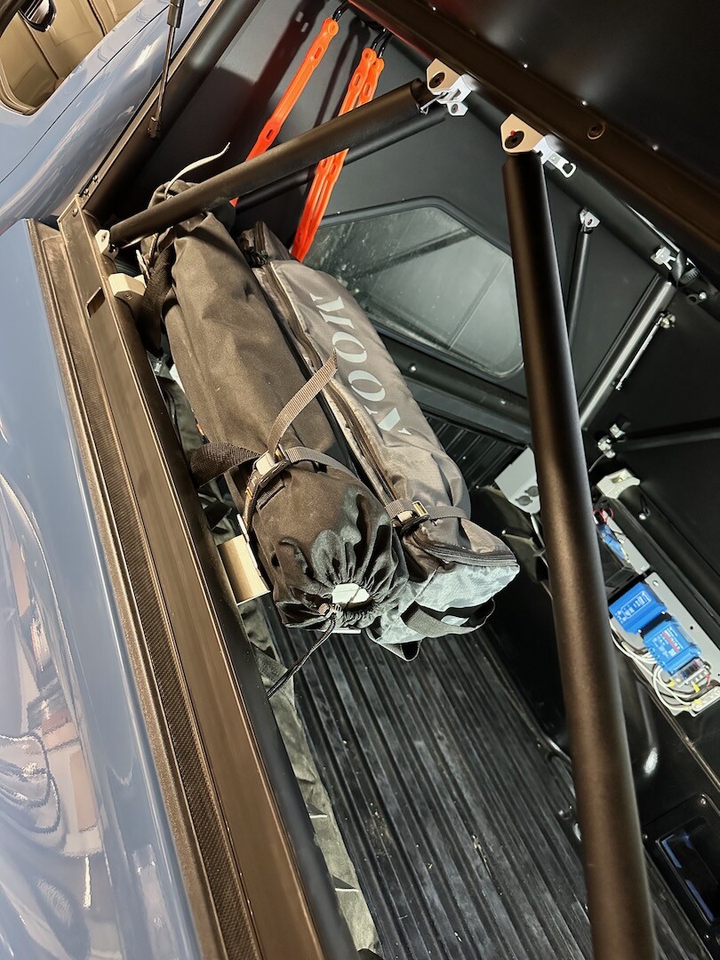

Added side panel access for table and Moon Shade. Previously they lived on the top of bins in the back. This is so much nicer and quicker for setup. SendCutSend for the win.
@Rancho ie. LumberingBear water bottle holder

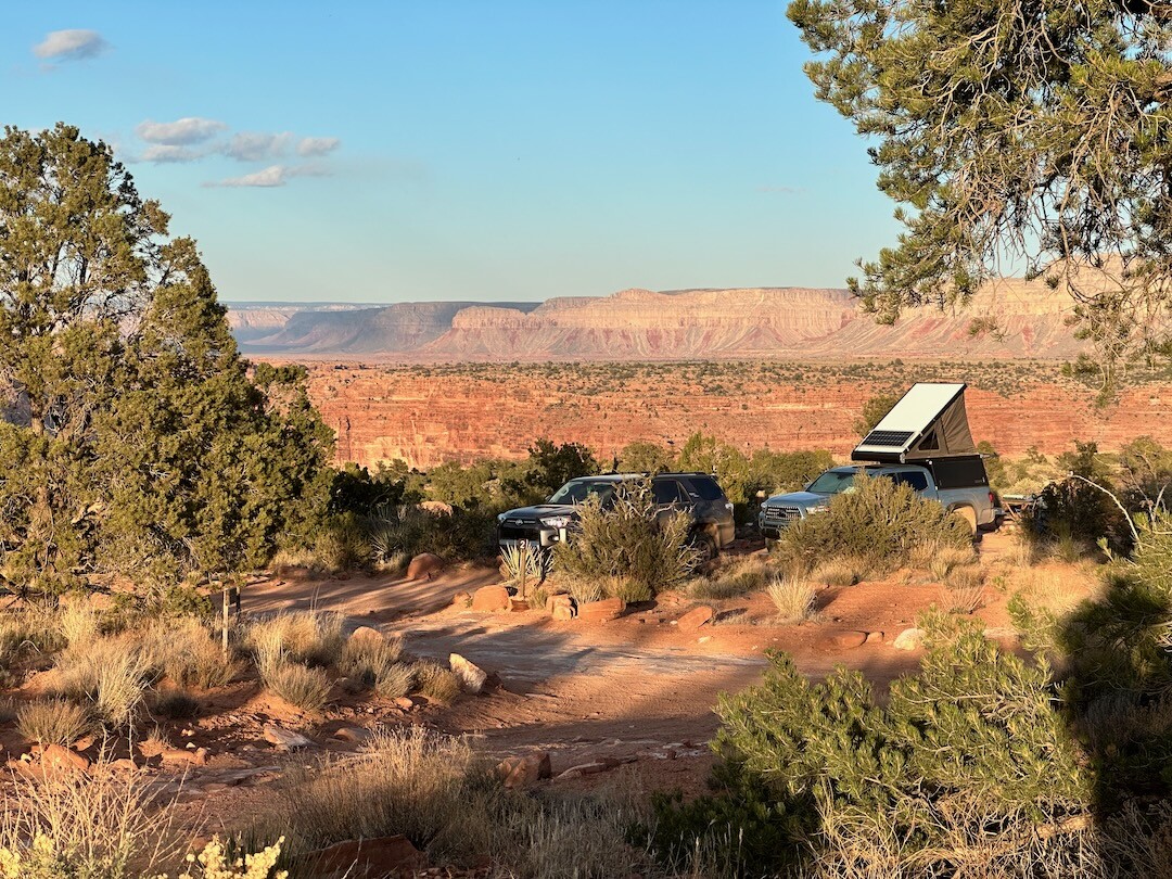

Quick 3 day weekend trip Kaibab NF, more GFC’s.

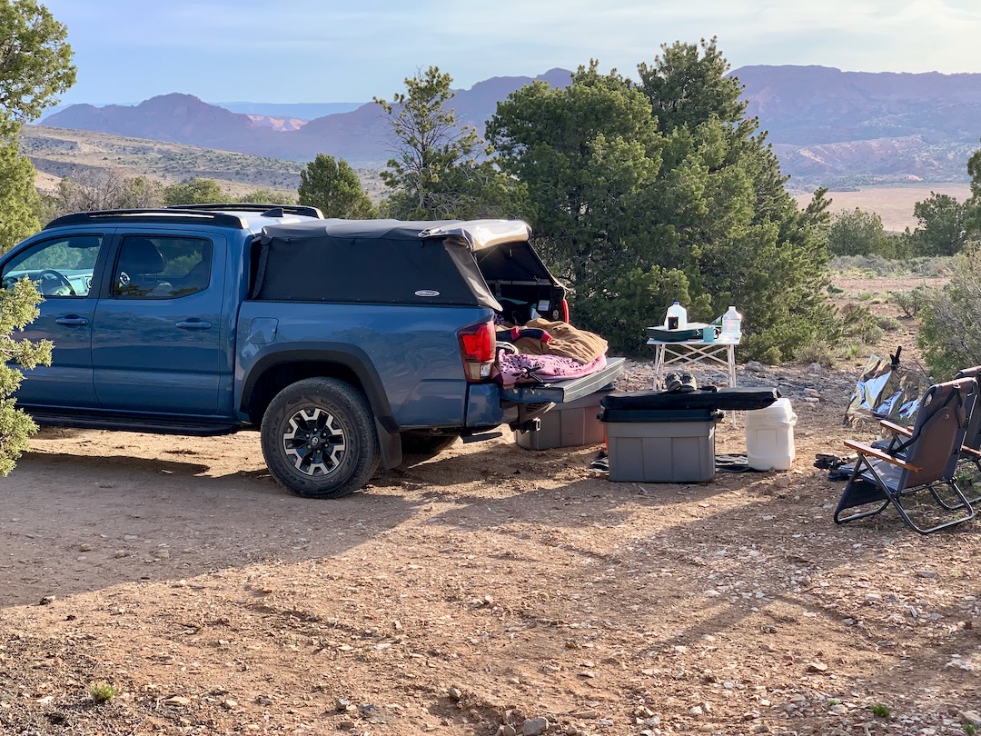

Mmmmm….Thanksgiving. It had been awhile since I had sat around a campfire and Thanksgiving at my sister’s place gave me a good reason to road trip and do an overnight stay outside. Moab is the halfway mark of that journey and it has some great places for morning tailgate coffee.
Over the years of family trips, I had noticed a sign for the La Sal Loop Rd. This was the trip to finally explore that loop. A quick message to friends on a Signal chat yielded some potential overnight spots.
I’m a ponderous traveler, or as some say “you drive like a grandpa”, preferring a good soundtrack (yep have over 1,500 songs on the usb) and point of interest stops rather than a schedule. But, that characteristic didn’t serve me well on this trip. I arrived at the first spot on Polar Mesa which had a deadfall blocking the entrance - about the time the sun was setting. Backtrack a bit and head on down the original plan - Kokopelli Trail towards Onion Creek.
Found a site, and quickly prepped a GoodTo-Go Thai Curry in the dark. That aforementioned campfire? Yep, dark night, slight breeze and juniper made for an evening as Abbey put it - “One breath of juniper smoke, like the perfume of sagebrush after rain, evokes in magical catalysis, like certain music, the space and light and clarity and piercing strangeness of the American West.”
After having slept the sleep of the just, woke up refreshed and ready for coffee. Tailgate coffee looking at snow covered La Sal’s is quite the privilege. Now, it was on to Thanksgiving - fully prepped.
Almost to the end of 2025. We’ll see if I get any additional nights under the stars. 22 nights out this year. Didn’t make the goal of 30, but it’s on the target again for 2026.

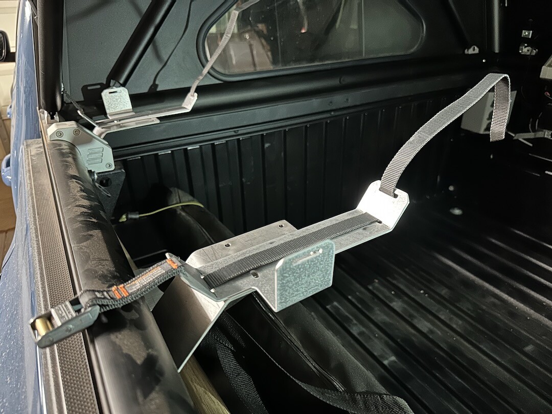

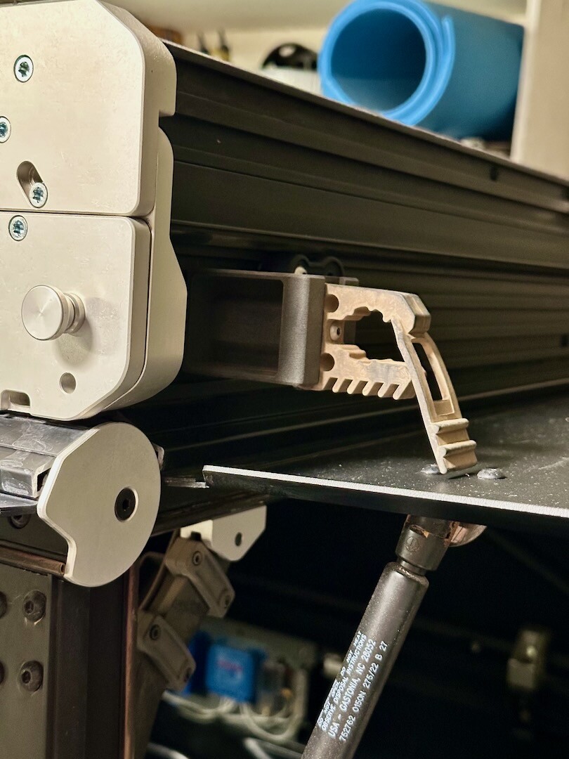

Just noticed I didn’t update the side carrier bracket. The table bracket worked so well and I had space on the angles, added in the ability to carry both the table and Moon Shade. Last year during the Thanksgiving kickoff of the shopping season, I purchased the RollerCam Molle Kit. They worked so well, I standardized my oval cutouts for their 3/4” straps.
Corrugated and X-Acto blades are my friends - lol

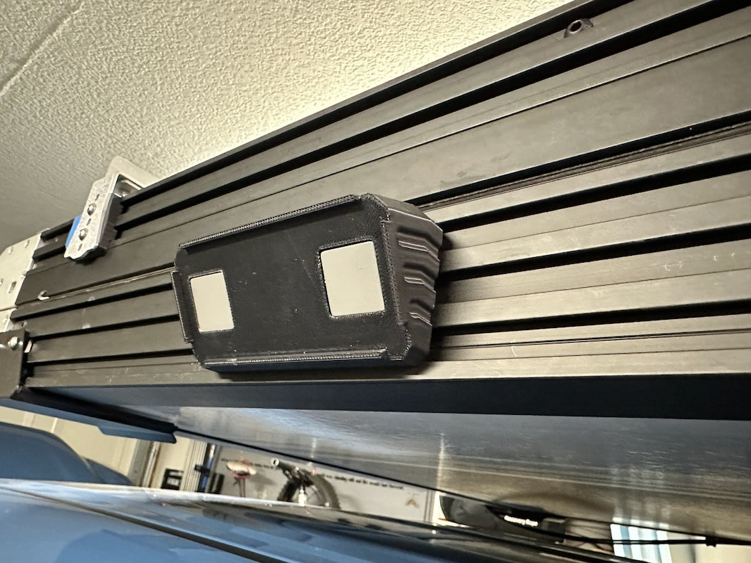

Curious how you have been setting up and using your Moonshade awning? I got a deal on one and pulled the trigger but I haven’t found a great way to set it up with the GFC yet.
Ah, I see I didn’t add that in. I have the Moon horizontal strut pole and use the Quick-Fist mini mounts. I printed up a riser bracket to extend beyond the latch mechanism. It works, eventually I think I’ll make up an aluminum extension, but the printed one works for now.
The red moon dust from the San Rafael Swell is particularly attracted to it - has survived several washings and the snowy trip home from Wyoming.
That’s a very cool solution for the Moon awning. I’ve been using Nite-Ize ties to the GFC release knobs and crossing my fingers the winds don’t pick up :slightly_smiling_face:

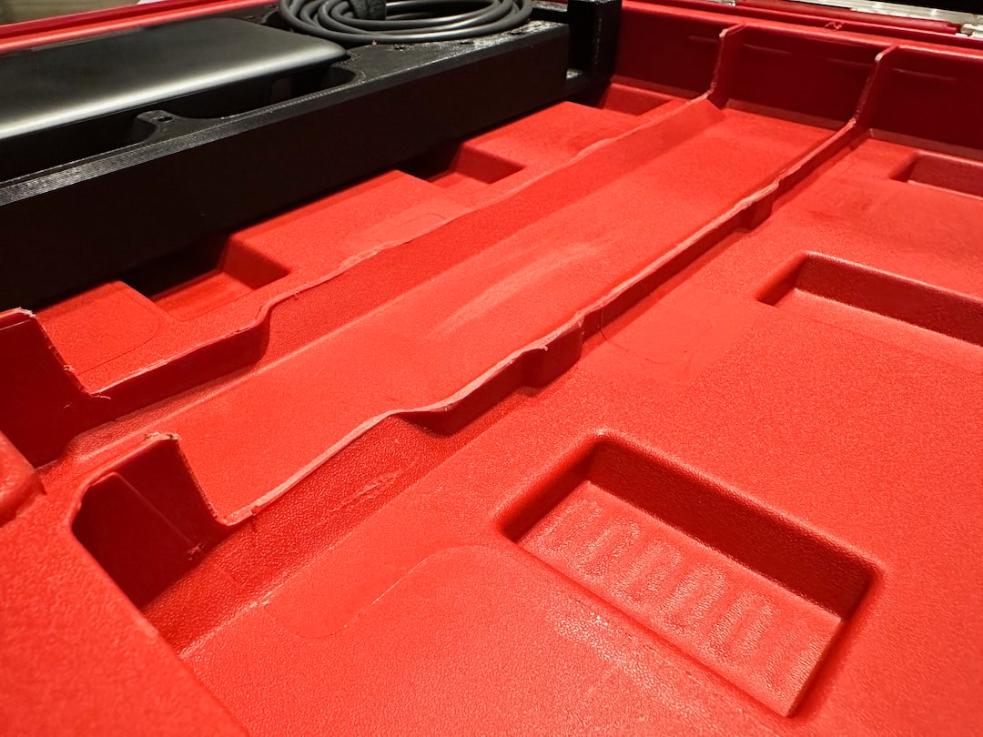

With that time, was able to do a couple of “Quality of Life” projects. I had stored my Starlink in an Apache 4800 case which rode in the driver side back seat. It worked, but when cold-ish weather camping, gear always ended up on top and the 4 closing buckles would always end up inside and I’d need to fight with the case to get it closed or completely remove it. (whew, quite the run on sentence) Not the fun-est and definitely added friction to the Starlink usage.
I saw a reddit post about putting the SL in a Milwaukee low profile case and thought it was pretty cool. MUCH smaller than my 4800 case. Home Depot and their Buy More/Save More sale ultimately was my undoing. Worked on and finished a pretty good solution in my mind.
3d printers for the win.

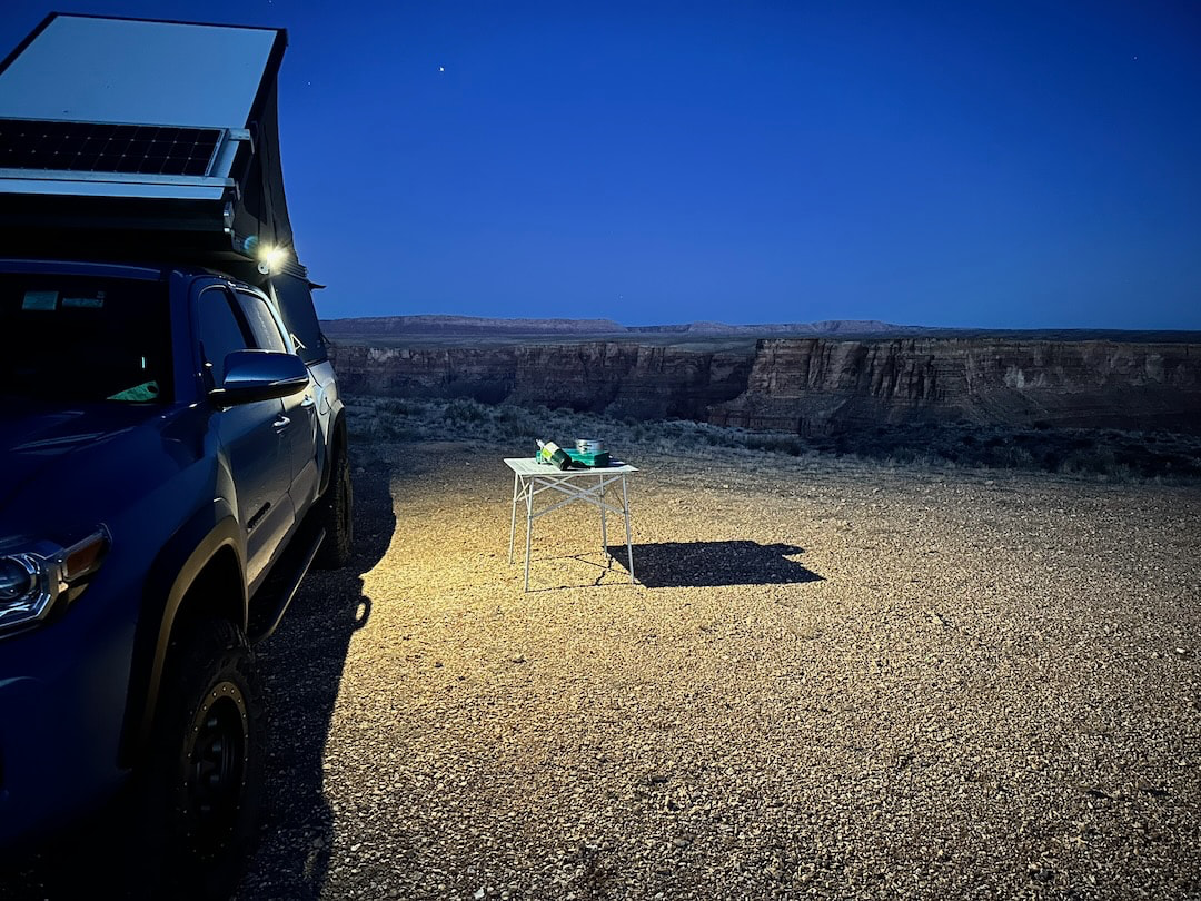

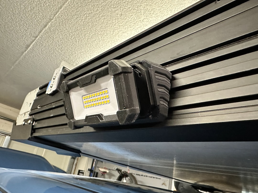

On the Thanksgiving trip, I arrived after dark and was really wishing for some scene lighting as I was setting up camp. A couple friends have the Baja Designs Rock Lights and they are awesome. Looked at the KC Cyclone and see that these two run between 400 and 600 lumens. But they require wiring and I really wasn’t wanting that right now.
Enter the budget Husky 500 lumen rechargeable. $15 and I had one in my hand. Turned off the lights in the garage and held it up on the side of my truck - yeah, this should work adequately when needed. Do a bit of modeling and print off a couple of mounts for in camp/setup use.

In my last “friction reduction” post, I printed up a couple mounts for the lights. This trip I did end up getting to camp super close to sunset - and cabana mode sure makes some nice images.
The Husky light on low provided “exquisitely adequate” scene lighting. Also, I may have set an alarm to remember to take a photo during the blue (half) hour. One of the advantages to solo trips - it didn’t matter if my cook pot was fully cleaned when the alarm went off - just put it down and take the photo.
Concept validated.
