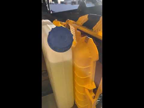

You just need this stuff and it doesn’t matter if your exhaust is sealed properly. ![]()
