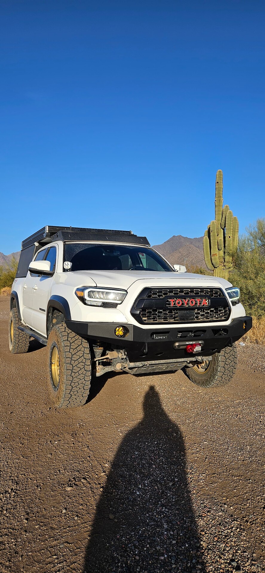

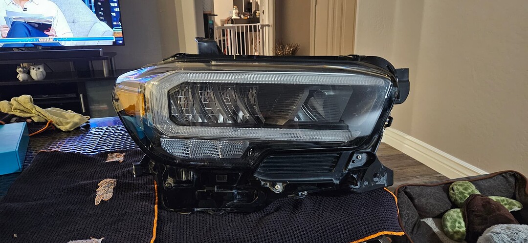

Couple changes coming soon
Scored a couple really good deals on these so pulled the trigger
OEM led headlights off a 2022 trd off road. This is a huge upgrade I’ve been wanting for a while the 2018 factory halogens are just awful headlights.
Then scored the bumper I’ve been eyeballing. Demello steel bumper. Would have preferred the stealth version with lightbar cut out but for the price and the fact it came with the BD squadrons i won’t complain. Waiting on a winch then will install both
Was able to snag both items for less than the price of buying a new bumper
Front end face lift complete. Next up expo in may. Need to snag an awning and looking for upgraded molle bags for storage on front wall.
