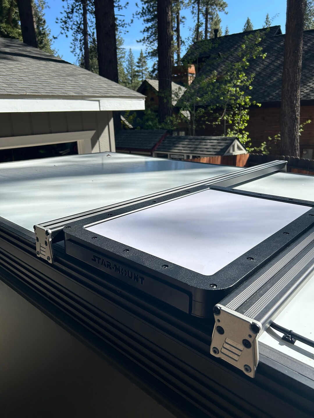

Thought I would share my Starlink mount on my GFC. Here is the equipment/parts I used. The forum rules only allow two links for new members so I listed where I sourced the parts.
  • G3 Starlink Standard Antenna (Starlink)
  • Starlink Mobile Priority plan (Starlink)
  • Starmount 12 volt conversion for Gen 3 w/flat mount and quick release (here)
  • GFC Beef Bars XL (GFC site)
  • GFC Platform T Nuts (GFC site)
  • 12 Gauge 2 Conductors Premium Electrical Wire (Amazon)
  • 3/4" Zip Tie Adhesive Mounts Self Adhesive Cable Base Holders (Amazon)
  • 6 way fuse block (Amazon) (here)
  • 12awg SAE Extension Cable Quick Disconnect Wire Harness Plug (Amazon)
  • Weatherproof SAE Quick Disconnect 12AWG SAE Extension Cable Power Socket Sidewall Port (Amazon)
I was able to mount the Starmount flat mount to the bottom of the GFC Bars with the 1/4-20 GFC T Nuts. I did wire the electrical through the front of the GFC as GFC staff indicated that drilling through the GFC top would void the warranty and decrease the integrity of the GFC roof. By adding the 6 way fuse block in the bed I can add other accessories later. I went with 12 gauge wire as the new Starmount 12 volt conversion is a lower draw and I will only add low draw.LED lights to the fuse block later.
