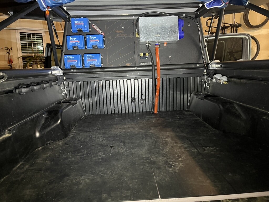

Major electrical upgrades going in this week. 4x Victron 12/12-30 chargers to charge my 4 Battle Born 12V 100Ah LiFePo4 batteries. The whole electrical system was in the cab, but I decided to build it into the bed since I like having access to everything when it is nasty outside, and the self-heated batteries won’t have to heat at all if they are with me in a warm truck bed.

Foam insulation 1.5 inches thick gets you clear of the GFC bars
A4220501-D4A3-4582-AA30-1415C4953ACA_1_105_c
3/16" HDPE starboard sheets Installed with M5 Riv-nuts through the front aluminum wall of the GFC. Planning to add some more once the inverter goes in to give me some more strength.
A000EE11-0CA9-446F-96CB-1FA98965CF34_1_105_c
That’s it so far! Planning on swapping for a 270A DC Power Engineering Alternator. I am planning to wire my batteries as 2S2P for 24V, the only 12V load I have is the heater (easy conversion), but 24V makes starlink 48V easier and everything else can work on 24V.
