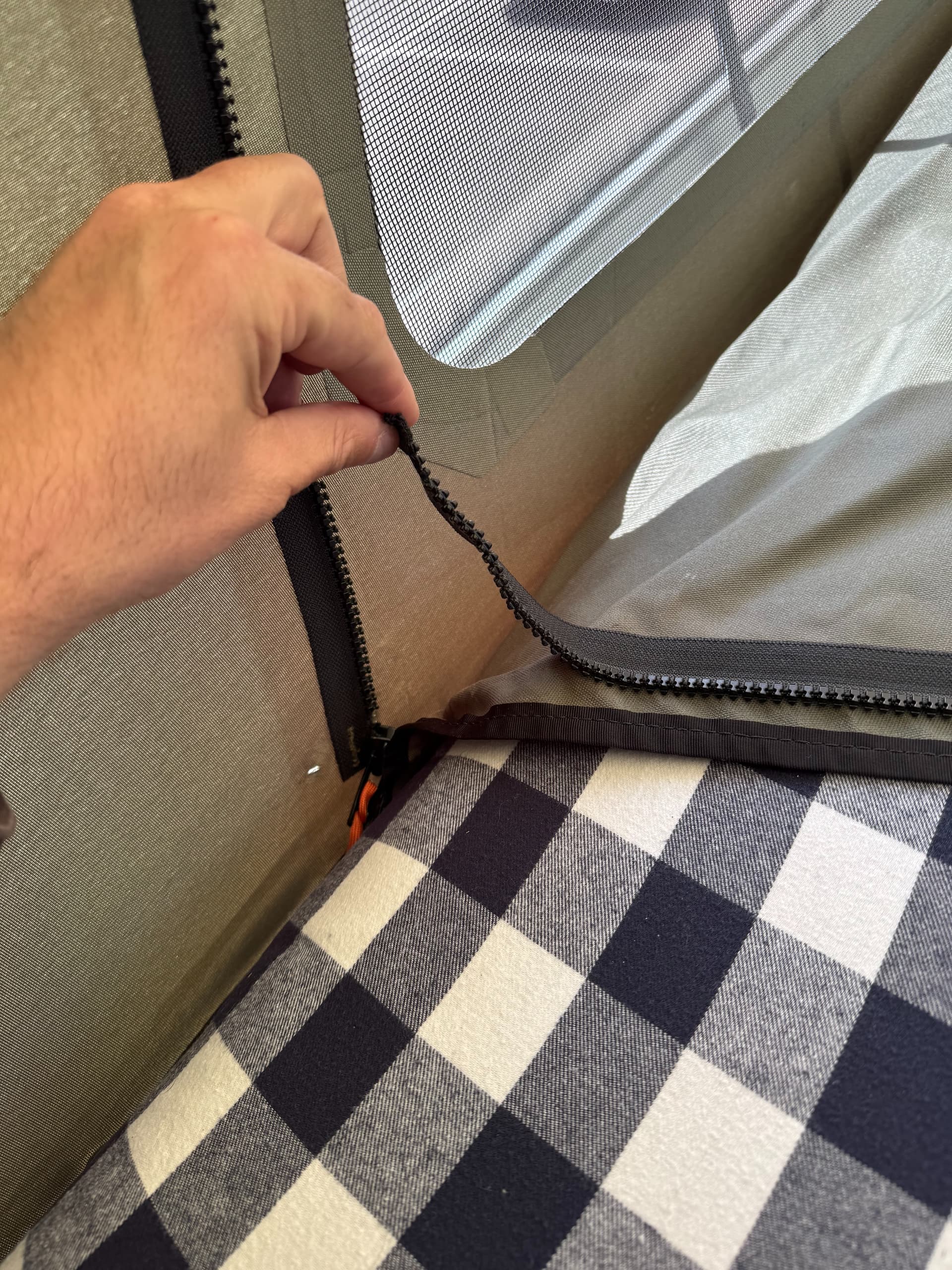

what’s up everyone. I currently have a V1 camper that the zipper has failed on the window. Currently have been emailing back and forth with the service team at GFC but was curious if any users on here had any solutions for this? Or if anyone has upgraded the V1 tent. Does the basic V2 tent fit as a direct replacement?
I have this issue with the V2 currently and was going to attempt to use shoe goo to reattach the pieces.
Yeah i read through people doing that too. I looked a little closer and the teeth of the zipper are actually broken aswell so reattaching wont do much for my case. I guess i could just glue and then not have the zipper go beyond a certain point

The more i look into this, i think im going to pull the tent out and have one of the seamstress at my work help fix the zipper and add a side door.
Update on this. I’ve got supplies purchased to put a new zipper on the window as well as supplies to add my own side door. Total cost in material about $100
