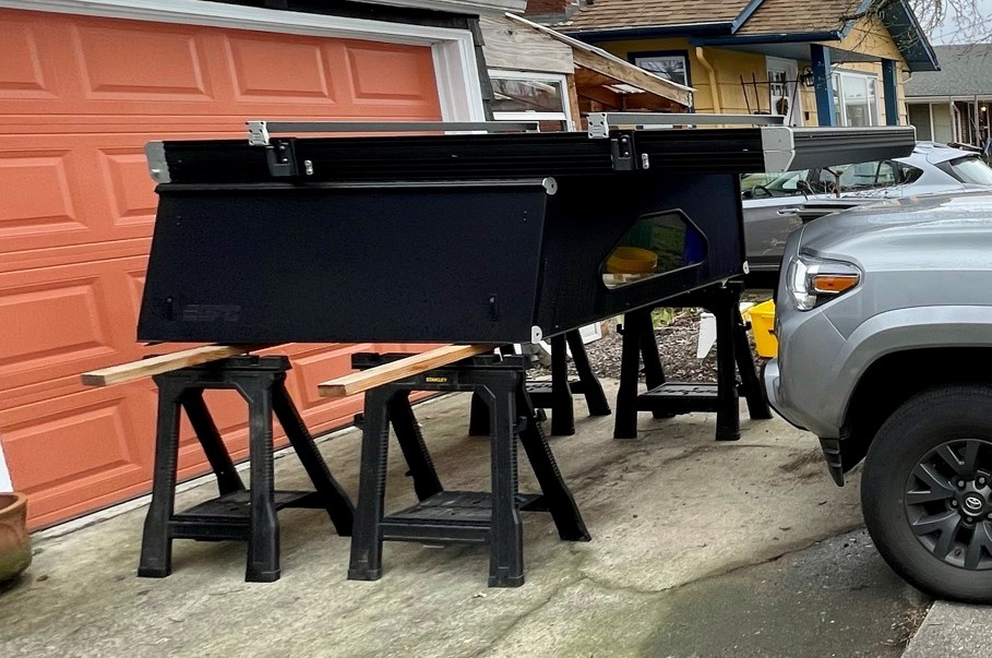

How much of a pain was it to get off your truck? I’ll be doing the same likely this weekend - any tips? I’ve got 4 guys helping.
Not gunna tell you it’s easy but definitely doable with 4-5 strong people :joy: It’s not that it’s super heavy, just weird weight distribution. We semi-slid it off the bed rails onto the tailgate where everyone can get a better grab and placed it on sawhorses.
Take it slow and make sure no one drops it and you’ll be good to go! Communication and a plan is key!
I had to take our camper off last year because we got rear ended and needed a new towing/hitch assembly. My technique was to unbolt the GFC and slide a few 2x4s between the bedrails and the brackets on the GFC. I actually drilled holes into the 2x4s and bolted the GFC directly to them. This gave a stable place to hold and lift from on each side. Might have been overkill but it made it really each to move on and off with 4 people.
Sorry I don’t have a better photo.
IMG_4638
Oh this is absolutely amazing. Thank you so much! This is the technique I’m going to try.
EDIT: I tried it and it worked fantastically! We didn’t bolt it to the wood, just tried to keep it somewhat level while moving it. 4 guys, no problem at all. The back end is actually super light. Front end was kind of iffy lol
Thank you again for the tip!
It made it really easy to get the correct placment when putting it back on the truck. Just get it lined up, unbolt the 2x4’s, and pull one board out at a time. Worked great!
