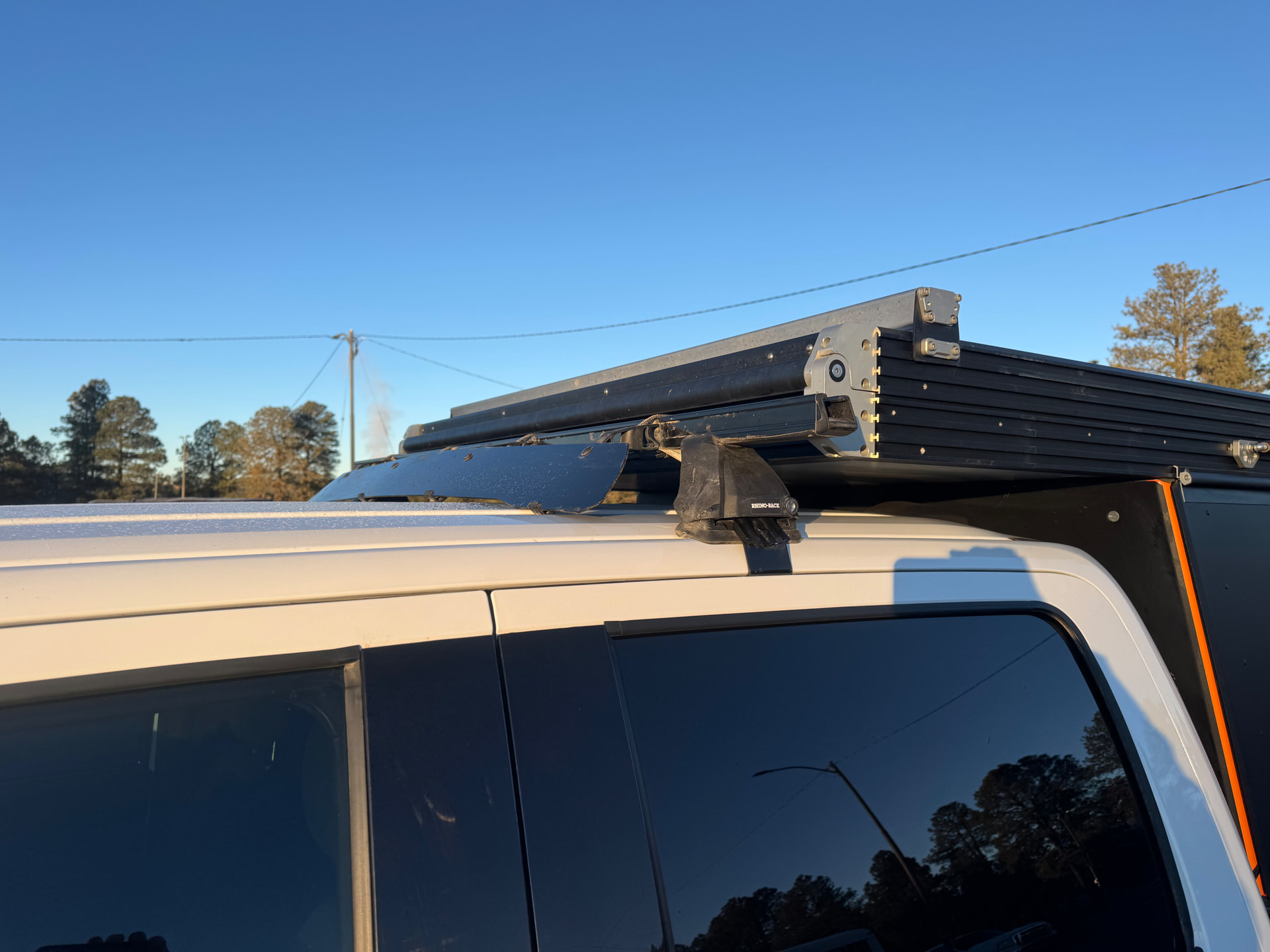

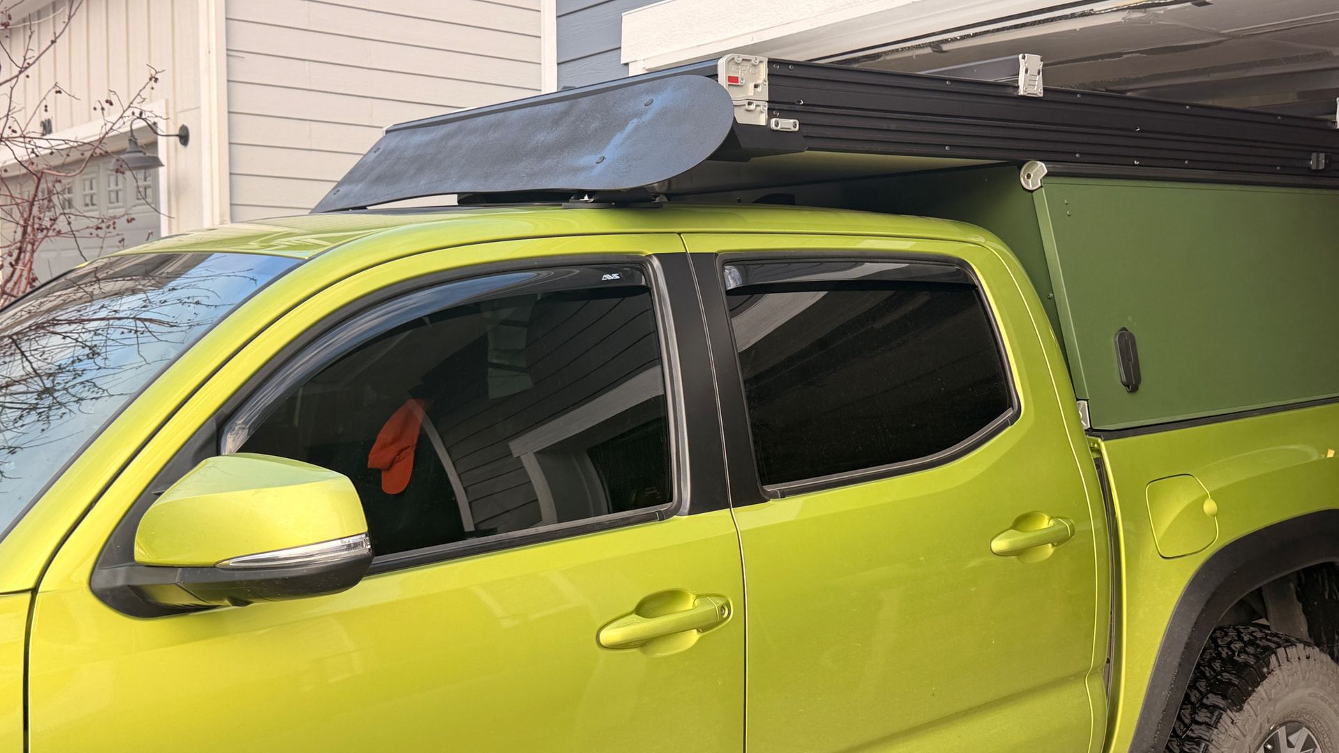

I found a used one of these rhino rack deflectors Going to start with that and if its not tall enough, replace the plastic with a taller one. I think it should work!
Nice seeing a Colorado! Good job on the wind deflector.
@atsah - how did you attach the bracket to the drip rail?

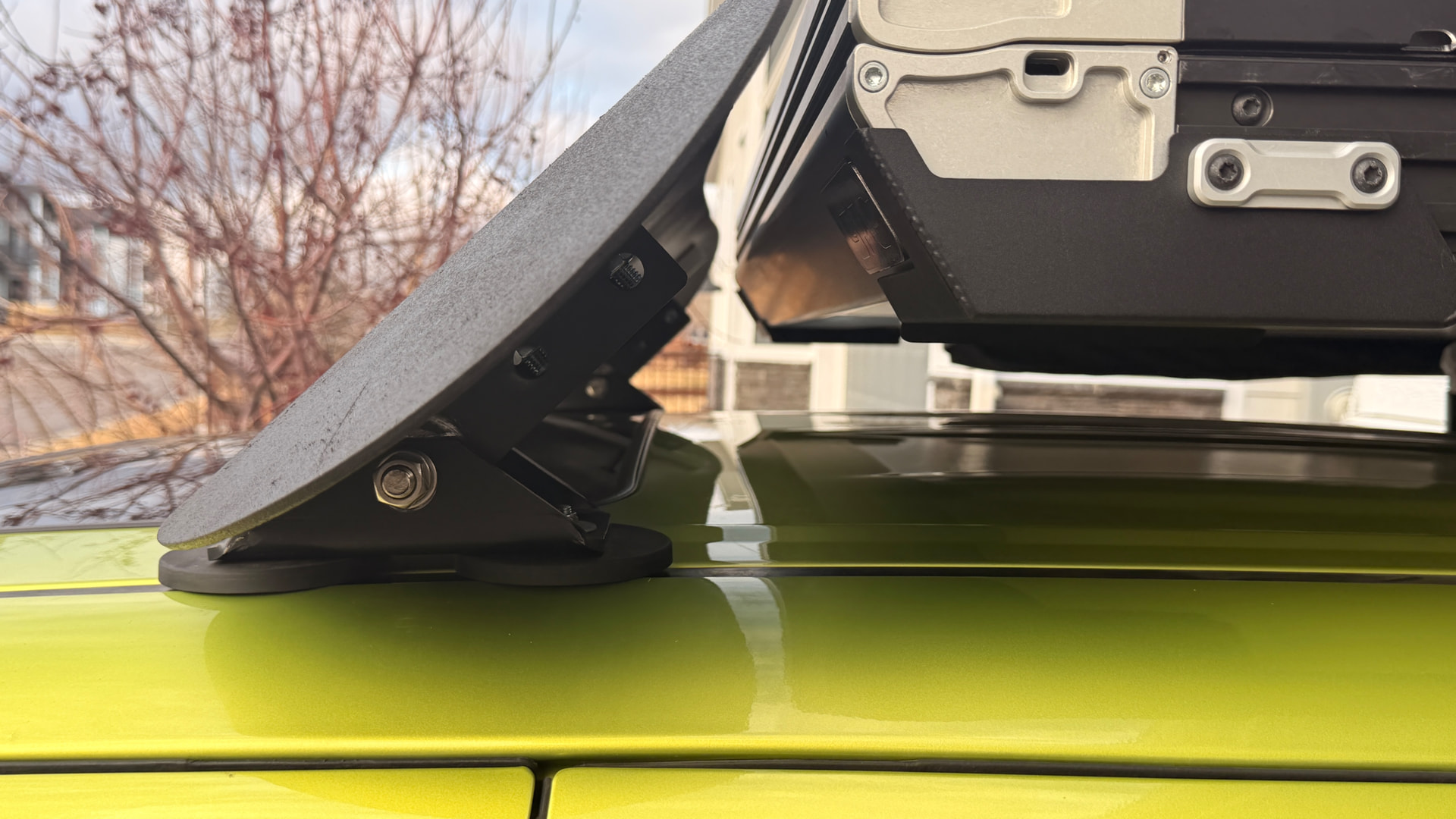

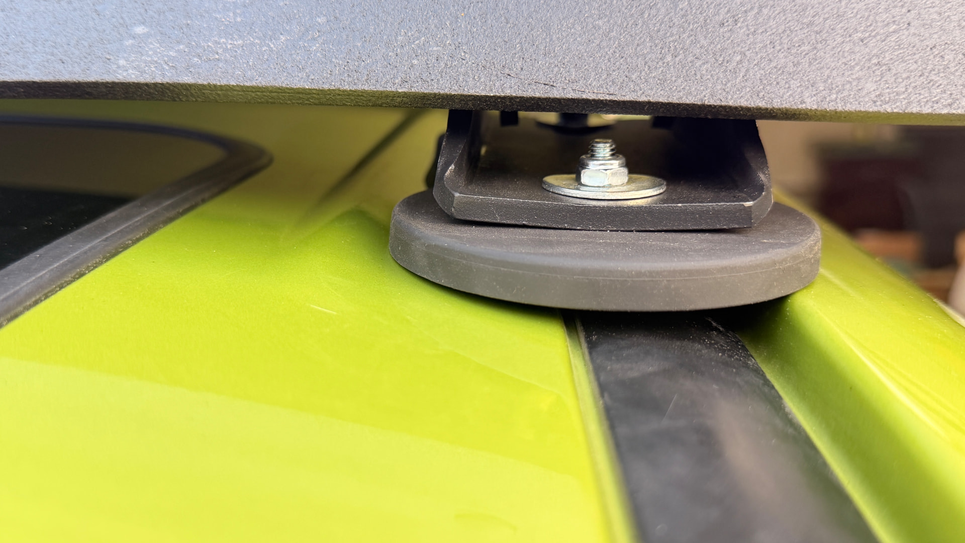

I used some lock washers and a little longer bolts into a Gzila track nut and my memory is that i actually had to cut the L bracket down a little bit to get it to be flush with the drip rail and drill some other holes in the drip rail to get it to work (you can see the original hole if you look closely at the third photo). Its all an experiment/puzzle so just keep trying stuff until you get it to work.

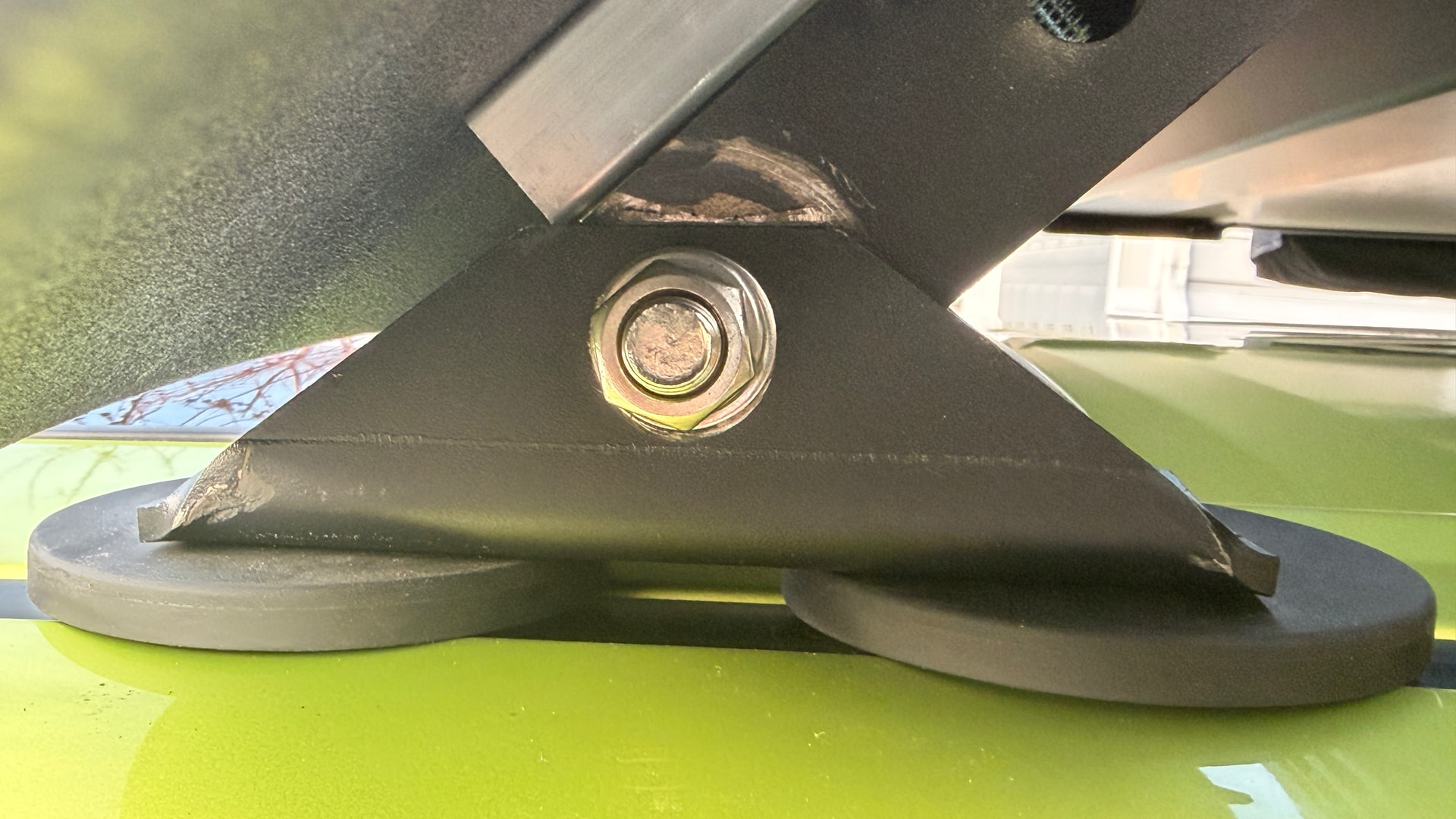

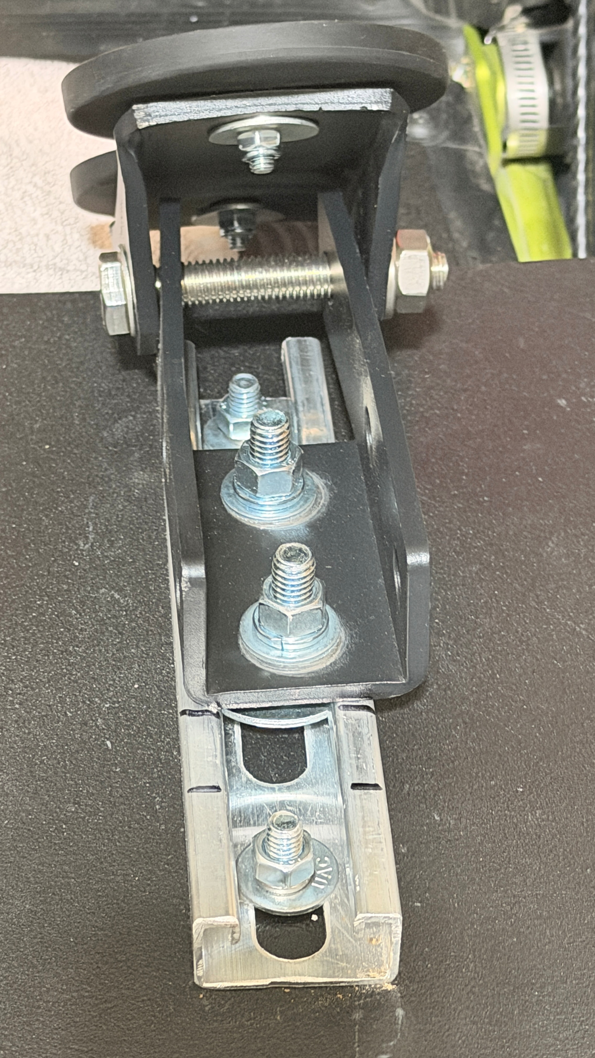

I just finished putting up some 13/16 unistrut in the back and had some pieces left over, just the right amount, 6 inches, perfect. I figured that unistrut has to make an adjustable brace. Amazon.com: 2 Pcs Adjustable Brace Fitting,180 Degree Turn Joint Connector Bracket,Solar Panel Bracket, Fits for 1-5/8" Post Channel,0.2" Thick : Everything Else also bought 110 pound vehicle magnets also. (they did not come with nuts 6-1.0) put it all together and small adjustments. I have it set at 45°. Seems to be about right at the moment.
And just for safety I have a tether on it until I’m confident it won’t move. Have gone down the highway 75 miles an hour and it didn’t budge.

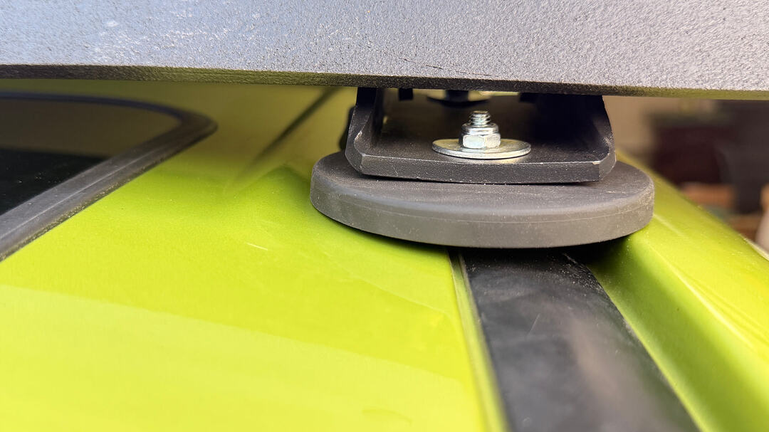

Magnets are over the rail area. They would not sit very flat with the bumps in the top of the truck.

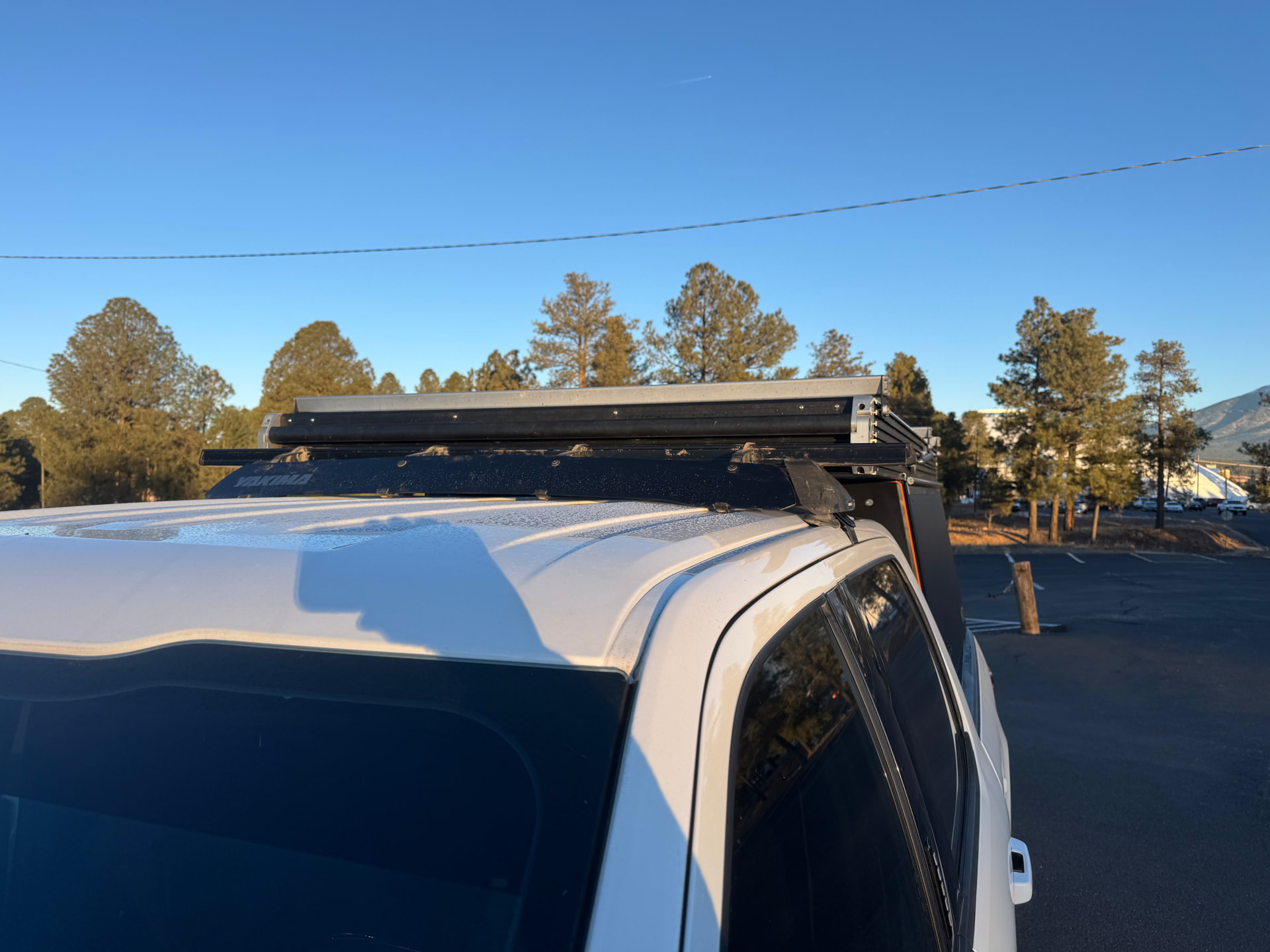

I was able to repurpose the Rhino Rack bars and a free Yakima wind fairing to make one.

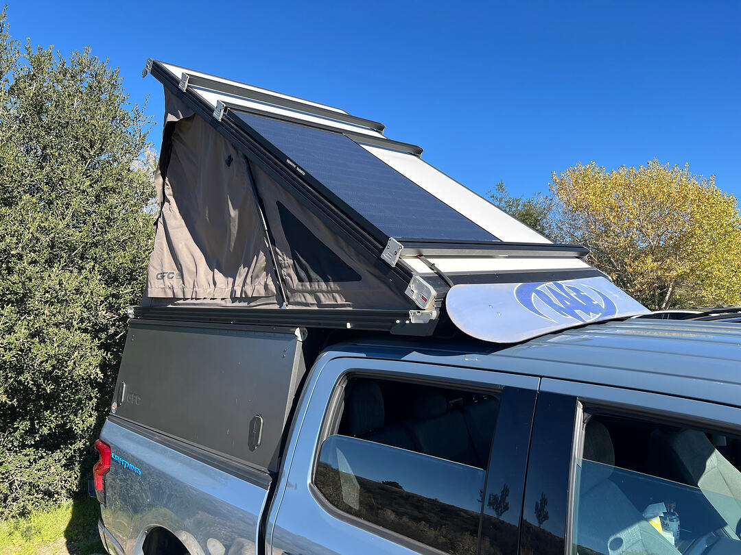

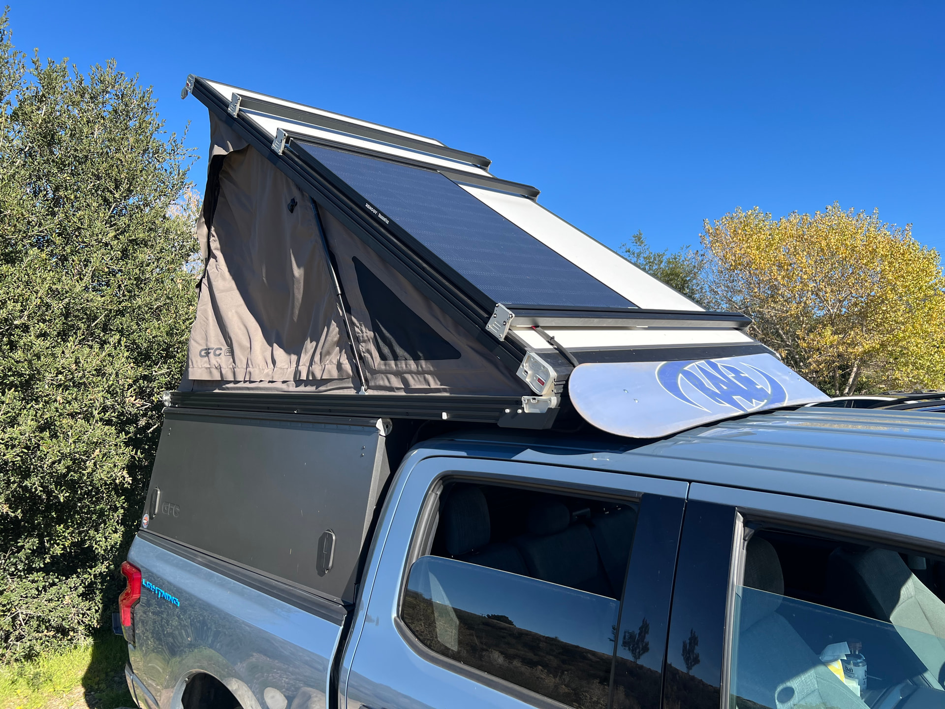

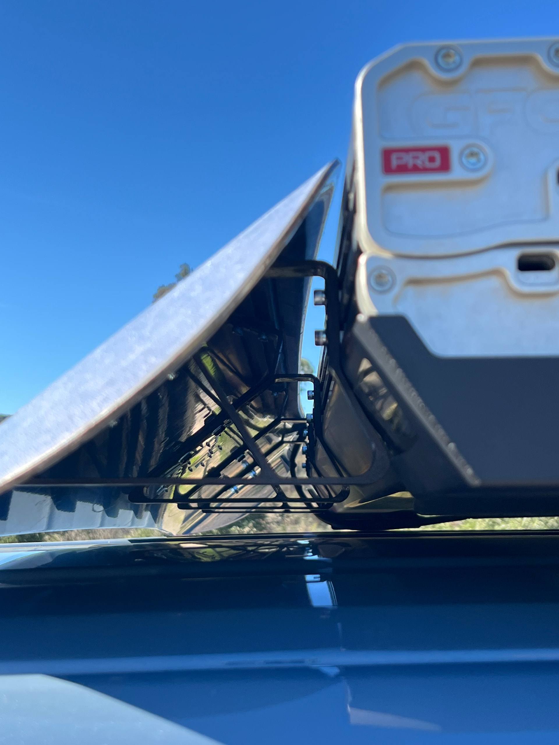

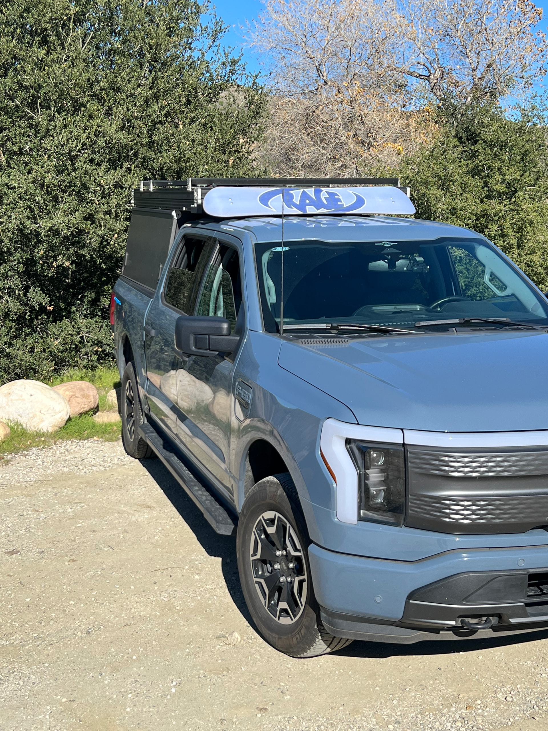

The wind noise and buffeting was very noticeable with the camper on and I lost around 10% in mileage. The snowboard as a wind deflector looked like a good idea so, I 3D printed some brackets and picked up a used snowboard that matched my truck’s color for $29 bucks.
After installing the board, the wind noise was reduced and the buffeting was gone. The profile of the board was a nice fit, it matched the truck roof line and the width. I guess I was lucky. What do you think?
Great job! Any plans to make your brackets available to the public?
I am thinking of making them and kitting the parts for a reasonable price, without the snowboard, of course. At the moment it fits well with my Ford Lightning.
