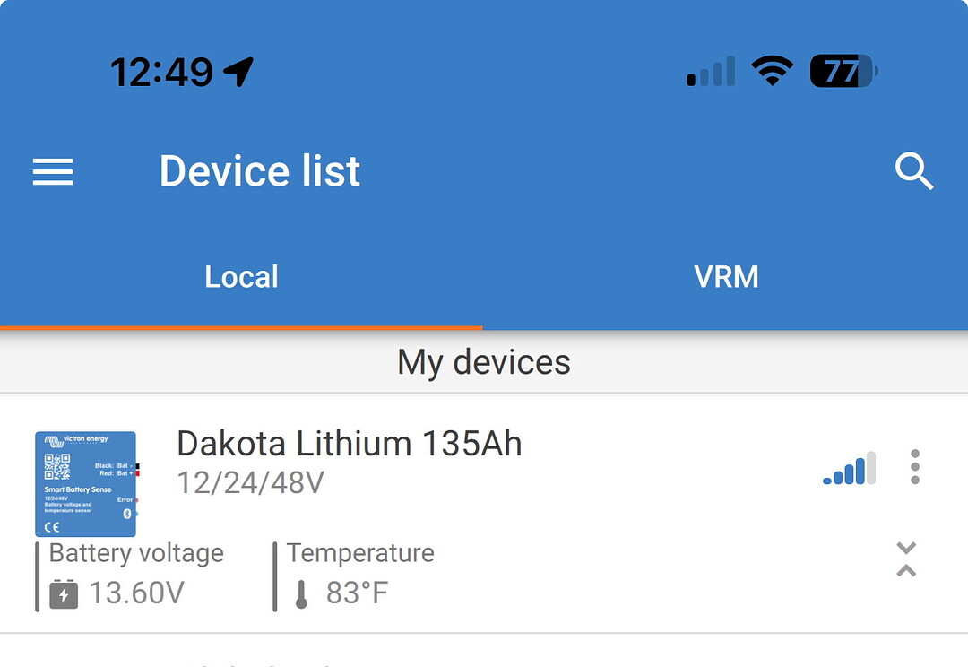

I pulled the trigger on swapping out my AGM House Battery for a LiFePO4 unit to power our Starlink dish along with all my existing systems (fridge, lights, 12v charging ports, etc.). This battery swap under the hood would allow me to nix all the Goal Zero branded stuff that has appeared on this thread and open up a bunch of space in the truck bed for the new buildout.
If you’ve been following this build thread since 2020, you might recall I was initially against the idea of running lithium (-anything) under the hood due to the lack of data on the long-term impact of engine bay temperatures on lithium battery health (and the fear of the battery catching fire).
Four years later, thanks to those living on the bleeding edge (e.g. see @takethetruck’s insightful write-up here) there’s now a solid base of real world reporting, and the data is clear: with high-quality components and the right safeguards in place, LiFePO4 under the hood is the future. My own data from running the system for 6-months backs this up.

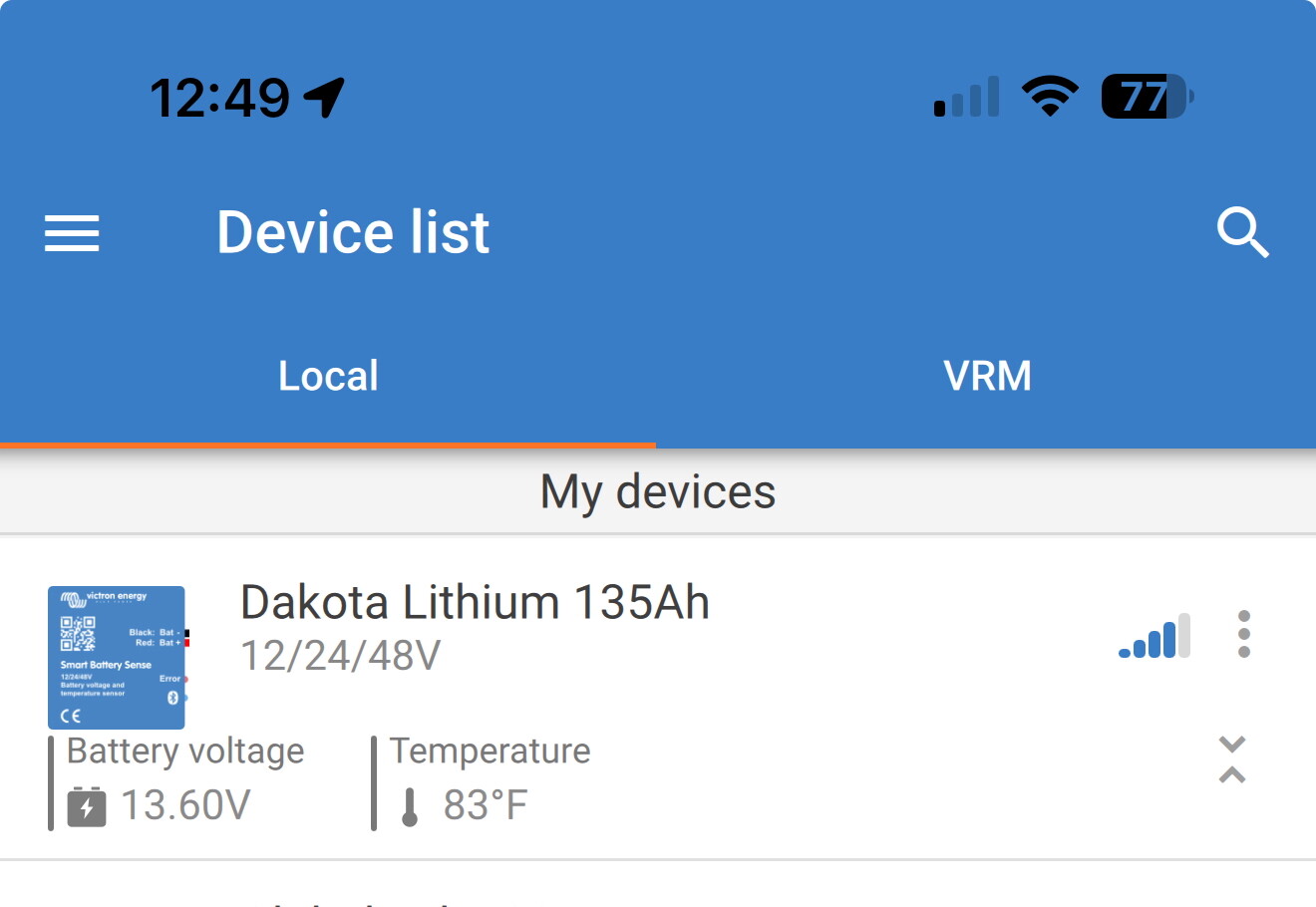

In addition to the battery’s built in BMS I mounted an external Victron Temperature Sensor and a Ruuvi Tag that would sound audible alarms on my phone if the temperature ever exceed safe operating temps.
After 180 days of data collection, I’ve seen that the engine bay maintains an average temperature range of 65°F to 95°F while driving thanks to the ample airflow. Temperatures do spike when the truck first comes to a stop but will gradually return to ambient air temps. The highest recorded temperature spike was around 130°F—still well below the BMS cutoff of 167°F—when coming to a stop in direct sunlight in the middle of the desert, where the ambient temperature was pushing ~120°F.
Screenshot 2024-10-26 at 12.38.19 PM
I’m really happy with this upgrade. Definition of a set-it-and-forget system and was plug-and-play with my existing REDARC + shore power charging systems. (See comms direct from REDARC + DL below)

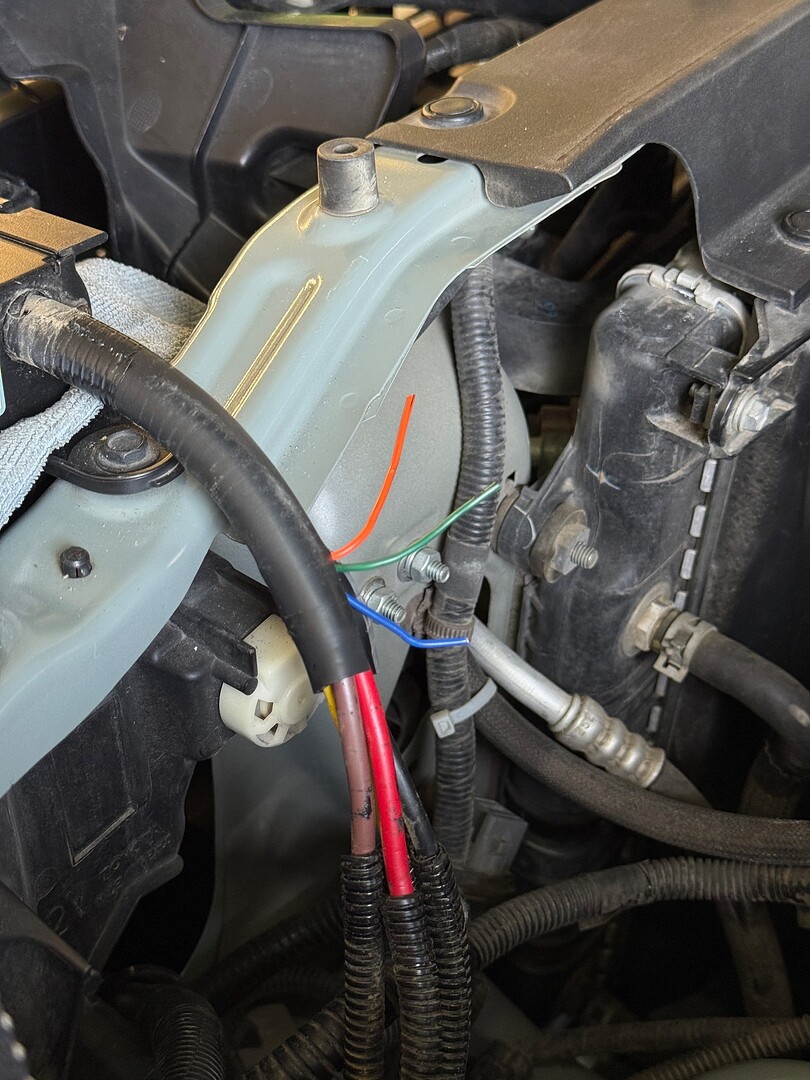

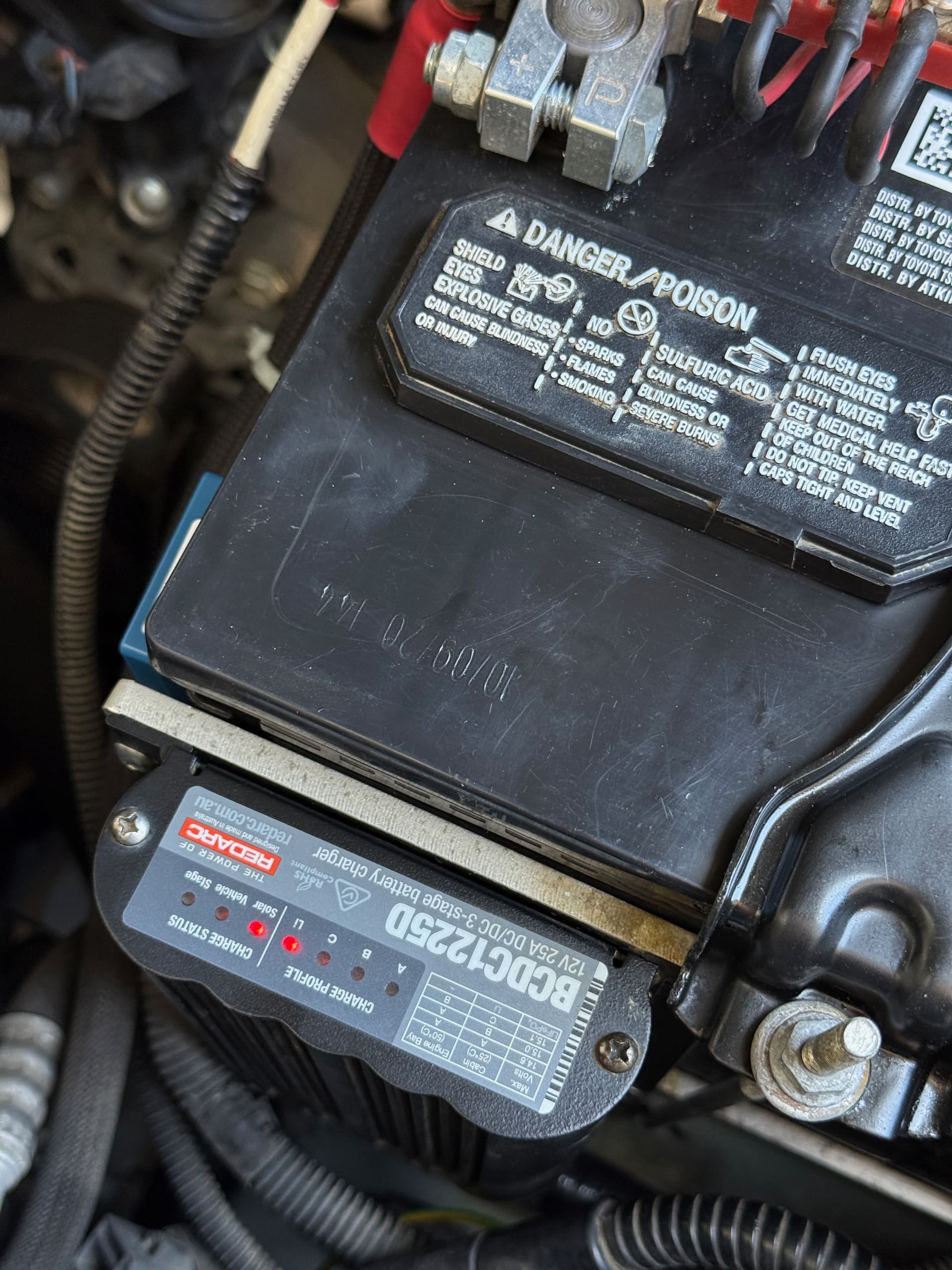

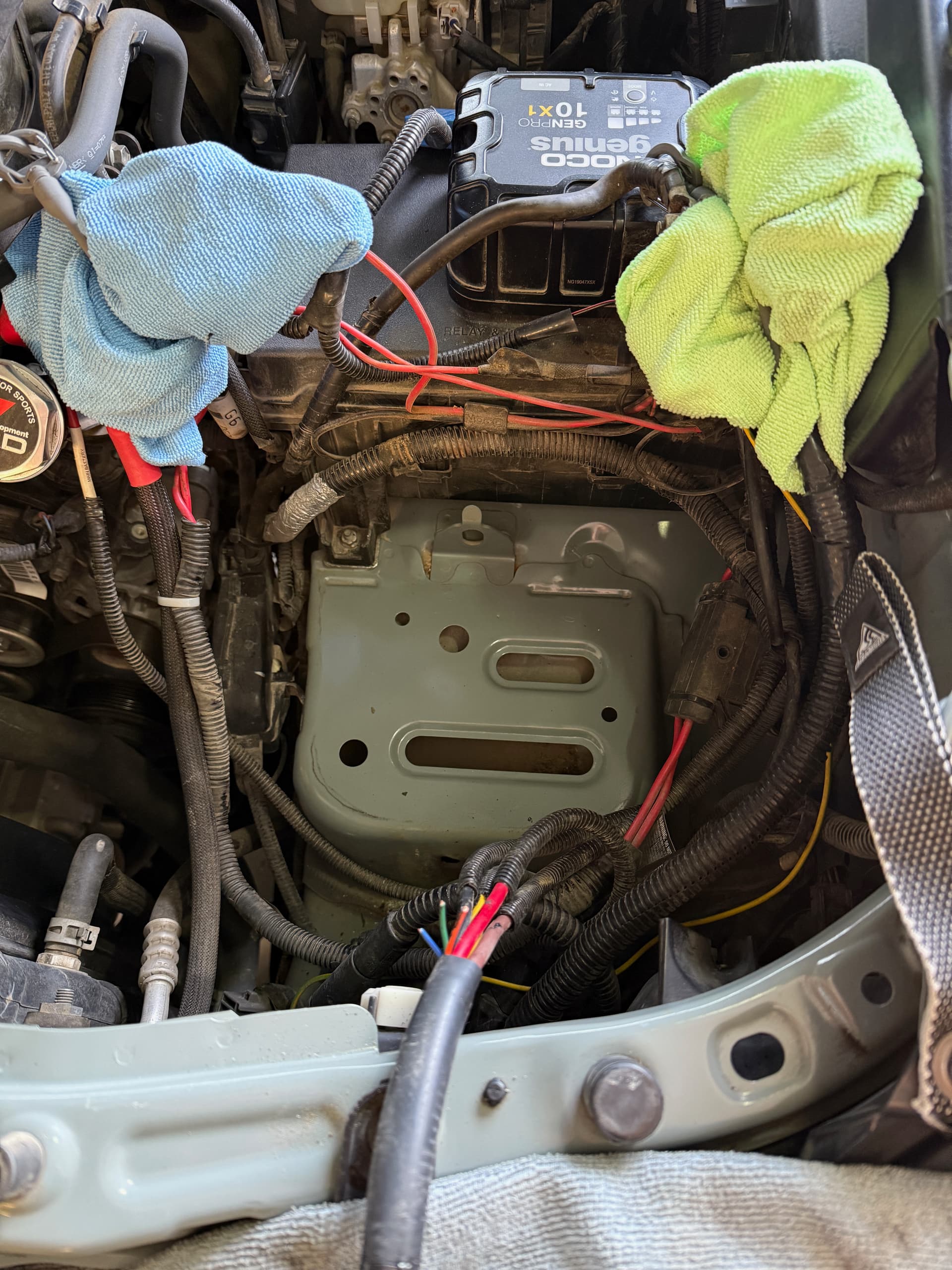

  1. Wiring REDARC BCDC to the accurate charging profile
I’ve been procrastinating on this one for 1 year. I dismantled my dc>dc charging system to get at the pesky little orange wire that needs to be crimped to the little green wire to update the charging profile from agm to lithium. Annoying project, but done. To date, the charger has only been charging my lithium battery to around ~80%. This was never a problem as I was not running a deficit in the system (solar, shore, alternator could keep up). Anyways… I’m now charging up to a full 13.6v (100%) as expected.

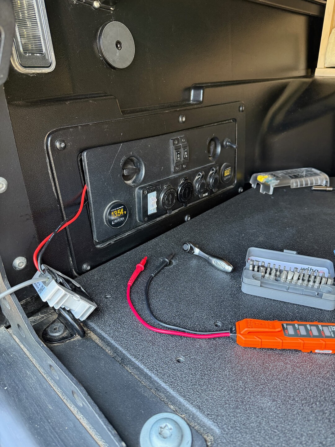

  1. Prepping for Starlink Mini :grimacing:
Starlink dropped refurbished Mini kits (At $349, msrp being $499) and I had a $300 work stipend burning a hole in my pocket so you know where this is going… I now own a Mini dish and I’m starting to play around with how I’ll hard wire and mount to the truck off DC power. Preliminary tests are looking good… draws 20w on average and does not experience voltage drop on my (very long) wire run. More on this later…
This means Gen 2 dish project is on hold. Going to hold onto it for time being, unless anyone here on the forum is interested in swooping a flat mounted and dc converted gen 2 dish at a fair price. Just DM me!

:satellite: Small Starlink Mini update
Another small update. I’m still messing around with voltage boosters before committing to permanently wiring and mounting the Starlink Mini. This lil’ guy that displays output is nifty (and only 15 bucks on amazon)
All for now! I’ll share a more in-depth update once I have a locked solution here.

I wired a switch for my BCDC Profile so I can switch from Li to the other profile when the temps are cold since the BCDC won’t charge under freezing temps. My batteries are self-heating so if their temp is okay I can toggle the switch. It was a suggestion from REDARC to help charge in colder temps.
I did the PCI Hardwire DC kit for mine and going to put a rocker switch inline to toggle on/off.
I think this would work for powering the mini: ChargeIT! Mini 100W USB Type C PD Charger - Coolgear
