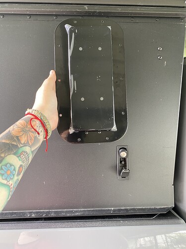

What truck do you have? I ordered one of these vents from the link and its pretty big. Looks double the size of what yall have. Just wonder if it looks so big cause I have a tacoma and maybe the GFC is not as tall? My vent is almost 12" tall.
My vent looks massive against my side panels lol
I got it on there… I used machine screws instead of rivets, #10x1/2”
One of the machine screws snapped while tightening. Not sure it was defective, but I didn’t tighten much when it broke. So I need to get another one. But other than that it’s on!
sorry for the late reply. The XL camper is a lot taller than a tacoma one so looks like it is a smaller vent. Looks like you got it dialed!
