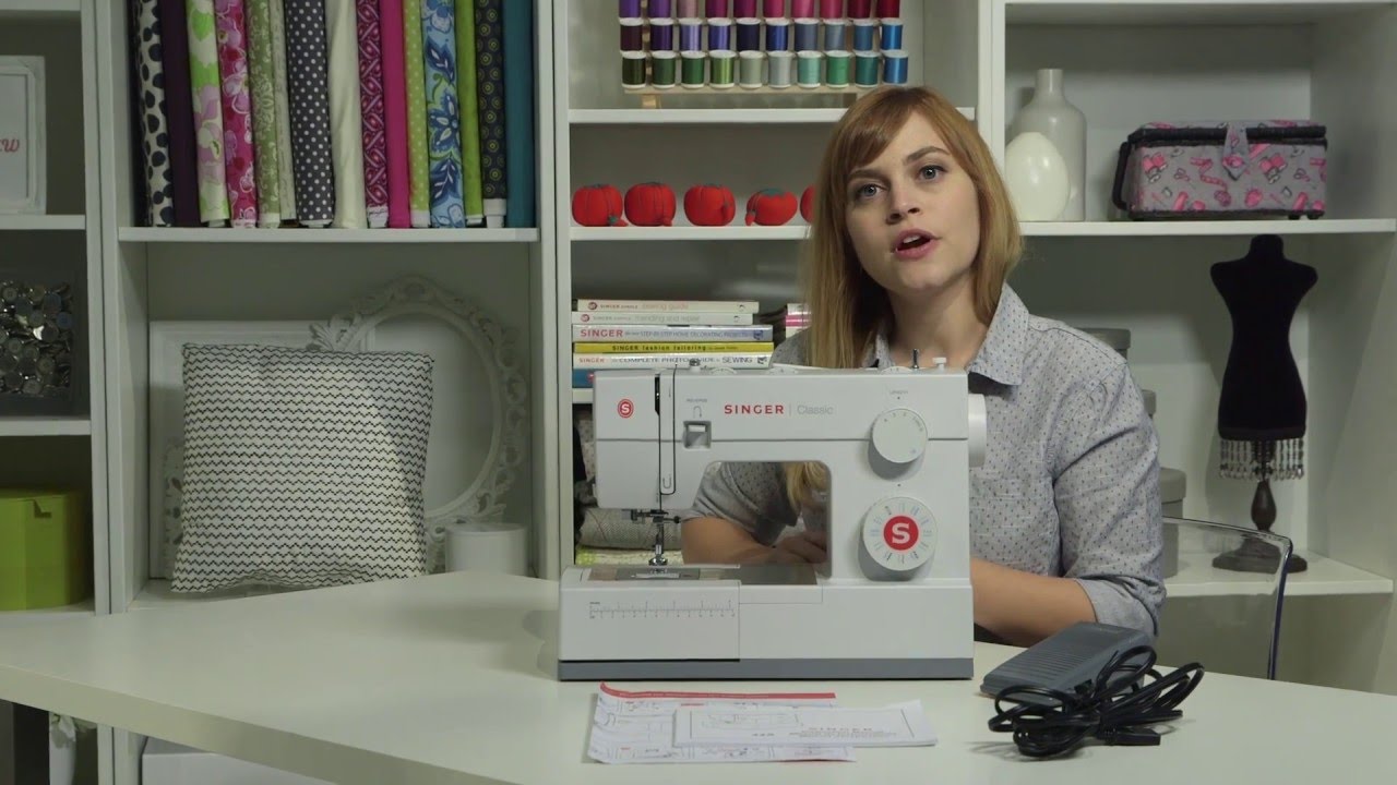

This is essentially the machine you bought. Should help you advance your skills a bit, but there is no better way to start then jumping off the deep end the way you did. Really looking forward to seeing what you end with.
