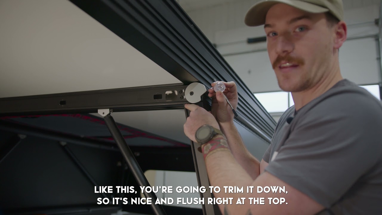

Are there going to be some sort of instructions on what to do with these kits once we get them?

I wanted to give everyone an update: all Weatherization kits have been received by UPS. So if you did not receive a shipping confirmation, please submit a Service Request Form.
The Weatherization kit was designed around the tent section of the camper. A few of you have seen water intrusion around the lower section of the camper (anything below the tent floor), so we designed a kit for that area of the camper as well. With that said, the lower section kit is only applicable for those that have actually had an issue in such an area.
Tent Section:
Lower Section:
If you do not feel comfortable installing the kit yourself, then please let us know and we can get you scheduled at our facility in Belgrade.
@Roddy1 Yes, everyone that receives a kit will also have written instructions in addition to the videos noted above.
