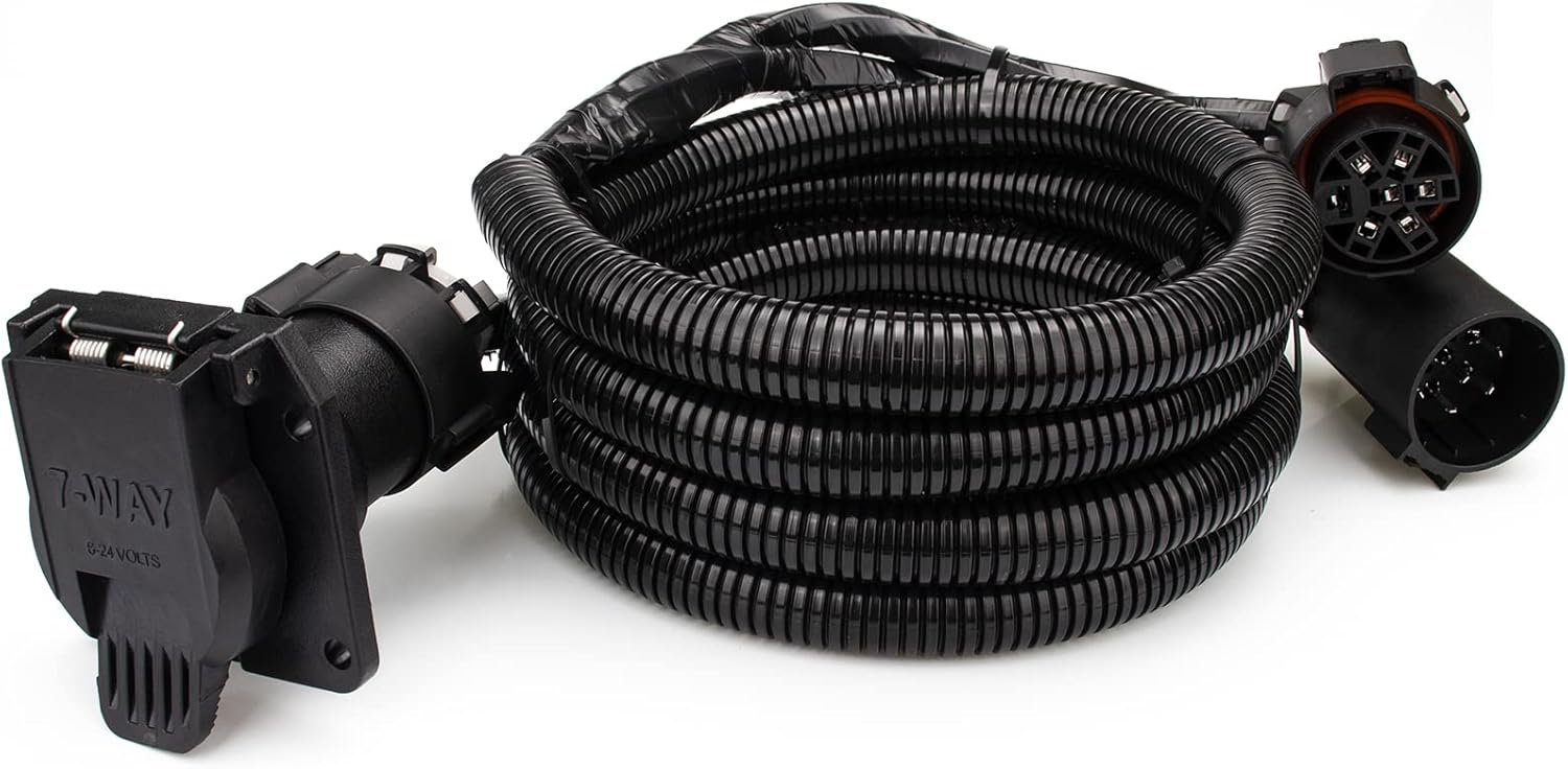

Built and wired in some DC power into my truck bed to power my fridge or any 12V accessory and charge phones or any USB accessory. Just tapped into the 7 pin trailer harness for constant 30 amp fused 12V power with the harness extension below to wire to the Accessory panel. The box was an extra electronic project box I had laying around. I may mount the panel direct to the side wall of the truck bed, but I was trying to avoid cutting into the bed.
LEQUDUO 56070 7-Foot 7-Pin Trailer Wiring Harness Extension

Excellent! Ordered ![]()
Nice! Are you having any issues with your fridge powering off?
No issues with the fridge powering off. I wired it to constant 12V power so I’m good unless my battery dies. For multi day trips I’m powering it off a Bluetti EB70S power station so I preserve the truck battery. I just wanted the option to power it in the bed for shorter trips.

Nice! Good idea. I was having issues with 12V power from the engine bay, fridge would shut off. I assume it was due to the gauge wire. I purchased the ARB fridge harness, which is 8 gauge wire, it works perfect now.

I bet that’s true with smaller gauge wire. The trailer wires are pretty beefy and fused at 30Amps. I’ll have to look again, but it may be 8 AWG so maybe I got lucky
Not sure about the ARB fridge, but my Iceco has 3 battery voltage shut-off levels I can select. It’s currently set for the highest level. Complete disclosure…I haven’t tried the fridge powered here for longer than a few minutes so I’ll definitely keep my eyes open to see if it has any issues now that you’ve said this.
Gotcha! Yeah, run it for a bit. I also have the battery shut off levels and keep it at the highest. I want to get a dual battery setup so I can just leave it plugged in with no worries. Right now, once I park, I switch to the jackery.

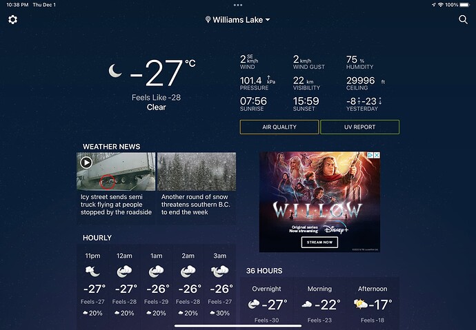

Now I just need to mount them on the truck…but um…it’s currently….
Just change the settings to F* and it’ll feel a bit warmer…. Mind over matter!
